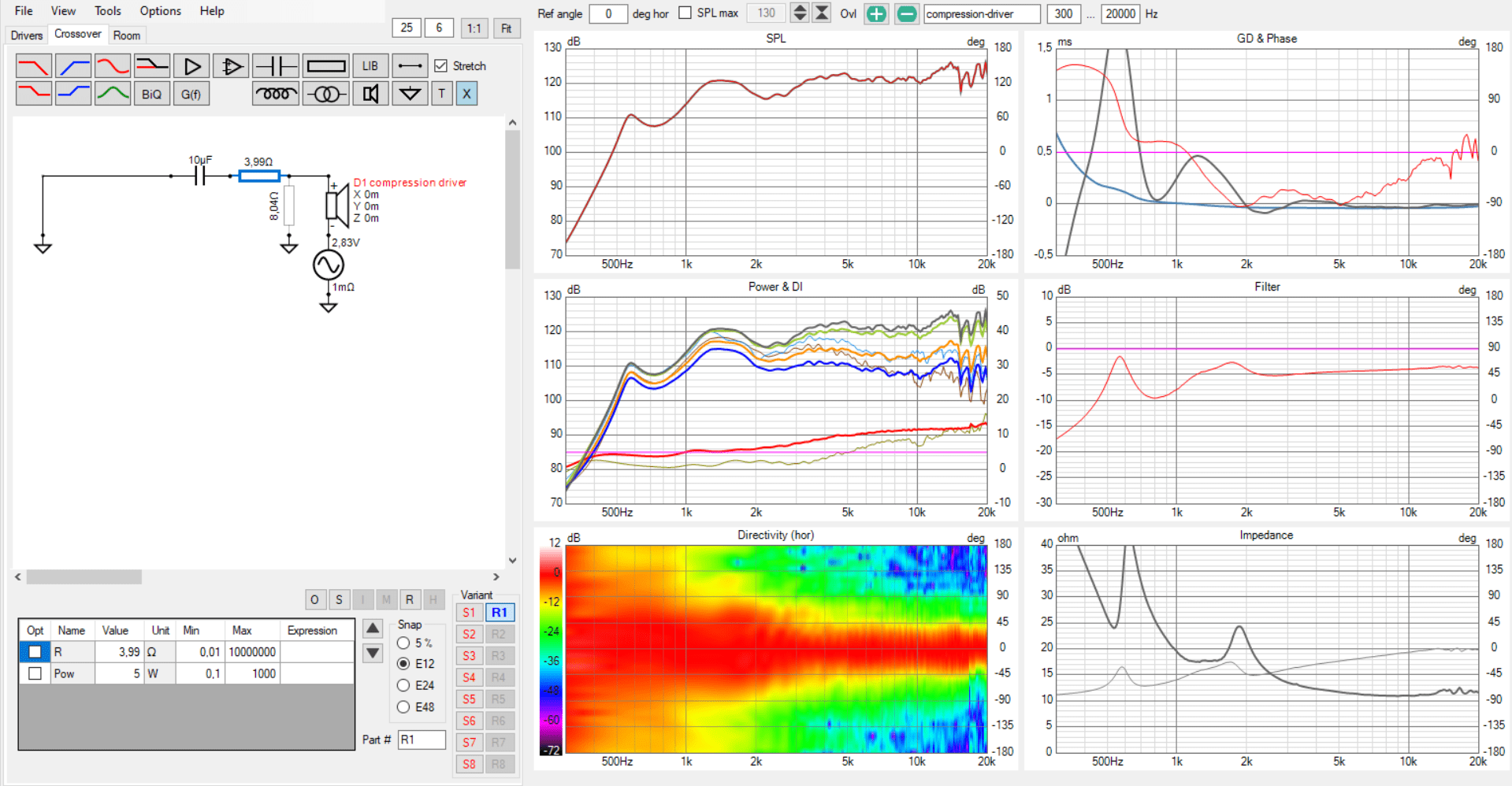

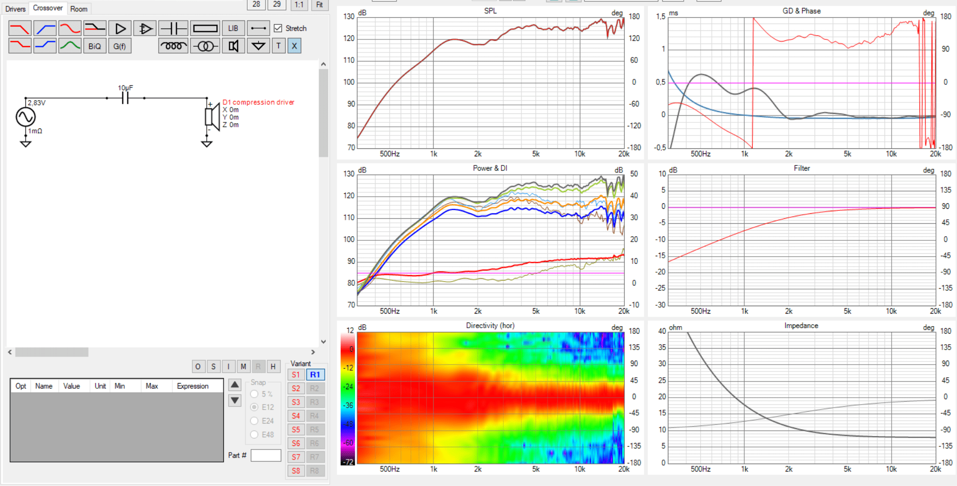

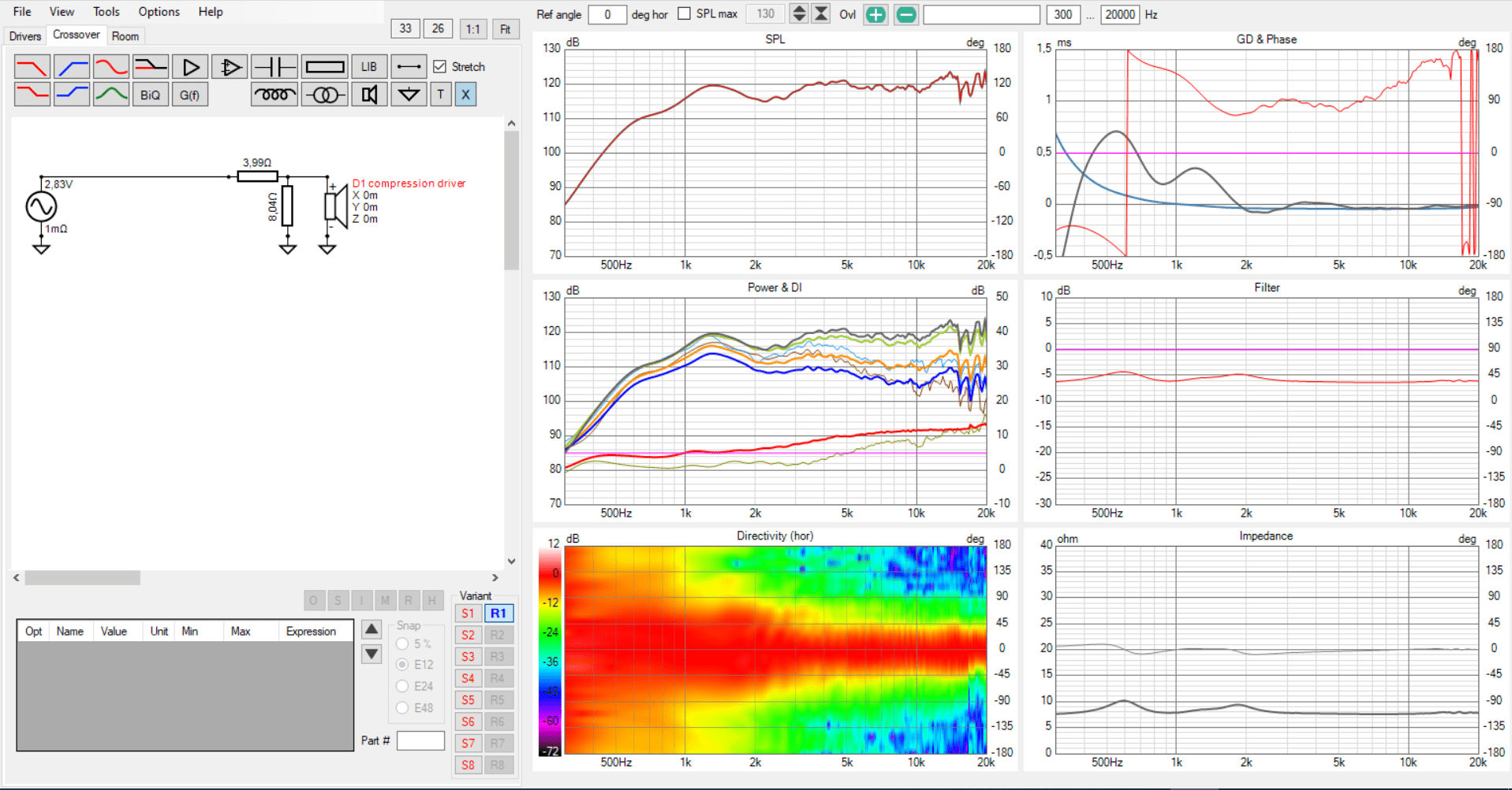

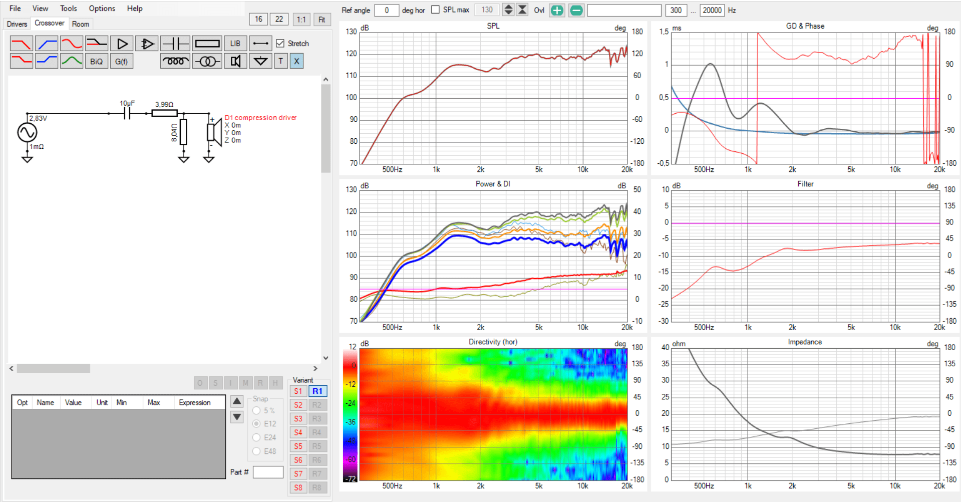

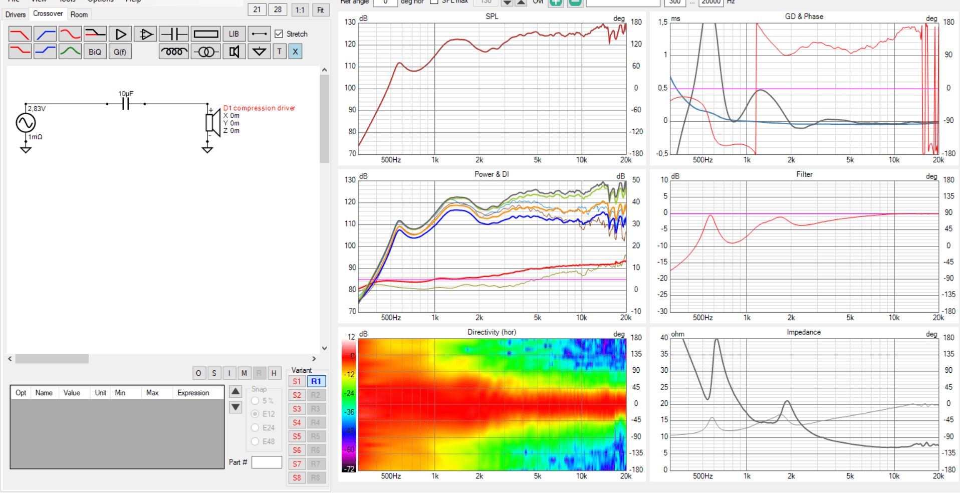

^^ Oh alright, thinking what it means in practice, would following thought be about right? if I look at free air impedance plot of a driver, the peak(s) show the driver resonance, and basically we'd need some impedance between driver terminals that damps this, lowers the impedance peak? What the capacitor interaction means, is it just that the driver now resonates freely as there is no "damping" due to capacitor, high impedance between the terminals?
Few quick sims to aid. Flat impedance and measured impedance loaded in, interaction visible yes.
Then with l-pad and some variations to see what happens with the impedance peaks, interaction. It seems that as long as there is the shunt, impedance parallel to driver the impedance peaks get lessened, as seen as amplifier load?
edit. trick from Purifi paper, how to see impedance what the driver sees back to amplifier by placing the source series with the driver (in VituixCAD). Shunt resistor on the L-pad makes lower impedance for the driver, the driver resonance is damped with the resistor providing lower impedance path to transfer the resonance to heat, right? the cap interaction reduces, which is not basically the capacitor that affects the driver itself, it just prevents damping happening on the amplifier output and the driver resonates naturally longer. Is this train of thought correct?
