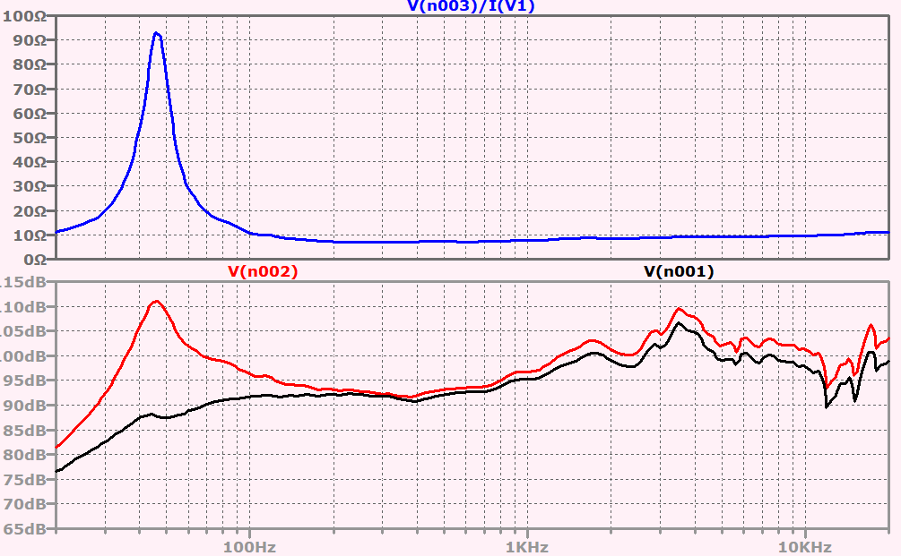

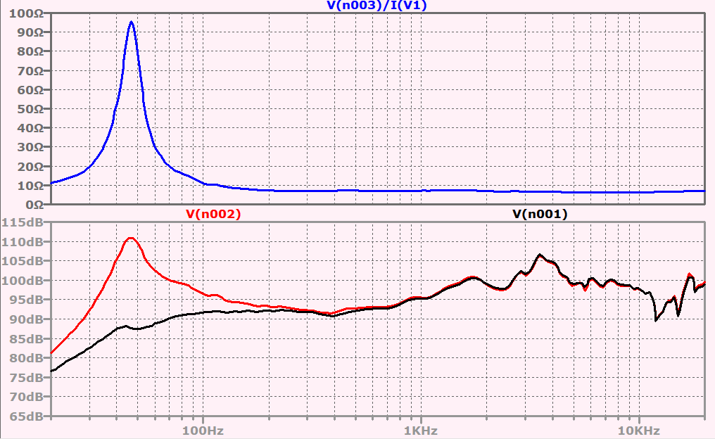

I have fired up LTSpice and the simulation works super well.
It immediately brings up a very major problem with a constant current source.
The frequency response, or rather output power at a give frequency, is now directly proportional to the impedance.
(a constant voltage source doesn't have this issue)
So this means that the freq resp will be super heavily dependent on how stable the impedance is.
Even a slight difference in impedance, will change the freq resp drastically.
If we just only look at if from above Fs, this means you either have to use a speaker with a very stable Le(x), and/or really have to make sure that there won't be any cone excursion at all.
Which leads to another problem, that is when the voice coil heats up and therefor raises Re.
It's also very problematic with ANY other nonlinear (cabinet) resonances or other issues that reflect back to the impedance.
Or any other tolerances in like components (crossover filters, resistors, capacitors, inductors).
So to very quickly debunk the idea of "why nobody is doing this, it is perfect".
This makes implementing a loudspeaker system extremely complicated even from a practical point of view.
A constant voltage source does makes an awful more sense here, its so much more robust from a practical sense.

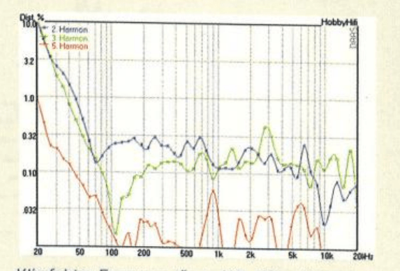

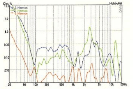

It does makes me wonder something else.
Something I noticed after looking at distortion plots for some many years.
I have noticed that often (but not always), the distortion with 8 ohm woofers is lower than the 4 ohm variant at the same SPL.
Here is a good example with a Dayton RS225 4ohm vs 8ohm @ 90dB
With the same magnet structure, it's a little hard to compare, since they have to wind the voice coil one a different way.
So therefore the parameters change a bit.
But an obvious difference is the inductance @ 1kHz, which is 0.49mH for the 4ohm version and 0.86mH for the 8 ohm version.
Look at that peak around 2900Hz completely disappearing!
If motor is same and only winding was different, higher impedance means more turns, perhaps different wire. Assuming it is just more turns it must fit into the same gap and former so I'd imagine the winding must be longer or something, or perhaps its height is same but the other is somehow more loosely wound. Assuming it was mostly the Le(x) making difference in distortion, so likely Le(x) curve would look different for both. I really have no clue 😀 Perhaps Le(x) is maintained but it's proportionally more with the 4ohm version making more variance to it, more distortion in general.
Higher impedance version there is longer wire in the gap, so more force with same current?
What ever it is, I could think that there is some trend as you have observed. Perhaps manufacturers want to have frequency response similar between the two models, and to keep that something else must give and it might be that the distortion performance is "sacrificed" for it, or something. Well, just speculating.

Even if we don't use it with a speaker, the output now all of a sudden depends on the impedance (resistance) of the load.
This is also the reason why a constant current source doesn't work around Fs, because the impedance is super high, resulting in a huge peak at the frequency response.
(red = CC, black = CV)
This is also exactly described in other sources like Voice Coil Magazine.
see: https://audioxpress.com/article/current-driving-of-loudspeakers-book-review
So as soon as the impedance changes (look at impedance graph), the frequency response will change with it.
