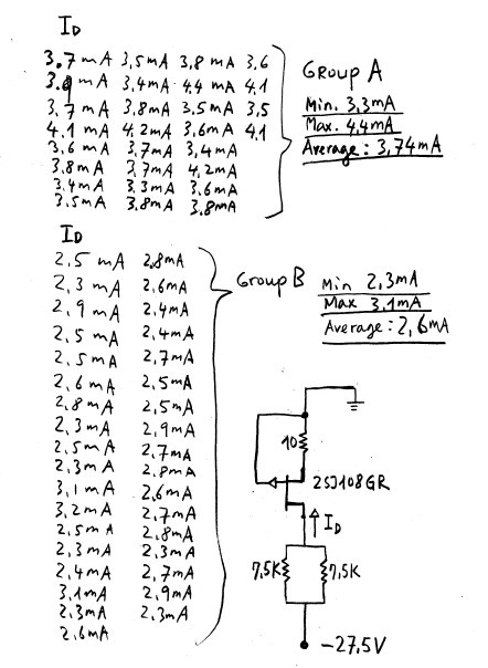

It's still unbelievable! I could't figure it out. It is true that
0.129V across 10ohms means 12.9mA through it, isn't it?
But, through 2SJ108GR classified with Idss ~2.6mA-6.5mA.
And, the bench test showed me 4.5mA with the 10ohm-Rs . . .
To be sure for my bench test results, I again measured Id of
63 pcs of 2SJ108GR tonight. The mesurement set-up is sketched
in the attachment. Yeah . . . all of them apparently show Id values
lower than 4.4mA.
As far as I understand, the jfet is a variable resistor which is
controlled by three voltages--Vgd, Vds, and Vgs--because
they build up the depletion regions in the p-channel (or n-channel).
Most probably, the current source (J310) connected to the
2SL108GR is forcing the depletion region thinner? So, the Rds is
forcefully reduced causing the increased current through
2SJ108GR? Still scratching my stone head . . .

Babowana said:To be sure for my bench test results, I again measured Id of
lower than 4.4mA.
Anyhow, the amp pumps up the nice music.

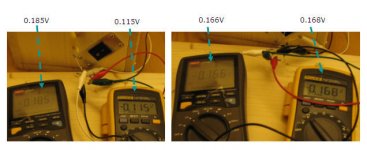

Babowana said:Papa, is this kinda ghost effect?
No, no ghost.
I had a kirchhoff's rule test tonight.
I made J310 (N-ch) as kind of a current source.
And, I made 2SJ108GR (P-ch) as kind of a resistor.
I picked up one 2SJ108GR (tested Id at 2.2mA) from Group B
in post#206. And, had the kirchhoff's rule test.
The attached picture shows that two different tests were
following the rules. FLUKE shows measured voltages across
Rs of 10 ohms of 2SJ108GR -- 0.115V (11.5mA) and 0.168V (16.8mA).
Now I understand why the 2SJ108GR having low Idss
could have more current inside the amp. Hmm . . .

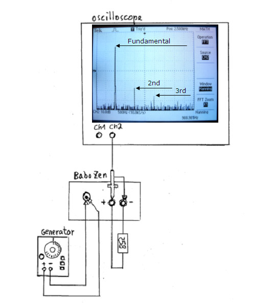

Zen Mod said:
Yeah, team and harmony . . . should be always good.
BTW, measured FFT (Fast Fourier Transform) to see the frequency spectrum with the fundamental frequency of 1kHz at 26V pk-pk output. The fundamental frequency was measured as about 65dB, the 2nd harmonic about 22dB (0.7%) and the 3rd about 16dB (0.35%). The amp was looked having quite second harmonics at all different output levels ^^.
And, had another measurement -- clipping point. The symmetric clipping was starting from the point of about 34V pk-pk output ^^.
