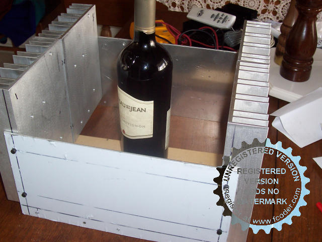

OOGAH!!! OOGAH!!!Looks like BABOZEN begins with a toast!!Just a suggestion for the sinks I sent to you. Of course, you'd probably prefer a Chianti.
Ahr . . . I don't know about different wines.
I just like drinking dry red wines, not sweet, of any name.
