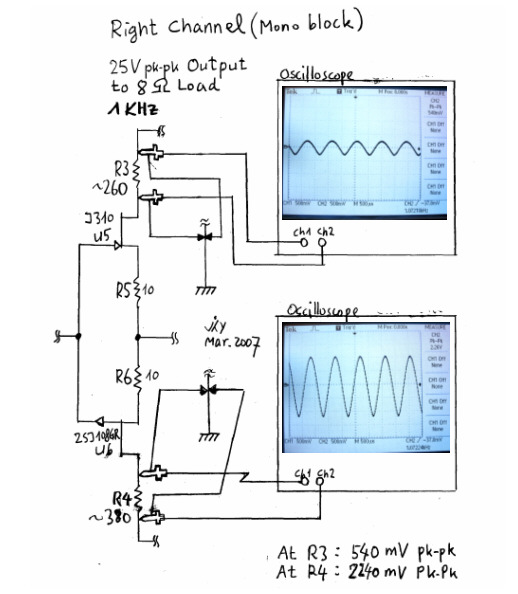

At amp's work with 25V pk-pk output to the 8 ohm load, I
measured differential ac voltage swing at R3 and R4. Actually, R3
and R4 are trimming pots. But, I roughly calculated adjusted and
fixed values as R3 of about 260 ohms and R4 of about 380 ohms.
Measurement results are 520mV pk-pk at R3 and 2000mV pk-pk
at R4. This means that R3 has less ac voltage swing than R4. If I
calculate these voltages to swinging current, R3 has 2mA pk-pk
hile R4 has 5.3mA pk-pk.
Interesting!
Due to these unbalanced ac current swings between R3 and R4,
the complementary power fets also amplify different ac currents.
As a result, the upper p-ch fet works like an Aleph CCS -- i.e. as
an active current source! And, the lower n-ch fet works like a
single ended amplifier.
Really, an intersting finding. I hope I am correctly understanding
the reason why it works like this babo ^^. But, a good sounding
babo ^^.

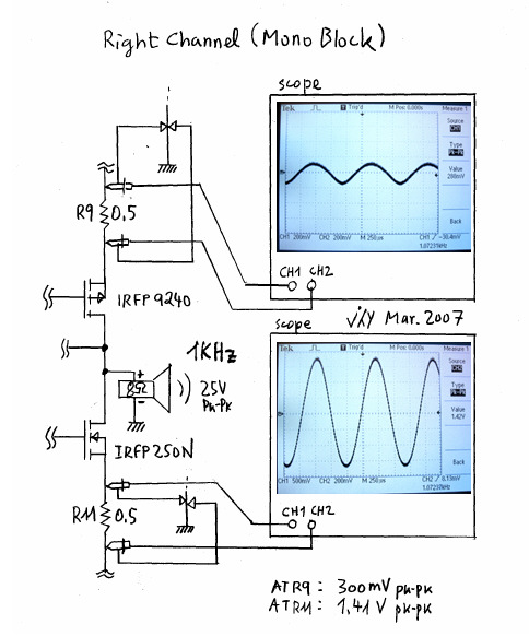

Babowana said:Here is another measurement from R-ch block.
The current swing at R9 is 0.6A pk-pk
while the swing at R11 is 2.82A pk-pk.
So, my Babo Zen is working similar as SE.
Steen, are you ready to drop ya jaw down to ya foot?
you made Aleph

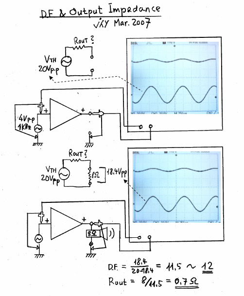

I find damping factor about 12 with 8 ohm load.
Output impedance is about 0.7 ohms.

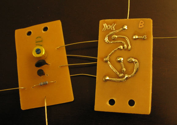

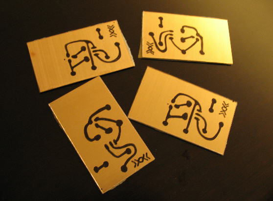

I replaced the two breadboards pictured in post #189 with my own PCB. My own PCB? Yes, my first try after my birth to this beutiful world. Last time, when I was measuring the oscilloscope responses, once I mishandled the probes and saw some of smoke from one of these beadboards. After the probes having been removed, I found that the amp was still working normal. But, I felt as if I were keeping the aching tooth. This was why I wanted to replace them with new boards and new components--but this time with diy PCB.
I cut the copper-clad board to the sizes, using the snap-off blade knife. On the copper side, I made the drawing of black wires with oil pen. Art work? No, not really. This was just a baby who stood up for the fist time. ^^
Before I leave this thread alone, few more things . . .
And, I put the boards into a plastic bowl with some of white cristals of Ammonium Persulfate, then added warm water of about 6-fold amount of Ammonium Persulfate. About fifteen mins. later, I put the boards out of the bowl and washed off them clean. It seemed that I kept the boards in the bowl too long. I found that the left copper layer was looking thinner than I expected.
Hmm . . . the copper layer looked really thin so that I applied solders on it all the way before I made the 1mm through-holes. Then, I inserted components through the holes and soldered them all. Done! It was so easy. It took less than three hours for all.
By the way, This time, I picked up two "smaller" 2SJ108GRs having Idss of merely 5.45mA. Sure of 5.45mA? Sure. Nevetheless, the amp returned back to the same work as previous. No joke! WoaHahahahahaha . . . ^^
