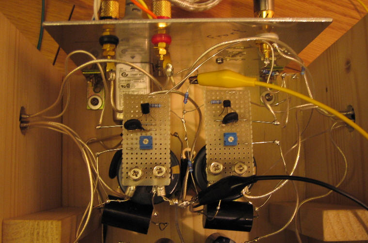

Long story short.
My ZV5 with jfet inputs is playing music.
"Sweet Heart Like You", Guy Davis, in the clean dish mmm. . .
tastes good heehee . . . ^^.

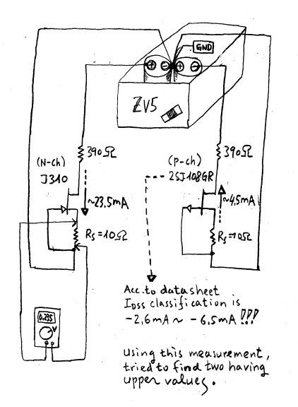

The picture shows the single turn trim pots.
The next black ones are thermistors of 10 ohm/3A.
The second next smaller blacks are J310 and 2SJ108GR.
When I tested J310 with 10ohm Rs, the current was about
23.5mA. Comparably, the current through 2SJ108GR was about
4.5mA at the same test condition. Really odd complementary.
But, surprisingly, they well co-operate.
The adjustment of bias and the output offset was very easy.
The output offset sits down to the stable place very quick.
Quite different from the original ZV5 with this.
Thanks again, Papa ^^.

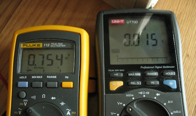

Few changes. R9 and R11 increased from 0.47 to 0.5 ohms.
I changed this not for sonical improvement, but to see the bias
current without any caculator. If I see 0.75V, the bias is 1.5A.
And, these resistors are wire-wound 5W grade.
When I adusted the bias with rhe single turn trimmers of R3
and R4, first I did not connect R9 and R11, i.e. they were open,
This was not to meet any trouble which could be possible with
excessive voltages across R3 and R4 even before any start of
adjustment. With R9 and R11 open, I adjusted R3 and R4 near
to 4V across them. Then, I soldered R9 and R11 for the final
adjustment of bias at 1.5A and the output offset at near zero.
And, I used two digital multi-testers to read the bais and the
offset at the same time.

To have a look at the measured bias and the output offset,
here is a shot. Figures staying calm . . .
