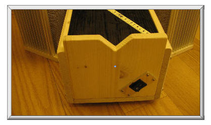

Babowana said:
After all wire arrangement, tested the sound,
got wonderful sound,
and wanted to finish this project,
completing the housing of the PSU body.

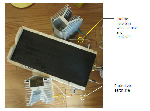

Zen Mod said:. . . in that case wires can be shorter . . .
Actually, there is a detachable lifeline formed by five wires
between the heat sink and the wooden box - this was my
real concern.
Five wires are:
1 input wire to the gain mosfet gate
2 output wire from the gain mosfet drain
3 preregulated wire to the regulator mosfet drain
4 reference voltage wire to the regulator mosfet gate
5 regulated voltage wire from the regulator source
And, these five are tightly braided together forming the lifeline
(about 20 cm length).
So, I was worrying about unwanted high frequency oscillations
which could be possible due to the following causes:
1 capacitive and magnetic coupling from the output to the input
2 load lead inductance feedback from the power line to the circuit
My worrying was just a worrying, with luck of no such oscillation 🙂
By the way, the five wires should have been six including one
more wire, which should have been a protective earth line from
the heat sink to the protective earth point. But, my ill plan forgot
it. Therefore, I am using a separated wire having snakehead clip
at each end. One head is biting the heat sink while the other
biting the protective earth point.
Any comment or advice? Tks

you know that I'm always full of-with advices
just make whole mess as I draw , make holes ditto between heatsinks and box,put wires already soldered to mosfets on sinks through holes and solder inside.
htsnks can be grounded on screw heads inside of box.
biggest work must be dislocating of in-out connectors from present back to present top plate
anyway- your decision is final

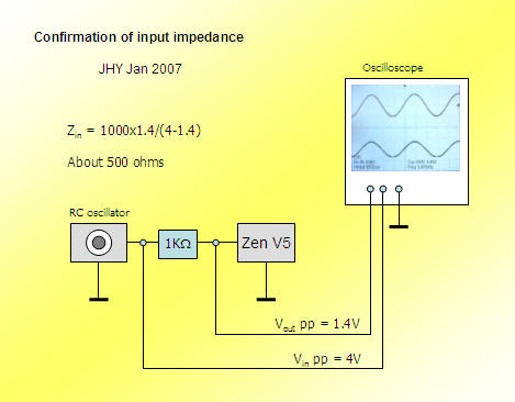

Confirmation of input impedance
I have assumed that R1 is considered as the input impedance
if I assume the node just behind R1 as a virtual ground.
I have R1 of 500 (1K//1K).
I measured the input impedance of about 500.
I think my assumption was reasonable. Right?

seems all right
usuall way of measuring this is to use pot instead 1k ,and when you have same voltages across pot and input of stage , you can measure exact res of pot and then you know input resistance.
anyway,both ways are equally good

Zen Mod said:usuall way of measuring this is to use pot instead 1k
Why I didn't think about it?
Thanks, Choky, from a babo.
It is a great fun in confirming my assumption
one by one. I learn and get self-confidence.

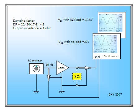

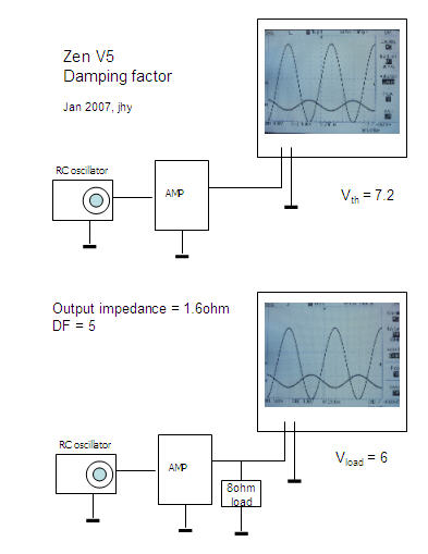

Last time I measured the damping factor of 5.
But, when I measured it again, I got 8.
Why measured again?
Because last time I measured it at too high frequency.
So, I wanted re-measurement at 50Hz.
On 50Hz signal
DF = 8 (8 ohm load)
Output impedance = 1 ohm
The original article says, DF of 4 . . .
Where I am wrong?

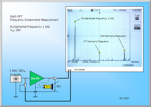

Math FFT frequency component (spectrum) measurement
Okay, I took this measurement.
Not to get the distortion figures, but just to have a look.
Why . . . ? Of course, for fun.
The fundamental frequency was 1 kHz of 20V(peaktopeak)
at the output to the 8 ohm load (about 6W). From this test,
my ZV5 shows both 2nd and 3rd harmonics. I guess that
if the power is varying, the portions of the 2nd and 3rd
harmonics would be also various.
If you find out any mistake in my measurement set-up,
I would much appreciate your comment.
