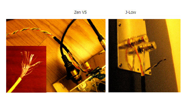

I have tried four different speaker cables between ZV5 and J-Low:
- Furutech (Japanese brand) (High-price)
- DAXX flat type (Papa’s country brand)
- Audioplus (Babo’s country brand) (Mid-price)
- My DIY cable (Economic-price)
I hear that my DIY cable is very fine, particularly in high frequencies - no grain, very smooth and silky. I made it with silver-plated and Teflon-insulated copper wires (net 1mm diameter), which I bought in local market place selling marginal left-over industrial pieces at cheap price. I just twisted six wires for one cable of 3m length, and used two for + connection and two for – connection. The remaining two wires do not connect the amp and speaker, i.e. one end is open on speaker side while the other end is connected to the earth in ZV5 (not signal ground). The attached picture might explain better. From the picture, if you find out one small bulldog clip, that point is where the earth connection is made by the clip.
My DIY cable pushes away the other three, in sound.
No logic, no theory, just for fun . . . 🙂

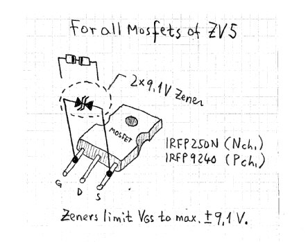

A real question
In the neighbouring threads, Papa sharpens his words about the strange behaviors of IR P-ch MOSFET. As I used IRFP9240 (with IR N-ch IRFP250N) for my Zen V5, I was trying to hear any strange behavior with my ears. But, I couldn't . . .
I couldn't hear it . . . due to the Source resistors and NF?
By the way . . .
By mistake, changing interconnect cables between my pre and Zen V5 careless, I punched one mono block of Zen V5 to death with a spark of high Vgs. I had to renew all MOSFETs. And, this time I added the protecting back-to-back 9.1V zener diodes across G and S.
After the repairing, I found all work fine, listening to ZZ Top . . .

Babowana said:
. . . added the protecting back-to-back 9.1V zener diodes across G and S.
Nothing new here . . .
All of you might already know this . . .
I just want to inform you once again . . .
To confirm that Zen V5 accepts this . . .
I added this for all MOSFETs of the amp and the PSU . . .
And, I highly recommend this to whom building ZV5 . . .

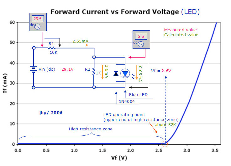

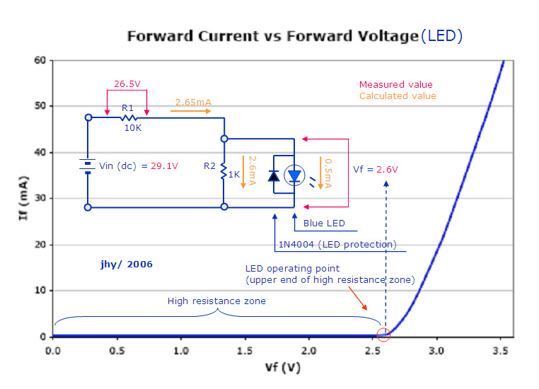

Digging blue LED
Blue LED is a fashion
But I have two things to think about
ZV5 has large caps
Power-off doesn't kill the blue LED light right away
The light still stays long
The blue color too bright, giving cold feeling
I want somewhat dim blue
Many altenative solutions must exist around
Hehe, I borrow Papa's method in F1 😎
And, I look into LED datasheet
Hmm . . . Mmm . . . okay . . .
Now, the brigtness is acceptable
Power-off kills the gently glowing blue right away
You see . . . ?
Details attached
R2 becomes variable depending on Vin and choice of R2
Babowana said:
You see . . . ?
Details attached
Oops . . . misprint at post #114
It should have been like this:
"R2 becomes variable depending on Vin and choice of R1"
In addition another mispring in the attached drawing.
The LED current value corrected
:wave2:
