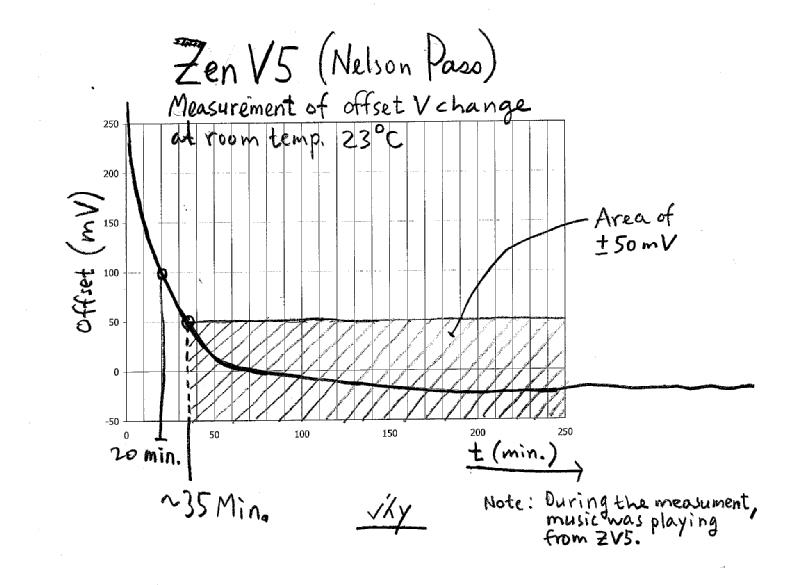

Output Offset Voltage above the Ground
I tried to adjust the offset voltage to about 0V when the heat sinks are heated up enough, i.e. when the temperature change in heat sinks stops (saturated) and stays around zero.
By the way, since I am using unmatched complementary pairs of IRFP9240 and IRFP250N having quite different transconductance characters at room temperature, I read high output offset voltage when I just turn on the power. And, along the time length, I observe that the offset voltage reduces little by little to the final value I adjusted. It takes time. As an example, my measurement of the offset voltage change in the condition of 23 deg C room temperature shows the following figures:
Power on and
2 min later: 200mV
10 min later: 150mV
20 min later: 100mV
35 min later: 50mV
1 hour later: 5mV
3 hours later: -20mV
And, the offset continuously drifts inbetween -20 and -30mV
Both amps (two mono blocks) behave similar.
Therefore, I could say that it takes about half an hour for the amps to reach their normal operating condition within +/-50mV output offset range.
Not bad, isn’t it . . . ?

like Papa sez numerous (?) times ,do not worry if your DIY amp have even 500mV from cold ......if I count on few crumbs I picked-somebody can be surprised if try to measure DC offset of even Pass Labs

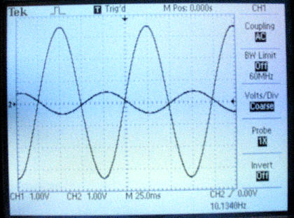

Babowana said:Okay, I changed the input coupling cap of 47uF//1uF film to
10uF//1uF film. This was to try a high pass filtration. I didn't
calculate the frequency, tho . . .
Yep! finally, I'm on the spot.
The bass is tight and has very good pitch definition.
Small details in input coupling caps

Choky,
With 11uF input coupling caps, 'scope measurement of ZV5 having voltage gain of 8 shows the 10Hz sine wave of about 6.8Vpp to the 1Vpp input. This means that 10Hz is still above the low critical frequency (-3dB at 5.6Vpp). Unfortunately, my signal generator can't go lower than 10Hz.
Meanwhile, the critical fL I calculated besed on the 1st approximation with Papa's home brand calculator was 1.3Hz. Therefore, the actual critial fL must be inbetween 1,3-10Hz. This means if I have 48uF coupling caps, the fCL must be further lower.
Then, why I hear the difference (post#93) . . . ?
My ears are fooling me . . . ?

Babowana said:......................
A . . . yo . . .
like I wrote:
mebbe combination of 47uF and bypass cap is bummy
mebbe just 47uF is culprit....
until you try another type of 47 cap,you can't know....
anyway-if you are in ballpark of 1Hz with 11uF - who cares?
put 2uF2 or 3uF3 there and hear increased speed
in this case I think yor eyes can't see (at least) on scope what your ears can ...........
trust to your ears and think simple
