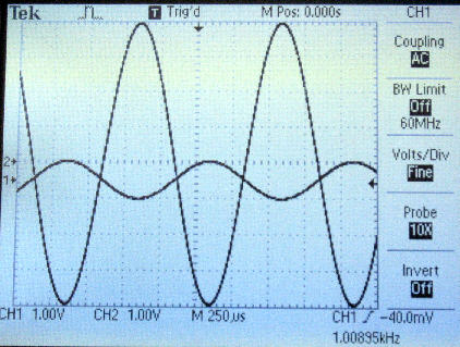

As I promised at Audiorob's ZV5 thread,
I measured the voltage gain at 1KHz as follows.
It is about 8 (18dB) if no error in my measure . . .

Hi Babowana,
Thanks for the reply and info.
1Vpp in, 8Vpp out, 8x gain. I'm getting about 6x gain.
I wonder why... I'm using IRF240 and 9240 FETs. I
think you mentioned that you are using something
else. I'm guessing that could be the reason.
Have you checked to see what your amplifier's full
output before clipping is (I'm interested in the max
peak to peak voltage), and what input voltage is
required to drive full output? For me, it was about
6Vpp in to drive 35Vpp out.
In my case, I have +-30V rails. Full output is a little
better than 17V. Again, I'm wondering why I cannot
drive the output voltage a little closer to rail voltage.
I'm also wondering why the spice models show
higher output voltage than I can achieve in the
practical world.
Thanks again,
Robert

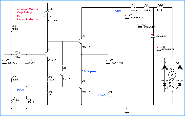

Can maybe be interesting to compare your Supply
with my Class A Designed Supply
Amplifier is based on TO3 transistors MJ211194, which are known to perform good at high currents and high power per device.
0.7 C/W 250 Watt TO3 transistors, Ft = 7 MHz
> Class A
> Trafo 30 VAC
> 38 VDC
> 2.0 Ampere
totally 76 Watt from supply per Channel
Simulated Output: Max 21.5 Watt RMS into 5 Ohm
Description and schematic of my output stage
in this topic:
My simple class a approach
I attach circuit here which very good shows MY SUPPLY.
I did not just add a lot of Capacitance by random.
I tried different combinations of resistors and electrolytic caps
to get the simulation to show as low Ripple as Possible.
It is so called RC lowpass filter.
Resistors will drop voltage with 1.32V,
but to get as low ripple ( milliVolts ) = CLEAN Supply as I got
It sure is worth it, to me, to lose 1 Volt or 2.
Enjoy!
My attachement!

audiorob said:1Vpp in, 8Vpp out, 8x gain. I'm getting about 6x gain.
practical world.
Hi Robert,
I'm using IRFP250N and IRFP9240 of IR. I think that the voltage gain of ZV5 depends mainly on the R2/R1-ratio. In addition, the gain is affected by the value of R5 and R6 at certain degree. If sizes of R5 and R6 go down, the gain goes down too. For your info, my second approximation with the original R values calculates the gain of about 8.35X, which is similar as the measured 8X. If I'm doing right, I could assume that you are using R5 and R6 of lower values than the original . . .
I did not check the output V at the clipping point yet, but have a plan to do.
I have no idea about the spice models. Nevertheless, I believe that the spice models must be useful tools for initial designs of the circuits, but not for the confirmation of results of the final circuits.
Hoping my info will help . . .
lineup said:It is so called RC lowpass filter.
Resistors will drop voltage with 1.32V, . . .
Thanks for the idea, lineup.
I will try CRCRCRC one day, not being afraid of the V drop . . .

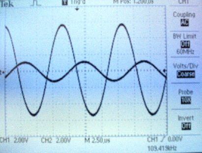

audiorob said:with plus and minus 30V rails, I do not get above 36Vpp output
With +/- 20V rails, I get about 36Vpp output just at the start point of clipping.
For your info, attched plz have a look . . .
That is excellent information. Your amp acts as I would expect.
I wonder what I did wrong! 🙂
Thank you!!!

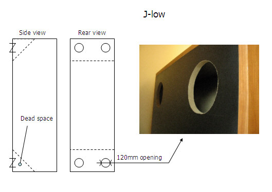

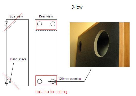

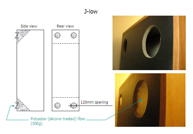

Babowana said:I do not miss details from the combination of ZV5 and J-low. This combination is much better than my previous combination of F1 and J-low. I had high pass filter when I was listening to F1 to kill honky in bass. But, I no more need that with ZV5.
Mm . . . actually I did something new to J-low.
J-low has two dead corner spaces: upper and lower corners. And, the spaces are closed and empty inside. I introduced two 120mm openings to each closed space to make it an open space. Wow . . . and found very effective in bass (<120Hz) performance. For details of the openings, attached take a look at the sketch and the picture . . . The combination of ZV5 and J-low treated in this way . . . really very very good !!!
O, . . . one side effect of the openings is that I can use them as hand-grips when I move the location of J-low . . . 🙂
Dear Nelson,
I believe that proper handling of the closed dead spaces with openings (or filling them with sand or whatever) is a "must". I hope you would consider additional comment to your article when you have any chance. For me, the openings are much more effective than the high pass filter which is intended to remove the habit of honky bass. By the way, I don't know technically how the openings work . . .
Babowana said:By the way, I don't know technically how the openings work . . .
Hmm . . . I was just guessing that when there was music, there might have been standing waves at certain energy level inside the closed space. And, those standing waves might have been a cause of resonance peaks in bass frequency . . . Therefore, I just wanted to provide the openings to the closed space, wishing best luck in releasing the satanding waves . . .
Back to ZV5, attached shows the upper critical frequency (-3dB) at about 110KHz, similar as 100Hz indicated in the Pass article. By the way, plz kindly understand that I am not trying to verify Pass work. 🙂 Actually, I'm practicing his design, checking the things I have done and trying to learn many valuable facts . . . 🙂
you created sorta reversed Helmholtz resonators,in your case not for sucking unvanted resonances but for emanating sayed frequencies.......Babowana said:
Dear Nelson,
you can stuff this cavities with some absorbant material for test;if you like it that way-leave it ,or you can then cut back plate pieces of these cavities,to open it and make non-cavities or non-resonant
what a sentence from ZM!
whoa!
The CLC filters that Nelson uses is more effective filtering
than my used CRC.
Besides better filtering CLC also has lower voltage loss.
That is if you use THICK enough wire.
Thick wire has got lower resistance, Ohm, than thin wire.
But as with anything. There is two sides.
Advantages and drawbacks with any method.
Main advantages of using CRC or even like I do in my schematic,
CRCRCRC are:
You can buy and have a setup of low values ( 0.10 - 0.33 ohm ) power resistors in your lab.
They need not be more than like 2 - 5 watt rating = small power resistors.
If you then have also at home a supply of 4700 - 10000 uF electrolytic caps,
then you very quickly can put up a nice clean supply for any amp experiment.
The drawback with those very effective CLC filters are, as I see it:
- Takes time and effort to wound and make those big inductors.
You also need to have rather thick specially coated wire for this.
- Takes up a lot of space, as they are much bigger than 2- 5 watt resistors.
CRC are quick to put together and easy to change
and test different resistors values in combination with different caps.
And take up a rather small space in an amplifier box.
Having resistors also Protect Big Electrolyts from inrush currents at powering up.
Toroid trafos can have quite shocking first seconds behavior!
It will be a slow powering up, no overloading and this will give caps a bit longer life.
That Class A power supply shown
takes almost 1 minute before power supply caps have reach full working voltage
and I can run tests on that amplifier stage!
The power supply in my previous post up here
simulates in SPICE to give only 95mV ripple at 2A from 38 Volt DC (30 Volt AC Power).
With a reasonably big transformer, I would imagine a real value
would still be only a few 100mV ripple.
Which I consider a very good and clean Power Supply for Class A.

Zen Mod said:you created sorta reversed Helmholtz resonators,in your case not for sucking unvanted resonances but for emanating sayed frequencies.......
whoa!
Blue Car!
Ah, Helmholtz resonators . . .
I was actually thinking about filling-in with stuff or entirely cutting-off the corners (along the red lines as you indicated). I have however given up the choice of cutting-off because I want to keep the current look of J-low. Of course, I could cut off the back panel of full square openings to make the air spring inside the cavities weaker even though I have considered the two 120mm openings as large enough.
I believe the filling-in stuff will be effective in dulling the air spring action inside the cavities. I am on the way to buy some stuff. I will see the result.

Filled in each space with polyester (silicone treated) fiber of 550g,
and attached the picture of it.
I did not carefully compare the sounds before and after the filling . . . Anyhow, both examples remove quite parts of boomy bass which I had with the closed empty corner spaces . . .
The bass became better pitch definition and better music's tonal foundation. Depending on music style, however, the quantity or the body of bass is a bit overflowing (due to poor recording?) . . .
Overall, I'm satisfied with the result. 🙂
