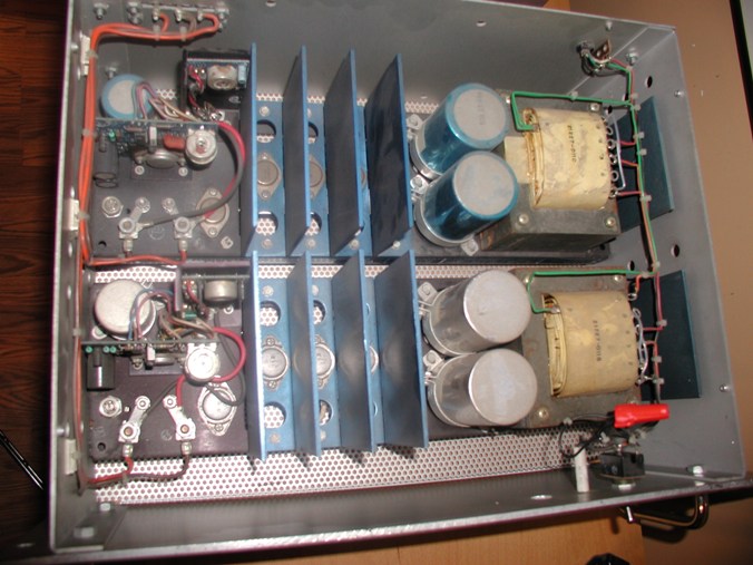

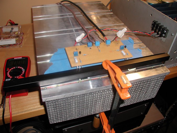

Well I finally got around to building a single Zen V5 channel with the 2SK170/SJ74. I put it on a monster heatsink (30 lbs alone)
For a power supply, I had bought this huge power supply for its chassis, and I noticed it puts out a nice +/-20V at least 11A. Its an Audio Designs PS-2020-10. Picked it up for $40. I dialed in 23.5V for both rails via a pot.... Anyone see one of these before?
Anyway, getting a bit off topic...since I have such a huge sink, I biased the amp to 1V so 2.1A, 50W/fets and dissipating 100W. Looks like maybe 35W/channel into 4 ohms - 27W/channel into 8 ohms?
Anyway, sounds very nice and clean...Bias swings a bit and every 15 minutes I find myself rechecking it...
No hum at all. I am glad I bought this power supply...full of motorola 10-19655-2 Transistors (6 per channel) and two pairs of 22,000uF caps per rail - maybe a commercial Capacitance multiplier? Too bad its HUGE...

john65b said:And a pic of the amp and heatsink - I think the sinks were once a load bank from the local electric company...
