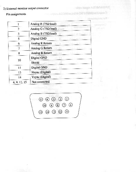

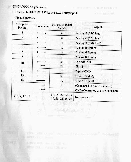

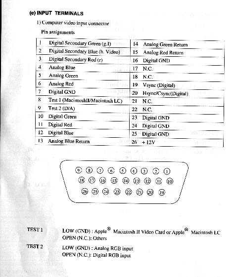

Thank you so very much braxton. This will be a big help for a lot of people. But I have one question for you. Can you show the oppisite page with the 15 pin vga connector. I want to make sure I make my cable right although I think I know how the vga connector is layed out. I made a nice Infocus cable before 🙂 . Thanks again.
Very cool Braxton thanks for posting that so quick. That is the one we needed. I don't think there are any mac users out there.

I think you should post the Mac pinout incase people do need it

Hmmm Very interesting. Thanks for the pinout braxton it seems to sort of worked. I built the cable just fine. Plugged it in turned the computer on 78" scandisk 🙂 . Started to load windows but just when it was about to enter windows all of the sudden the panel turned to gibberish. Rebooted saw all the same dos stuff just fine. Checked windows settings 640*480 tried 60hz frequency. Ditto for anything in windows. Tried various things like half-life etc but no picture in windows.
Ok I just did some more testing with the panel. It seems as though there is something in ATI RADEON drivers it doesn't like. I tested the panel with a laptop trident video chipset worked perfect, tested with desktop ati rage pro worked perfect,tested with my radeon 7200 nothing in normal windows. Booted up and ran in safe mode bam image appears. Which leads me to believe that Radeon drivers don't like sharp panels.
