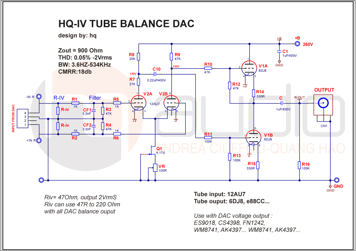

I'm thinking about using E88CC as White's cathode follower, anybody used something similar? High current, popular tube, application is known as one of the best.

Any advantage to using this buffer for an output stage for the Soekris?
See schematic in first post.

I have tried Salas DCB1, but it did not bring any improvement in my case. I do however have Vrefs powered with external regs, maybe that is why.
Based on my experience the best output stage for Soekris is no output stage at all since it does not required one. The best combo I got so far is connecting raw outputs (skipping onboard opamps) directly to Modulus 86 amplifier.
