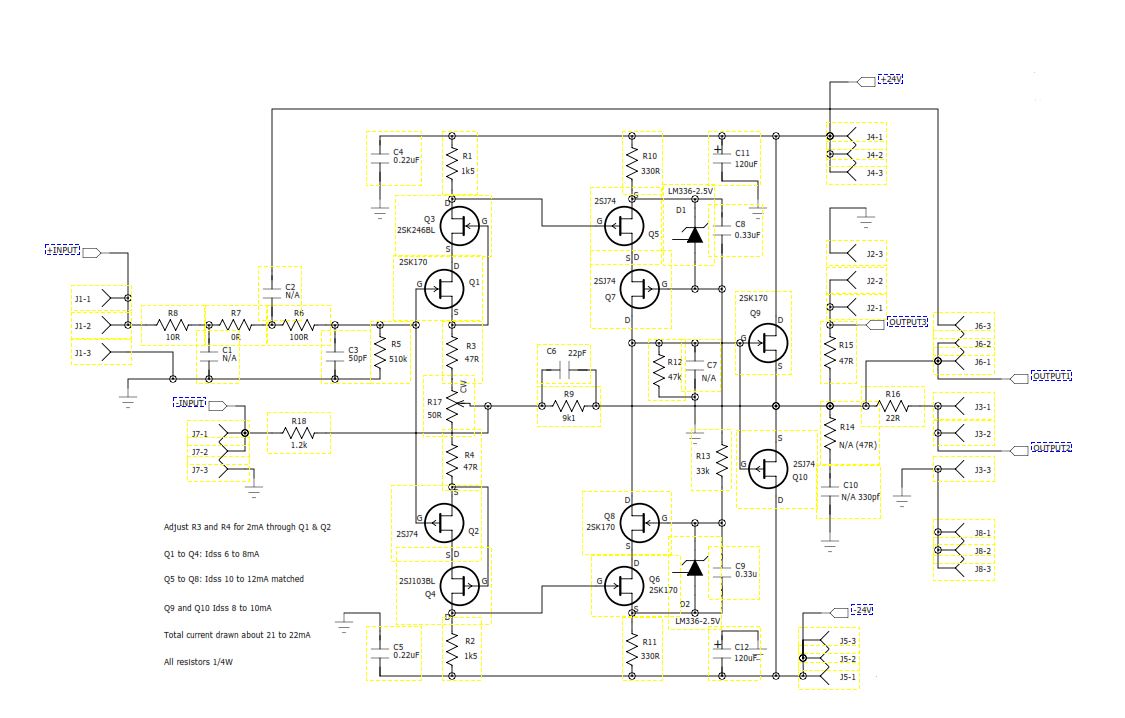

Output stage for the Soekris R2R
They have differential input, so you can just have signal ground as the second input and that'll give you the balanced benefits. My current dac is using trafos on the output but the dam doesn't seem to need it?
you can just use ground as second input, and this should work. While the dam does not need a trafo output, a trafo would balance the output impedances for true balanced operation, and apparently the hypex amps benefit from this. But, if it works for you without buffer and trafo, then it should be also no problem.
That is true and I agree with that. However as far as I can recall Soren states that with 28bit depth of soekris at -70db level stil first 16bit are played. You can find it somewhere in soekris related thread.
