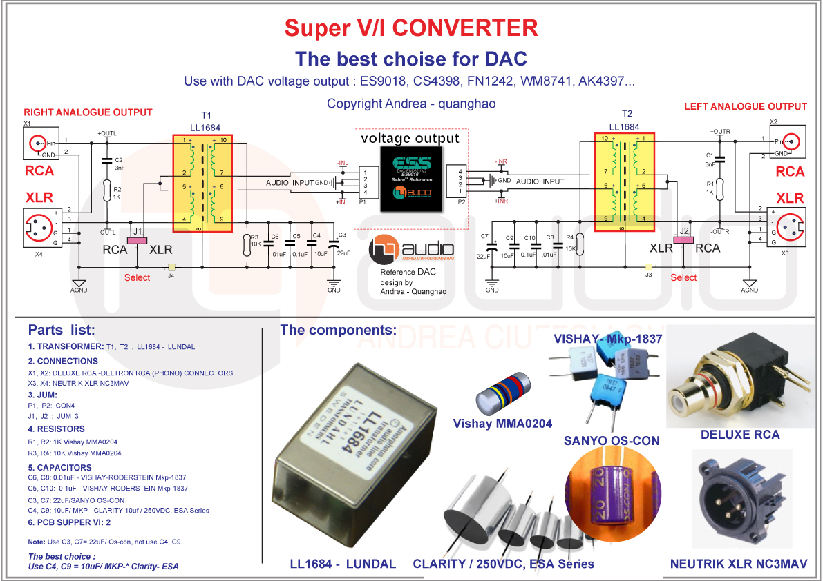

What about the Super V/I converted For DAC (http://www.diyaudio.com/forums/quanghao-audio-design/246579-super-v-i-converted-ll1684.html)?
Is it suitable for Soekris R2R?
Lundahl Transformer?
Which Lundahl Transformer will be perfect match?
To,
1. Block the output DC?
2. Give somewhat passive filtering of image noise
The simple approach to take the LUNDALH LL1684 and connect it according the schema #1. But i would recommend to check DC presence in a good time.
stijn001 measured 2V DC. Here is the post, http://www.diyaudio.com/forums/vend...magnitude-24-bit-384-khz-229.html#post4267912
