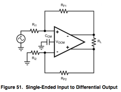

Aside from creating a composite stage there are two potential areas for improvement in the differential amp. The worst case CMRR of the LME49724 is determined by the matching of the gain resistors:
CMRR dB = 20log10(tolerance)
The stock board uses 0.5% tolerance resistors so:
CMRR db = 20log10(0.005)
= 46dB
This is well shy of the Datasheet spec of 102dB.
Improving the resistor tolerance to 0.1% increases the worst case CMRR to 60dB, and parts are reasonably obtainable and cheap.
Every additional improvement in tolerance gives roughly doubles the worst case CMRR, so that 0.05% = 66dB, 0.02% = 74dB, 0.01% = 80dB.
Once you go beyond 0.1% stocked values are pretty limited and you'd need to recalculate the gain resistors to use what is available.
The other possible improvement to the stock LME49724 config is adding a bypass cap to the Vocm pin. The datasheet suggests that noise on this pin reduces PSRR of the chip and recommends a 0.1-1uF cap in this position. There is potential that noise on the ground plane will have a negative impact on the PSSR, so adding a cap here may provide some benefit. I've got a couple of bags of 0.1uf MLCC ceramics around somewhere so I'll give this one a try and see if it helps at all.

Not that I want to stop you experimenting, but:
1) CMRR ratio doesn't matter as the LME49724 not being use as a balanced receiver....
2) Vocm pin is already connected directly to GND.

CMRR will have some influence on rejecting noise that is common to both inputs, so should help even in the single ended to balanced conversion.
I know that Vocm is connected direct to ground. The datasheet seems to suggest that any noise on this pin will degrade PSRR. The example single end to differential convertor schematic shows a cap between GND and Vocm, which I assume is to isolate Vocm from any noise that may be present on the ground plane.
he VOCM pin should be bypassed to ground with a 0.1μF to 1μF capacitor. The VOCM pin should be connected to ground when the desired output common-mode voltage is ground reference. The value of the external capacitor has an effect on the PSRR performance of the LME49724. With the VOCM pin only bypassed with a low value capacitor, the PSRR performance of the LME49724 will be reduced, especially at low audio frequencies. For best PSRR performance, the VOCM pin should be connected to stable, clean reference. Increasing the value of the bypass capacitor on the VOCM pin will also improve PSRR performance.
The data sheet is not entirely clear about the treatment of Vocm when it is connected to GND but the application schematic would suggest that a cap is still required for best performance.
There is actually information regarding the Vocm pin in a TI Fully-Differential Amplifiers application report*. The Vocm pin is intended to be bypassed to ground with a capacitor to filter broadband noise. The pin feeds the inverting input of the Vocm error amp.
From reading the Noise Analysis section it appears the amount of noise present on the Vocm pin that appears on the outputs depends largely on the degree of mismatch between the two resistors in the feedback loop. If they are exactly equal there is no error voltage, and consequently the noise on the Vocm has no influence.
Tightening the tolerance of the gain resistors and decoupling the Vocm with a capacitor should at very least reduce the potential for adding ground noise into the outputs.

Ecm is the RMS noise at the Vocm pin taking into account the spectral density and bandwidth, as with the input-referred noise sources. Proper bypassing of the Vocm pin reduces the effective bandwidth, so this voltage is negligible.
The Vocm error amplifier produces a common-mode noise voltage at the output equal to Ecm. Due to the feedback paths, β1 and β2, a noise voltage is seen at the input which is equal to Ecm(β1 – β2). This is amplified, just as an input, and seen at the output as a differential noise voltage equal to
2Ecm(β1–β2)/(β1 + β2) .
Noise gain from the Vocm pin ranges from 0 (given (β1 = β2) to a maximum absolute value of 2 (given β1 = 1 and β2 = 0, or β1 = 0 and β2 = 1).
* http://www.ti.com.cn/cn/lit/an/sloa054d/sloa054d.pdf
The Vocm bypass capacitor only makes sense when Vocm is not connected to GND, but to some other reference voltage.
As we don't have any details about the ground layout of DAM1021, we should make the worst case assumption that it has a single GND plane for everything - digital power, analog power and analog signal, and therefore GND is noisy and CMRR does matter. The 0.5% tolerance gain resistors are certainly not helping here. 0.1% resistors are cheap and easy to get, it would be worth a try replacing them. Connecting Vocm pin to different GND points could make some difference.
Sensitivity to load impedance imbalance is another thing to consider. If the goal is to make the output buffer less sensitive to different receivers, it could be beneficial to add a line driver with load imbalance compensation.
