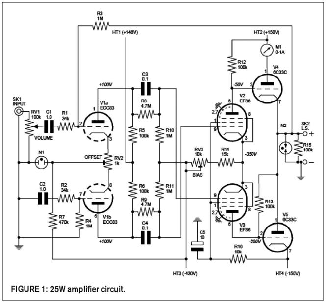

The original article says:
I assume I have to adjust resistor values to lower gain (?) so I get this same 25W into a 8 Ohm load at 2V (instead of 500mV) when unbalanced. For PRE-IN. (I'm planning having 2 unbal. inputs, one with attenuator and one without). For the attenuated input, is it enough to use a different impedance volume pot ? But for the direct input without pot, the previous question is still valid.
In both cases I'd like to avoid overdriving input stages or the whole amplifier.
Any ideas on these ?

The signal from input phono socket SK1 is fed to the grid of V1a via the volume control RV1, C1, and R1. Shunt feedback is provided by resistors R1 and R3, which mix the output and input signals to set the overall maximum gain to a value of R3/R1, which is about 29. In other words, an input voltage of 500mV is required to produce 25W into an 8Ω load. When RV1 is set to maximum, the input impedance is about 26k due to RV1 in parallel with R1.
I'd put 2 XLR connectors onto the amp too, switchable. Not sure how it will behave in such a case (meaning input level) if I apply this trick as well, in this case I'm fed by a 4V output on DAC side. (Again, direct input, no attenuator).Of course, you could achieve excellent noise immunity by using a preamplifier with a balanced output and then applying this to both grids of V1 via C1 and C2.

Looking at the schematic it's a SE input with a LTP phase splitter on the front.
Look at it like this - the tubes don't know it's balanced and only see the larger 4V signal. So those input tubes potentially will see the full 4V signal on the grids depending on volume setup.
LTP is basically the differential piece of an opamp. As such you should then get a corresponding differential output. The size depends on the design.
The NFB is the differential so I suspect the LTP would compare only one part of the XLR signal against the differential. Thus I'd expect a 4V XLR signal is being compared against a 2V differential output.
The M60 has an SE RCA that attaches to the XLR, the rest of the system is balanced and has a feedback for each phase from the circlotron outputs to the LTP at the front - thus essentially compares XLR input pin to the corresponding output pin. The resulting signal is only produced at the output by the difference between the two XLR pins.
I was looking at this - sounds like I have the wrong schematic?
I have found on google what seems to be a balanced from page 2 of this thread which would work but it has a B+ rail based feedback network so I don't think it's the Tim Mellows' design without modifications.
Apologies - I forget to say - yes adding the XLR inputs to both sides of the LTP will cancel common noise and will act like a differential input I may have missed a feedback loop (perhaps through the rails).

Yep that is precisely the way you'd do it.
The input tube and amp gain states 500mV for 25W, so you'd be reducing the volume (that would be needed on both inputs).

It would be possible to add additional feedbacks into the design too - it's just that as it stands the feedback is only SE.
Thanks NickKUK, so in general, if I want to feed the amp with input levels above 500mV, I need to drop some voltage first.
Which would be the most elegant via reducing the input tubes' gain maybe.
Looking at the EF86, the input grid range to that is relatively small but factor in negative feedback. The ecc83 is a 100mu tube with a 0-4V grid so you may need look at that if the input is 4Vpk (rather than 4Vpp) unless you voltage divide it down. The EF86 has about 4Vpp so the ECC83 is providing the 500mVpk to 2Vpk.
Fastest route would be to volume reduce before the input tube. Longer term you could replace the ecc83 with a lower mu tube with some possibly knock on changes however this would change the sound.

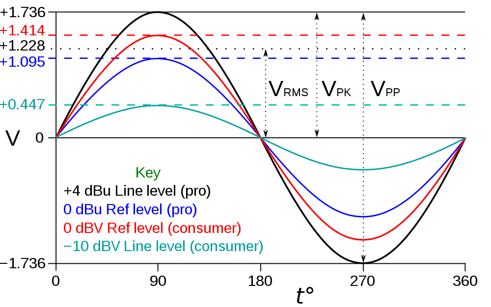

I was taking your RCA/XLR taking that as Vpk. rather than Vrms/Vpp. Vpk is what the tube will see when fed into the grid.
Line level - Wikiwand
Vrms = Vpeak/1.414. So peak is larger than Vrms.
You could make the tube frontend a near buffer stage, so it provides the high input impedance and drives the pentode drivers. Try it with the standard design first, then modify it. There will be enough fun with getting the tubes all tuned up.

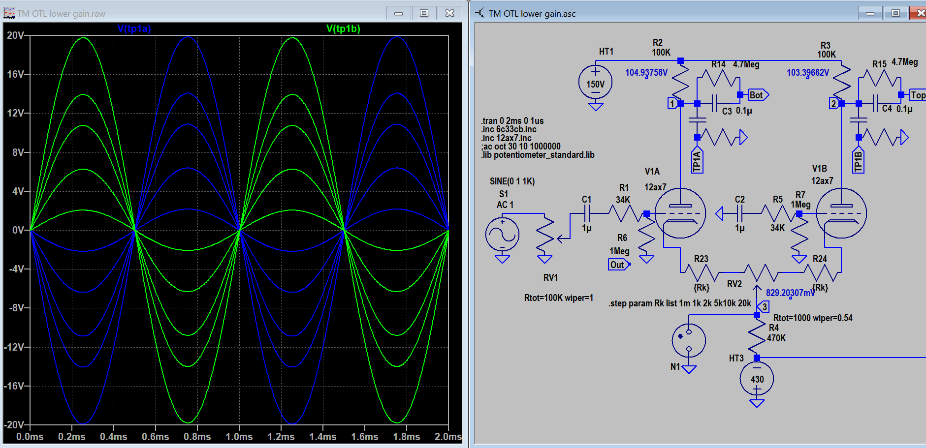

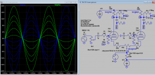

To reduce gain in front LTP just insert cathode resistor of equal value to each leg with out affect the anode voltage that set the bias of entire stage. When the gain is reduced you need to increase gNFB to maintenance damping factor is also a good way to check which damping factor is best for your speaker.
12ax7 ltp stage has a max. gain of 20, it's possible to reduce it to unity with 20k cathode resistor.

Koonw's reduction reduces the output voltage of the LTP. This makes it less sensitive but has a couple of caveats:
* My understanding is LTPs like large Ra values that gives the best differential balance.
* It doesn't change the input grid limitations
* This also changes the operating point and steepens the line thus you may find the input range drops to stay out of the the distorting areas (ie near 0-1mA for example).
I'd be tempted to rip out the EF86 and see if an EF89 could be replaced instead - it's grid range is far larger but it has a larger current draw. No idea if it could but worth exploring if it's available, there may be other tube better suited. It would definitely need a PSU updated.
That is because 470k is still a poor constant current source, try with a real CCS.Code:My understanding is LTPs like large Ra values that give the best differential balance.
I was going to suggest a CCS on that but I thought we were into enough complexity It should also help flatten the load line
You can stay with 470k as long as cathode resistor (e.g <20k) does not cause too much unbalance. The 2 cathode resistor need not be identical for gain reduction, the one on the input side detect the gain. That is all I know: one is ground cathode amp the other is cathode follower the gain is slave to other one, not by the cathode resistor. In this amp, the cathode resistor to be added should be same so the anode voltage is same.
