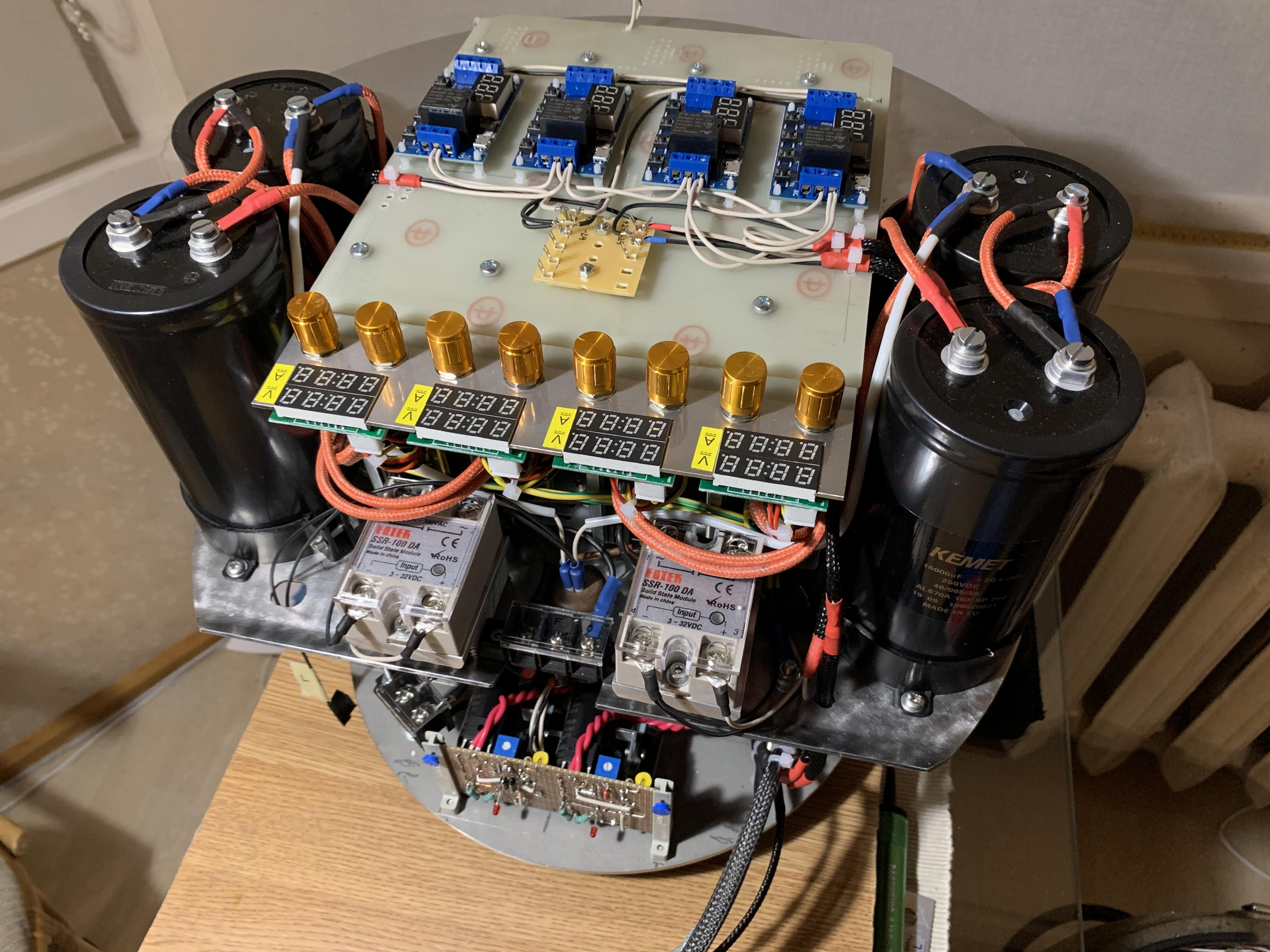

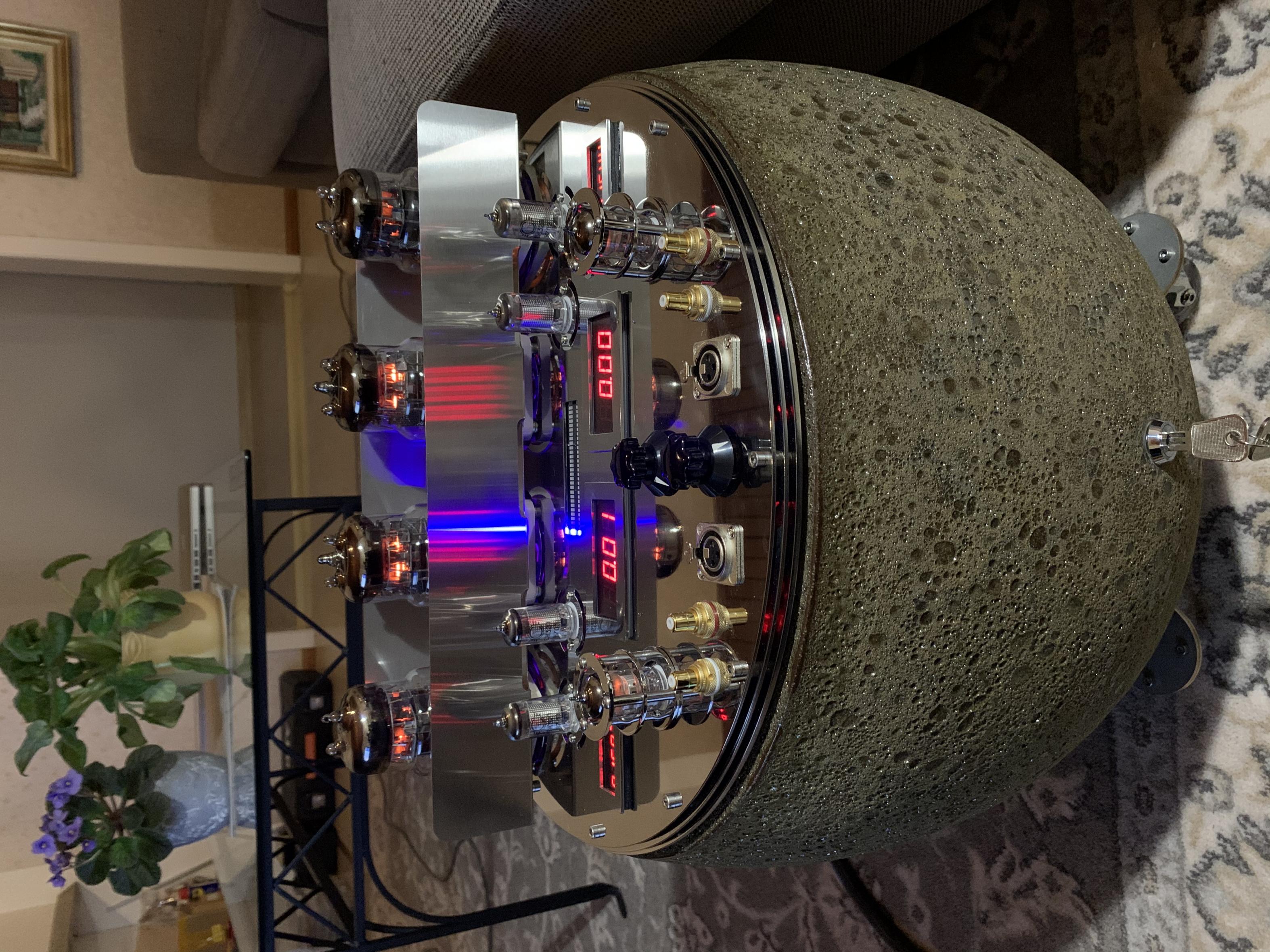

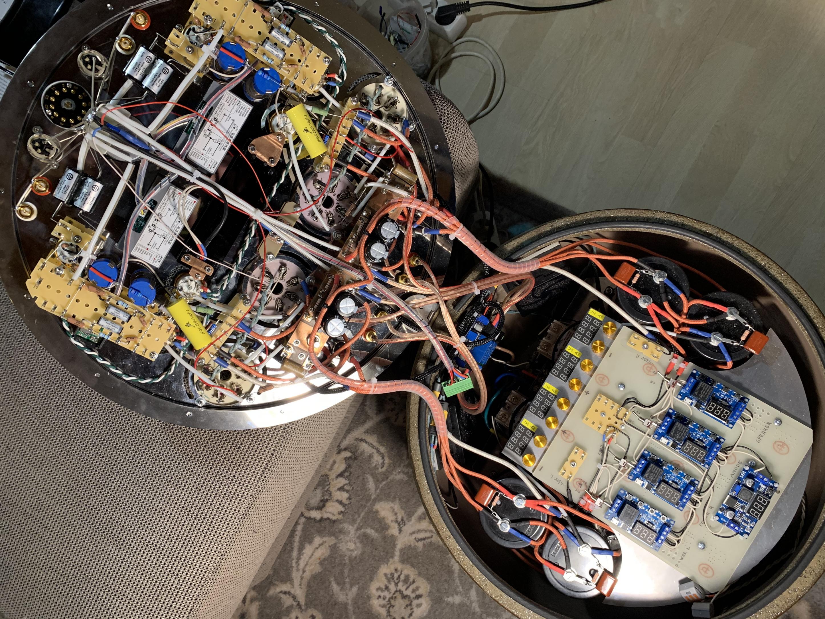

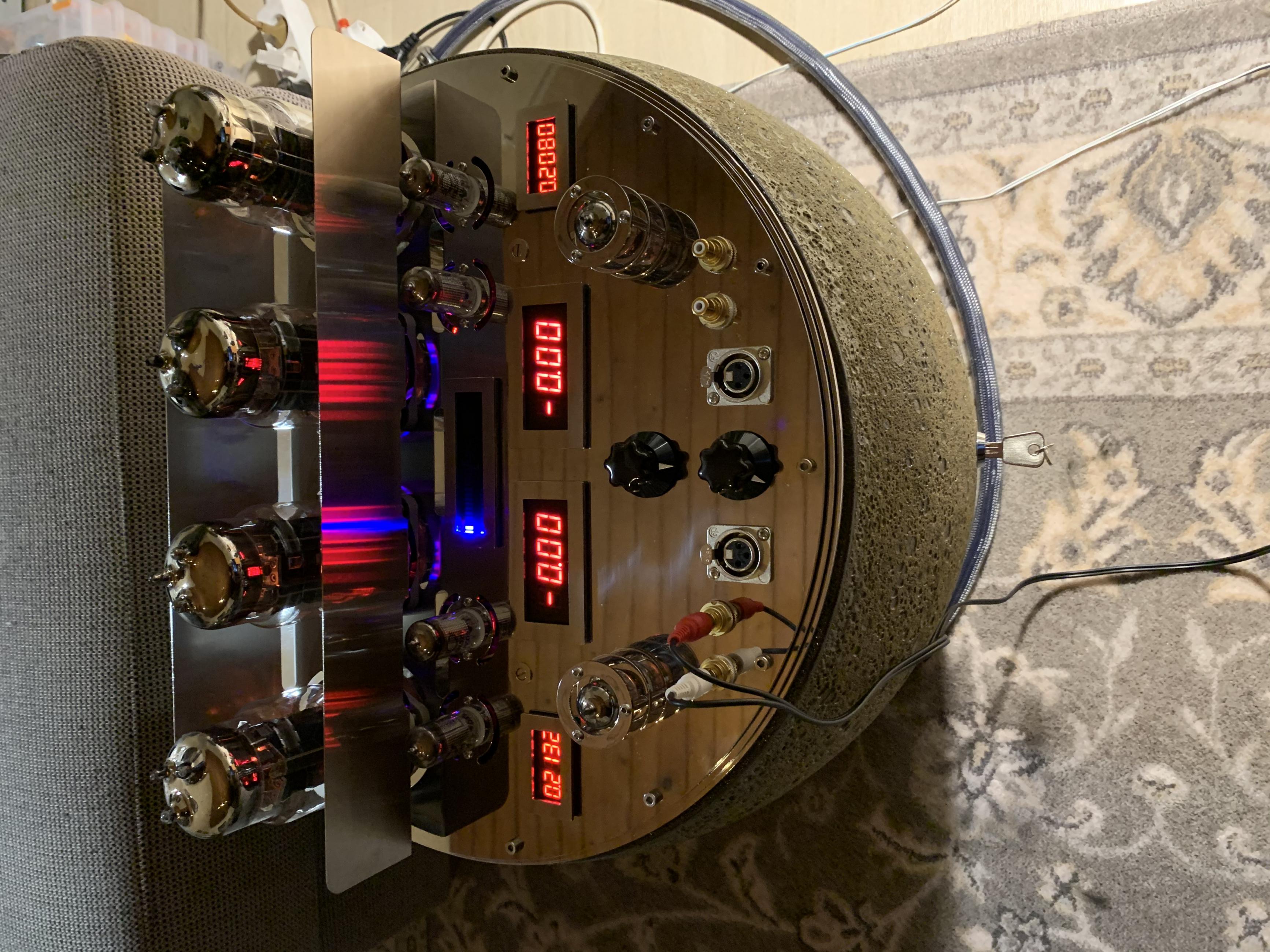

Hello everybody! Thanks guys for interesting reading and ideas!
Like I have spent last year to make my own "Tim Mellow", I decided to share
the result with You all. Hopefully I will not make anything wrong with posting
and can add some pictures of work done. BTW this thing is singing as an angel
together with ESS AMT-1C speakers. Any comments are welcome and sorry if my English is not the best...
And so: Ladies and Gentlemen - meet the Rolling Stone...

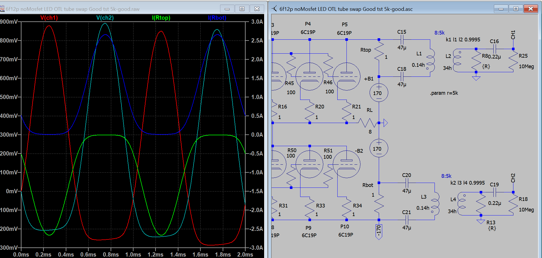

Here is a cheap but safe and reliable transformer isolated differential probes for measuring symmetry of current in upper and lower banks of OTL output amp. I use 10W se transformer 5k to 32ohms but you can use any OT, for 32 ohms sec I can get about 4Vp-p in the output. This has helped me solves some of problems, like tube gain balance etc, hope you like it.

I want to know if VintageFart's key in the amp is to prevent it being opened or being used without permission :D
Hi NickKUK! The key is just a regular ON/OFF switch but could also be used as a PFWA (Protection From Wife Action). Just remove the key to activate this function :)
