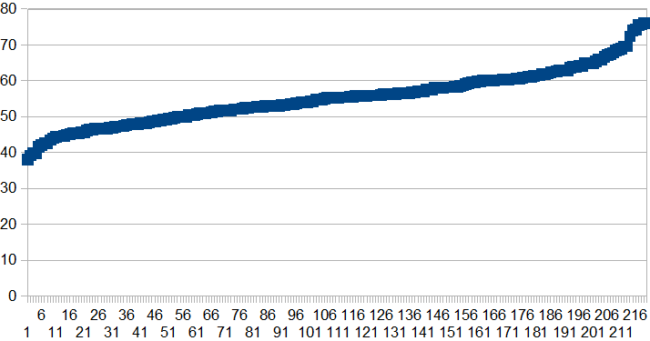

Ubalanced output tubes will give increased distortion. In our amplifiers we match output tubes to within 2V difference in grid voltage for same idle current.
6C33C tubes spread quite a lot so if pays off to have many tubes to choose from, attached is a plot of grid voltage for >200 tubes, as you can see grid voltage goes from below 40V to above 75V, all can be useable if you select 2 that don't differ to much.
The reason of the wide spread in 6C33C is that high Gm tubes have very small inter electrode distances so any tolerance have much higher effect than in a more normal lower Gm tube

I did a quick simulation in which I added a 10 ohm resistor in the cathode of only one of the output tubes. This should have a dramatic effect on the 6C33C as it not only affects DC characteristics but also completely changes the curves meking it a weak tube. Of course the max output drops to some 15W but I was looking for changes in distortion at much lower levels of 5W or so. After readjusting the quiescent current with the pot to the previous 200mA here's the result:
THD went up from 0.2% to 0.4% and DC across the speakers increased by 2mV.
So I would say not too picky on tube balance - with the design as is with 54dB of open loop gain , 26dB of FB and 28dB closed loop gain (sensitivity 0.5V).
Now will this change when we reduce the open loop gain ? e.g. by KOONW's method, because now the FB is potentially less efficient when it comes to error correction.
Again a quick sim, with open loop gain 35dB, same 26dB FB and 9dB closed loop gain (sensitivity 5V, R1, R2 now 330k). Your target forgain reduction maybe ...
DC unbalance with degraded tube now 25mV - FB less effective due to lower open loop gain - which is correctable with the balance pot.
THD with degraded tube was again 0.4%, because I kept the global FB the same 26dB.
It seems that the global FB is quite effective to deal with distortion caused by output tube unbalance ,
but reducing the open loop FB degrades the effectivity of the DC servo mechanism as expected.
