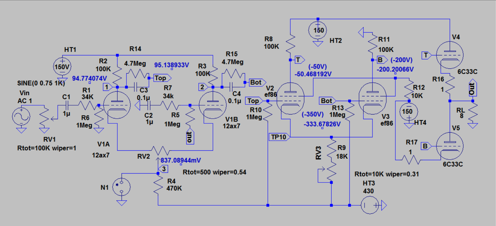

Have a look at the circuit again:
The DC servo is already built in because the FB from output to input tube grid is DC, the 1 Mohm resistor ... and the whole amp is DC coupled, too ... this amp actually IS a tube based op-amp ...
its just that when you reduce open loop gain the precision of that built in servo is also reduced.
Doubling or nesting servo loops is maybe not so good an idea as they might fight each other ...

Is there any way at all, to preserve this error-correction capability, while aiming for somewhat lower gain and let's say, 6V input sensitivity ?
- with the existing circuit ?
- by replacing maybe ECC83 with ECC88 ?
- any other ideas ?
Maybe I'm wrong but I have the feeling that there is some misunderstanding when it comes to gain and gain reduction.
Open loop gain is the gain of everything inside the global feedback loop, measured from grid of V1a to the speaker terminal, without connecting FB resistor R3. In other words, the raw amplifier.
Closed loop gain is the resulting effective gain with FB resistor R3 connected. This is what defines the sensitivity.
This effective gain with FB applied is nothing else but the ratio of R3/R1. In our case this is R3/R1=1000/34=29.4 or about 30. With this we get full output with 0.5V RMS input.
In reality it is a tiny little bit less because open loop gain is not infinite, but close enough.
Any change you do which affects only the open loop gain, (KOONW's 20k cathode Rs, ECC88 tubes instead of ECC83 etc) has very little effect on the overall gain, which stays close to R3/R1.
So to reduce sensitivity to 5V you could simply make R1 higher, say 330k, which would drop effective gain to R3/R1=1000/330=3. Now 5V RMS input would result in the same full output as 0.5V did before.
But, here's the catch: We have now increased FB by a factor of 10 if we leave the open loop gain where it was. When FB was 26dB before it is now 20dB more and we end up with 46dB of feedback. Scary ... This is not a good situation because the higher this figure the less the stability. In other words we risk the amp becoming a HF oscillator. And an oscillating 25W amp will burn out your tweeters in no time at all.
So, to re-establish the same amount of feedback, which we know works because this amp has been built many times without problems being reported, we need to reduce the open loop gain by a factor of 10 (or 20dB). And that is what KOON's cathode resistors will do.
To summarise: If we adjust the FB to get sensitivity of 5V we should also adjust open loop gain as per KOON's proposal - at the same time.
ECC88 instead of ECC83 will not be enough gain reduction though.
My opinion:
Build the amp as is with high sensitivity. Adjust the trim pots. Make shure it works and performs.
Simply add a 10:1 voltage divider directly to the input terminals before the volume pot.
Won't do any harm.
Safe and easy, don't try to solve more than one problem at a time even before you know that what you built is error free.
Once everything is up and running, try the modification, add the 20k cathode resistors and increase R1 and R2 to 330k. Again re-adjust the pots. Compare ...
Are there ANY safety precautions regarding type, placement and manual setting of RV2 & RV3 ?
Will 2 normal little blue precision trimpots just do the trick (I used to use these for my low-voltage regulator IC-s) or shall I choose tougher kind of trimpots ? Just because of voltage, when I look at the schematics.
RV3 dissipates about 125mW when set at mid-point, the max rating is for the whole 10K, so a 1W version is a good choice. It is very sensitive, the bias current jumps from 200mA to 400mA within 1 kohm of change, thats why Tim recommends a 20 turn.
RV2 handles less than 1mA, no significant dissipation. But quite sensitive as well, 20 turn.
Voltages across these pots is not big but RV3 sits at about -400V relative to GND, so keep away from chassis ...

For permanently lowering input sensitivity, a friend of mine suggested following:
- about ca. ~75kOhm resistor in series with input
- changing the pot from 100k to 10k type
I assume this is the simplest 'quick & dirty' way of doing this, without affecting anything else behind that input circuit, right ? So actually, a voltage divider.
(In this case I couldn't switch between 'high input' and 'low input' with a simple switch).

quick but not dirty at all ...
actually a lower R pot could be a benefit;
the way feedback is done in this amp the amount of FB varies with pot setting;
closed loop gain is approximately A = 1M / (34K + P1//P2 + Rsource),
with P1 & P2 being both halfs of the pot depending on volume setting;
so a lower value for the pot is good as it reduces FB varying with volume setting.

Good evening !
So, just having thought about this for a day or so.. which method would you choose if you had a DAC now with 2Vrms output, and a future DAC with 4Vrms output ?
a) building the amp as it was originally designed and use an extra voltage divider before the input
OR
b) what my friend suggested with the 10k pot ?
If I understood you correctly, the original design, so case a) is more prone to feedback-variations with volume pot setting. And of course if I feed a 500mV sensitivity amp with such a strong signal, the pot would be all the time at pretty minimum-ish setting, hence feedback strength mainly smaller too. ( = weaker feedback). Right ?
In case b) the pot would be turned more likely towards maximum due to less input sensitivity, whereas feedback variation with pot setting would be significant lower compared to case a), hence (probably) less sonic differences.
If you could confirm these.. because I like case b) really, and it's time to by that pot. Btw I'm not aiming for 2/4Vrms exactly because not all recordings have that high signal strength in digital, so such music couldn't really drive my amp close to maximum power, if I have a pretty daring 2V/4V sensitivity. Maybe 1.5Vrms and 3Vrms (RCA/XLR respectively) would be a good optimum. For modern pop music which tend to swing signal almost to maximum, I'd just turn down a little bit on the pot, for older music, which are in general a bit more silent I'd still have some reserve then to compensate with the pot.

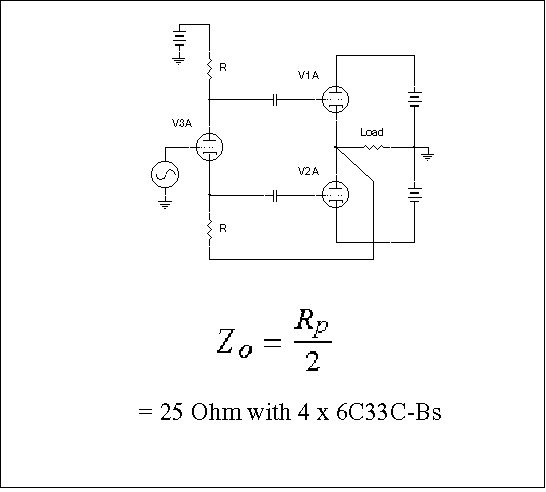

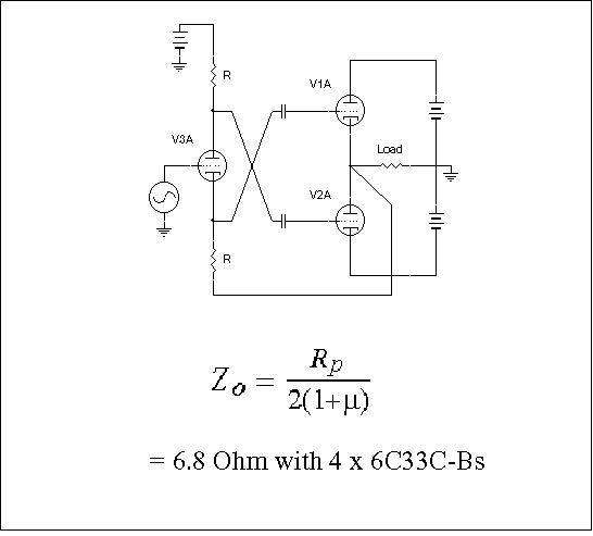

If you do this you have to be aware that it also changes the way the output tubes work.
This is essentially a Futterman architecture.
Futterman in his patent claim for his H1 OTL he erroneously stated that both output tubes worked in cathode follower mode; this was not the case because the way he hooked them up they actually were both grounded cathode.
Later designers of OTL circuits fixed that by swapping drive signals, requiring another stage front up.
See the attached pictures. 6C33C OTL
If you swap drive signals in Tim's amp you will turn cathode follower operation into grounded cathode operation.
Whether this makes any audible difference has to be investigated, so you can try it out. The amount of FB in this amp may make up for the change in output impedance which is a small signal issue anyway.
