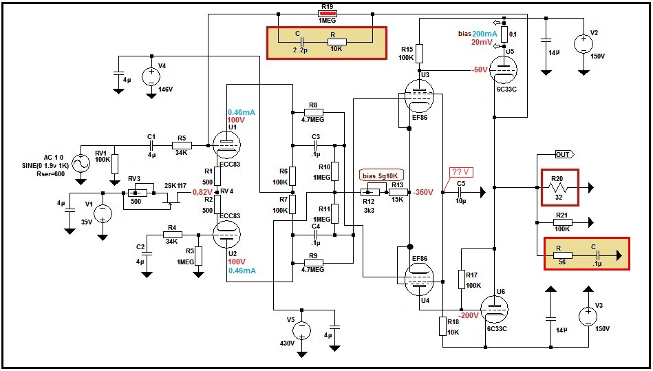

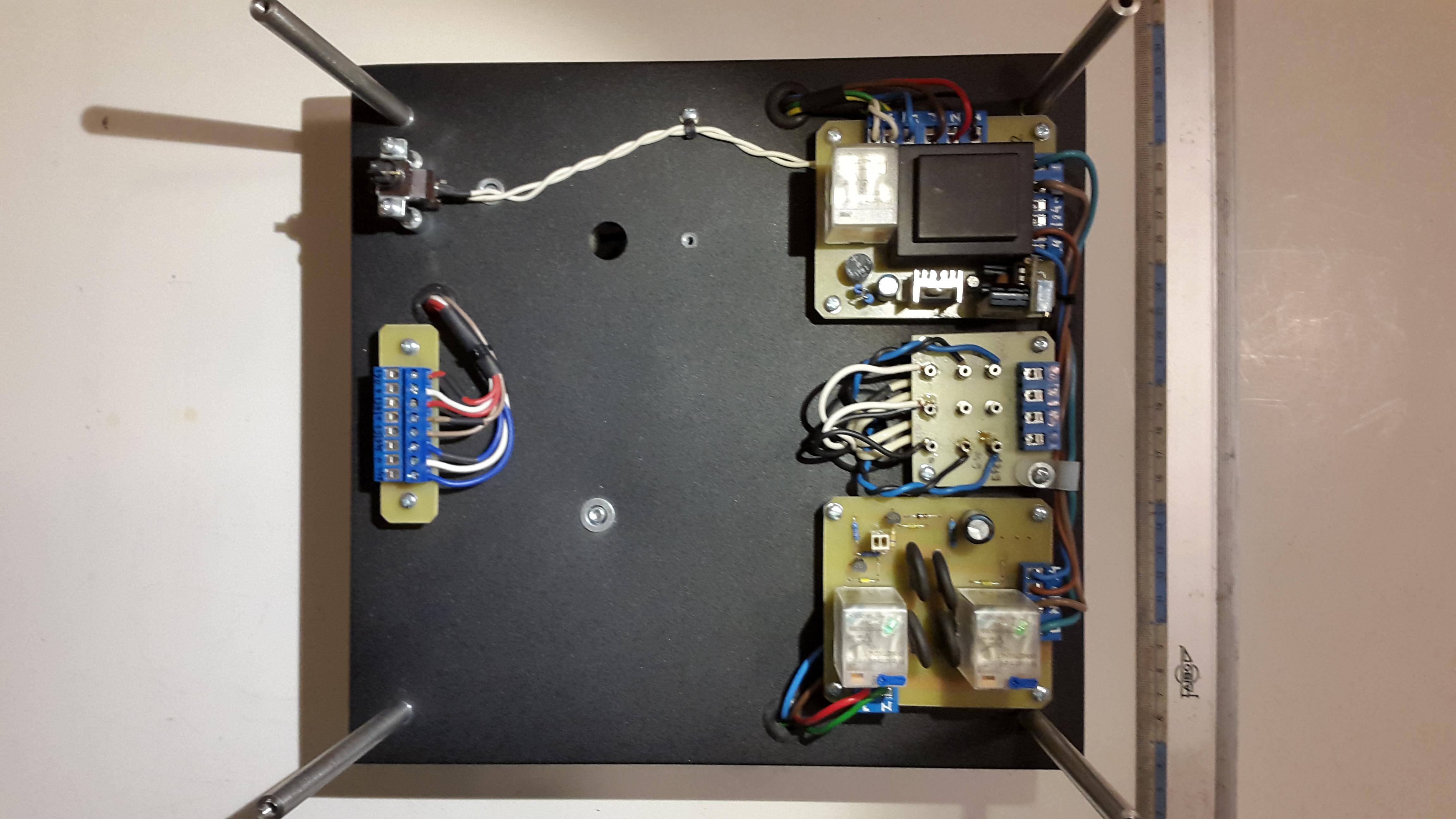

In my case, after lots of conversations with Tim Mellow (who kindly answered every time even to my most stupid questions) I had done the followingS:

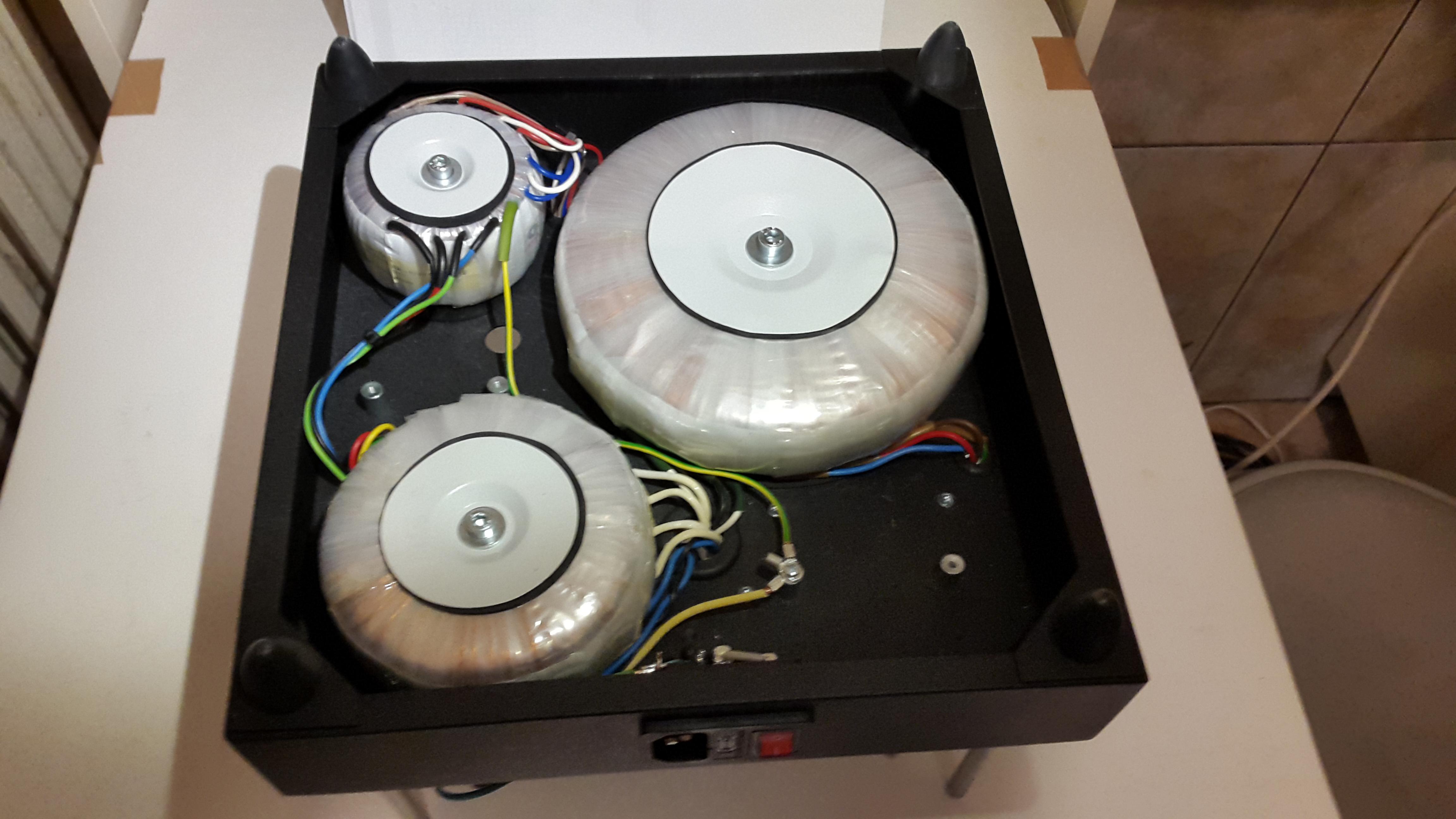

- Power supply was totally separated. one trafo for the main +/- 150V, one for the filaments, and one for the first stage and bias.
- Delay for the main supply, the amp starts with filaments and the first stage/bias, then after 10 min, the main trafo start softly.
- The first stage tail has added a CCS using a 2SK117gr.
The result was an improvement in detail, soundstage and lower response.

That's interesting Victor. For my planned build I am thinking I will use fully regulated power supplies using TomC's maid reg circuit;
21st Century Maida Regulator
Using regulated supplies should reduce the influence of an added CCS but I would still be interested in what you have done to add one to your first stage - do you have a sketch of the changes you made?
Cheers
Ray[/QUOTE]
I don't see the connection between regulating the supply of the first stage and adding the ccs on the long tail phase inverter. But here you are what I have done in that case.

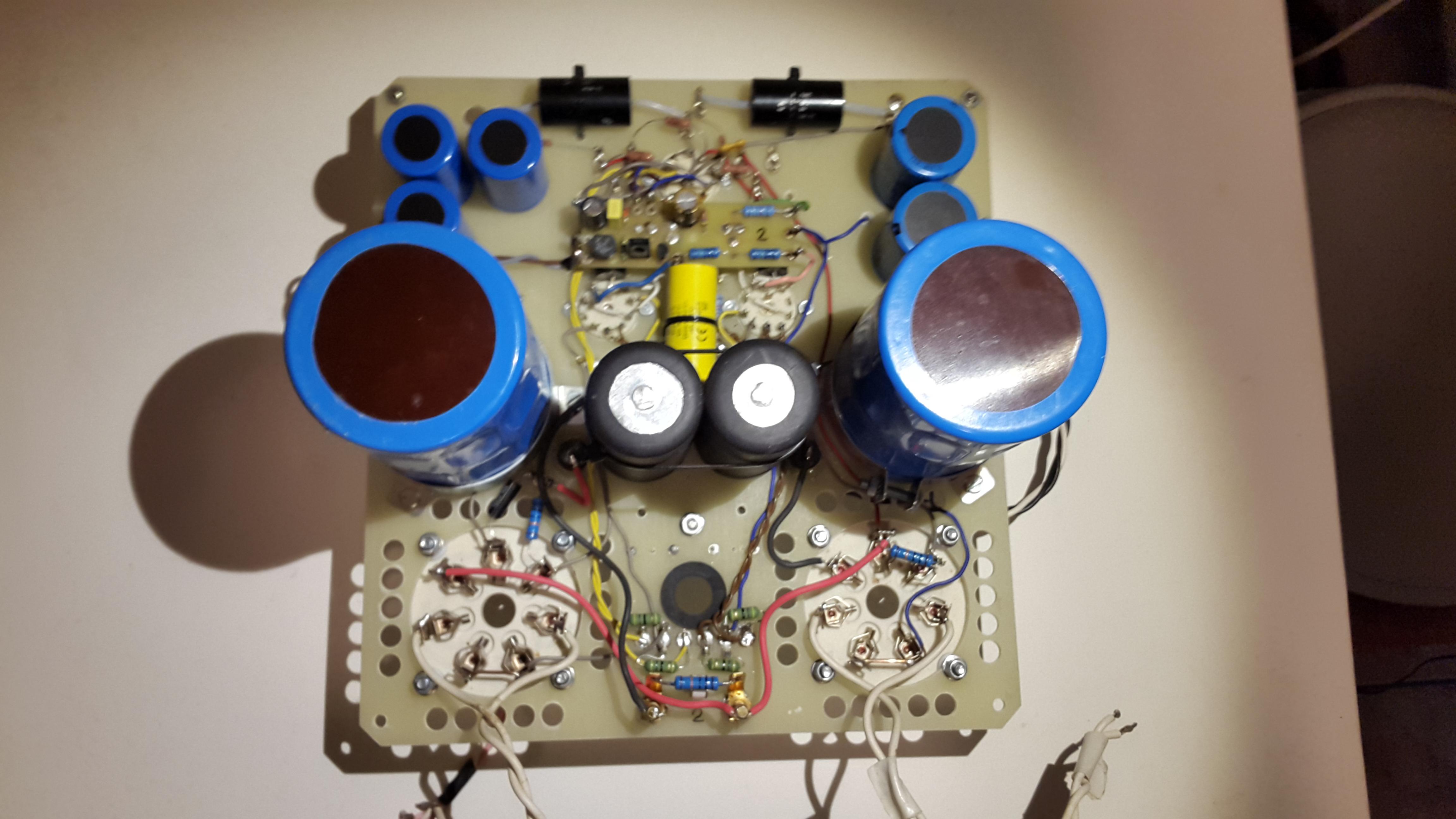

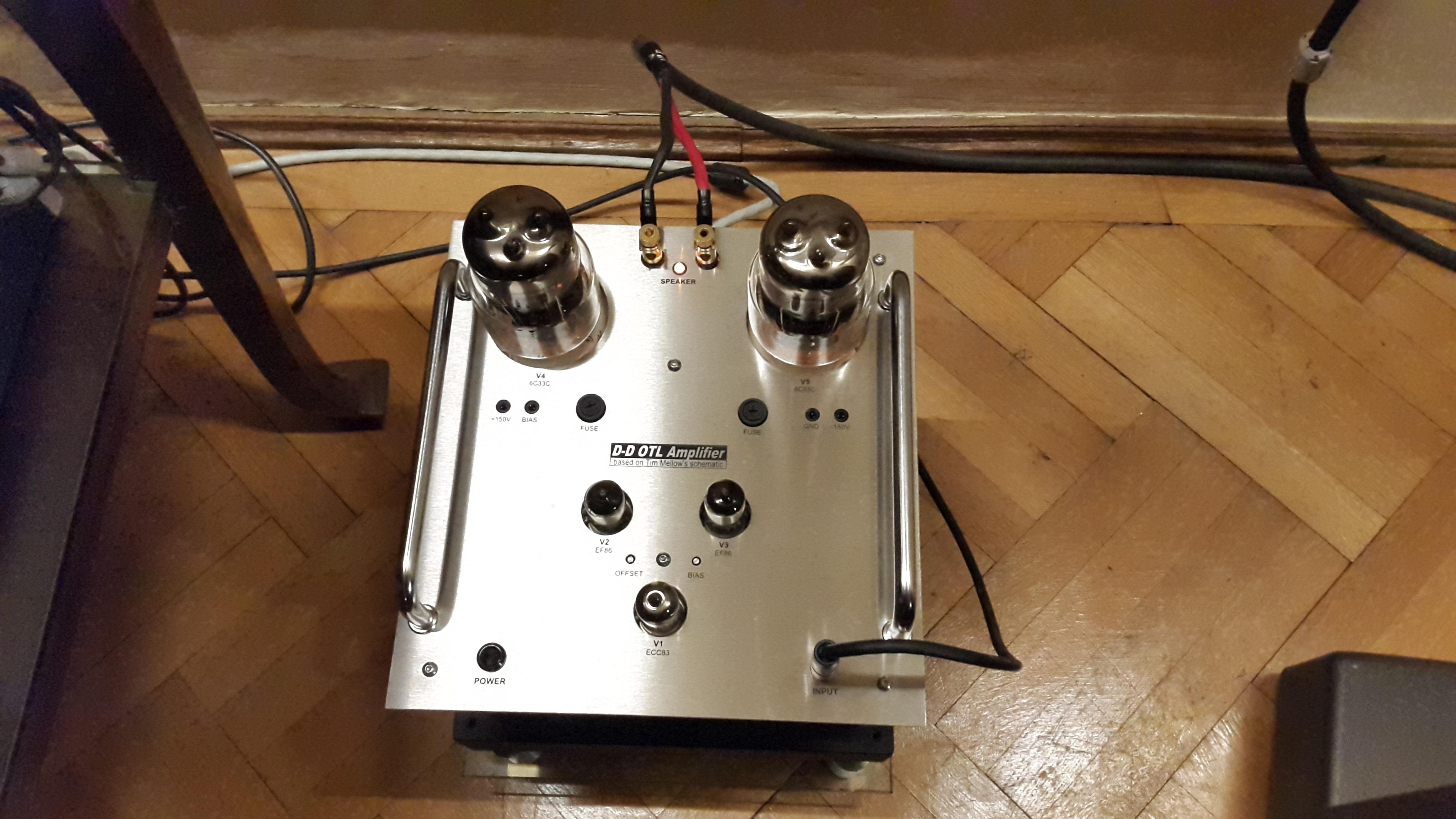

Some photos of the naked thing:

Thanks Victor. I'm not an electronics engineer and it may be that I have misunderstood something; I thought that by regulating the plate voltage you are in essence influencing the current at the cathode. Anyway, thanks for sharing your schematic.
Ray

Nice project Victor.
I am also interested in the possibility of the balanced input to the Mellow OTL (mentioned in the original article) and eliminating the input caps but in my case I have available DACs with balanced outputs using high quality Lundahl transformers so it may be possible as there is no DC present on the input signals. I can use digital volume control (via HQ Player) and/or maybe a balanced attenuator.
I see you have also removed the bias current ammeters and use a low value resistor instead. I plan to do the same and install a socket to allow a multimeter to be used to periodically check the bias current.
The link I included in my post was different to your build in using Russian sub-miniature tubes instead of the ECC83 and EF86s, it is that change I was asking if anyone had tried? I already have the specified subminiature tubes so it may be worth a try.
BTW, I'll be using the amp with 16ohm speakers, which should give it a slightly easier life.
