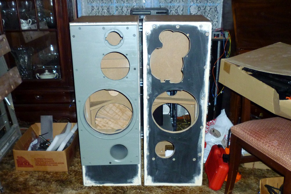

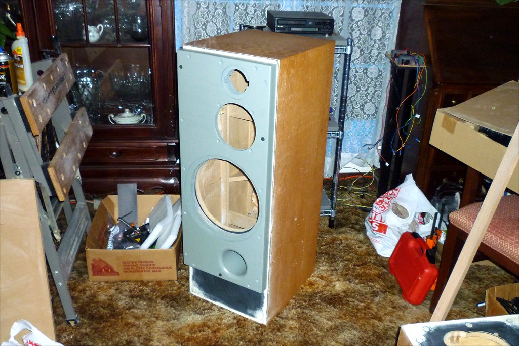

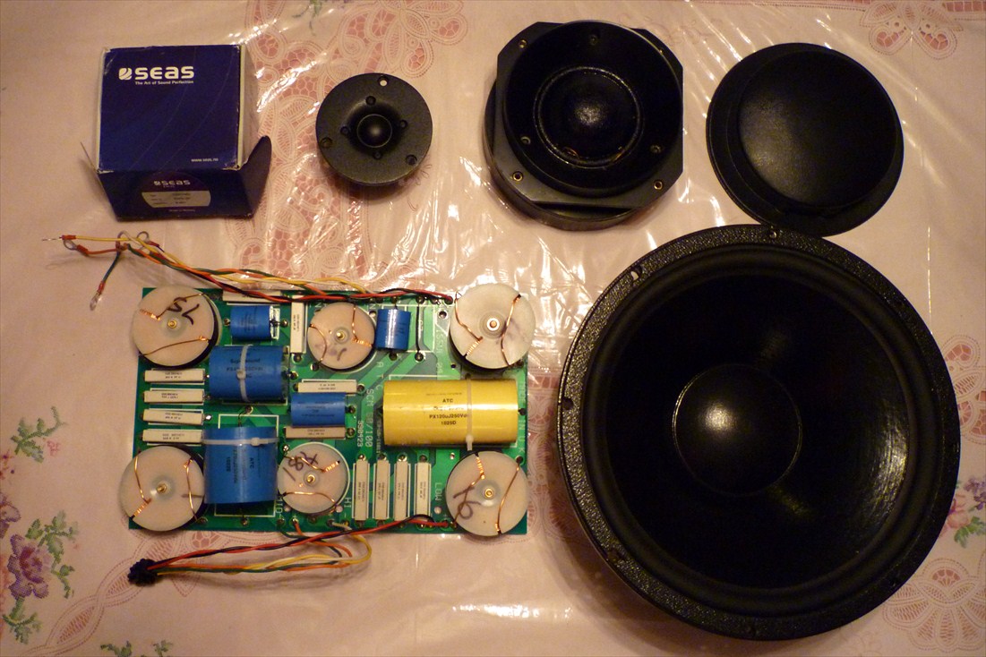

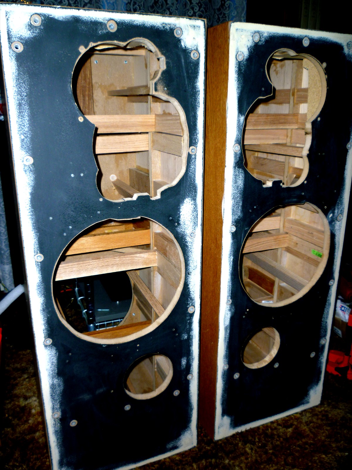

After looking into the cost and complexity of building these crossovers, which I have no experience, I bought that genuine ATC SCM50/100 set that was floating around Agon and Ebay. I have the correct drivers including the Super mids and Seas tweeters. I'm starting to make serious headway into the cabinets. I chose Speakerlab DAS 7 cabinets since they are 50 pounds stripped of the drivers, have approximate style and have an internal volume of 105 liters. Yay! I get to use plenty of extra bracing to get down to 100 liters.
So after about 50-60 hours of improvising my way through it, they are coming along nicely. I chose to use void-free plywood (1.5" thick baffle screwed into the Speakerlab baffle using 16 threaded inserts) and will be lining the back of each cabinet with about 20 pounds of lead to try and balance out the weight of the woofer (28 pounds) and mid (14 pounds). After having weighed the components individually, I figure each speaker is going to weigh about 130 pounds. Ugh! Still not as much as the genuine, which I think are closer to 150.
I found an ATC SPA2-200P 200 wpc amplifier to drive these with. Needless to say I'm antsy to get this done with so I can enjoy what hopefully will be a close rendering of the real thing for 20% the price.

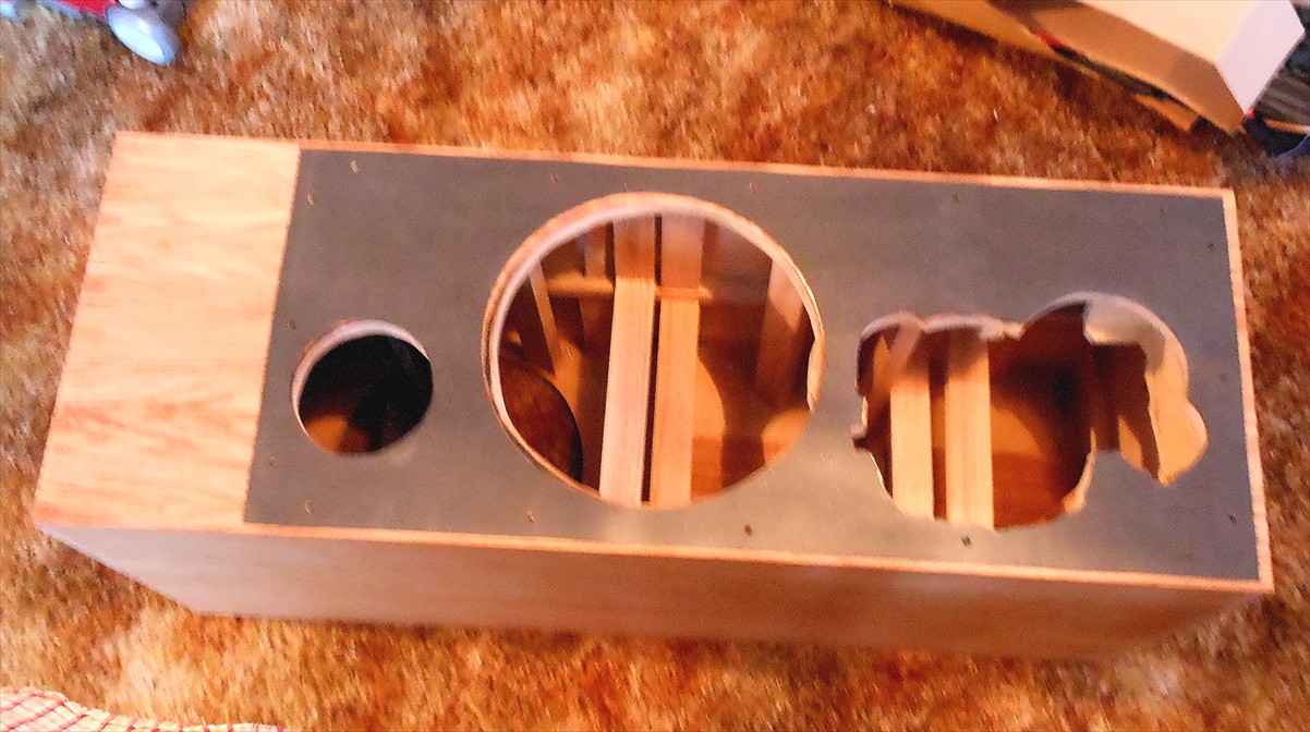

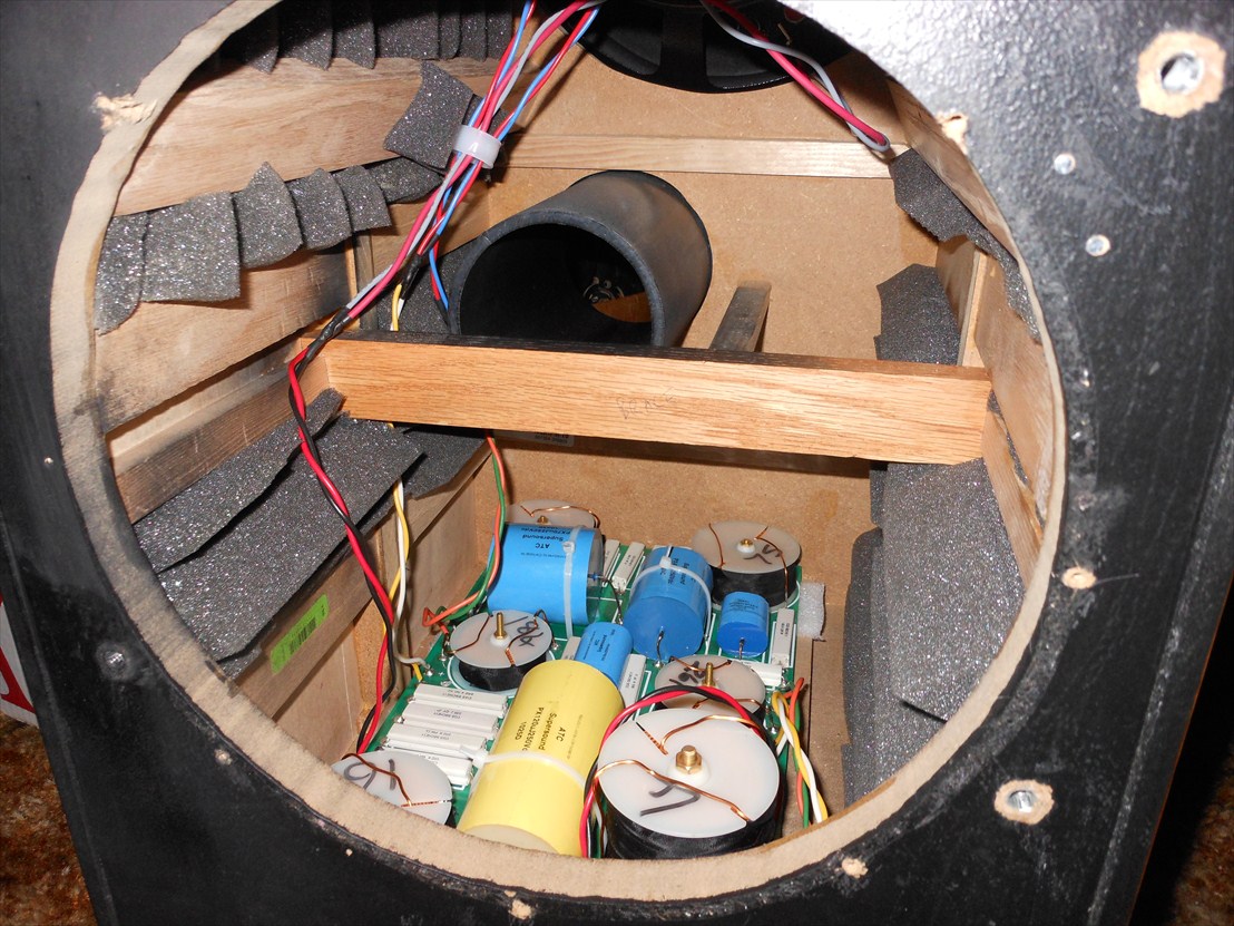

I needed to add 9 litres of fill to each cabinet to reduce the volume to 100L. The DAS cabinets were 107 litres, not 105 like I had said previously, and I almost forgot to include the old speaker holes, which added 2 litres of air. I braced these like crazy, the cabs are 15 pounds heavier now, with about 26 feet of .75 x 1.25" oak strips used per box.
The woofer is a 314 SC Mk. II. Super mid, a correct Seas tweeter with a 3 mounting hole, older style faceplate I custom ordered from ATC. They did the conversion for free. I prefer the looks of the 3 hole tweeter over the 4 hole that is current.
The crossovers are pretty awesome. 10 pounds each. Still having fun even though this project is owning a lot of my free time. I'm hoping to finish within a month.

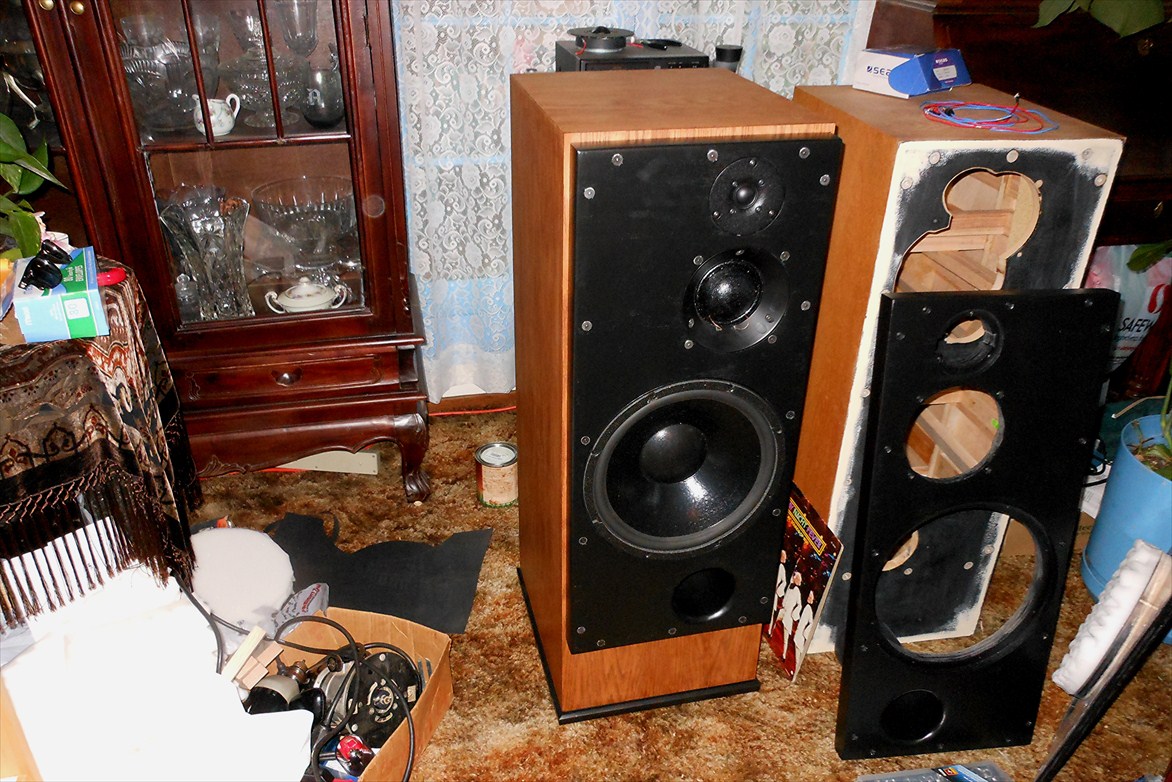

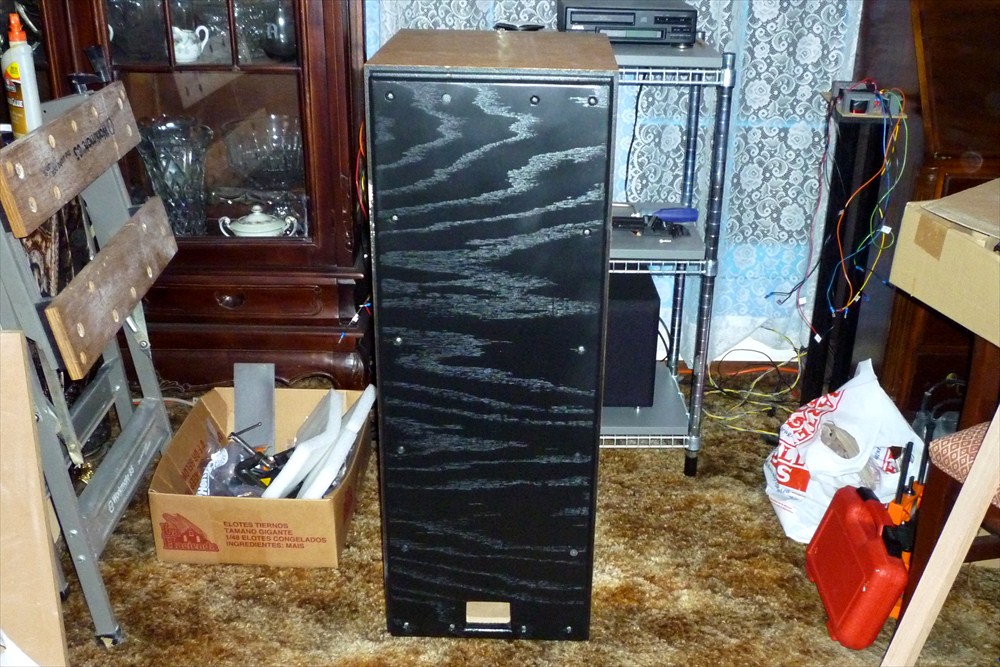

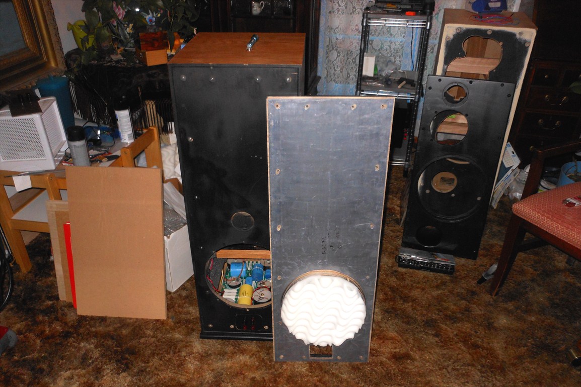

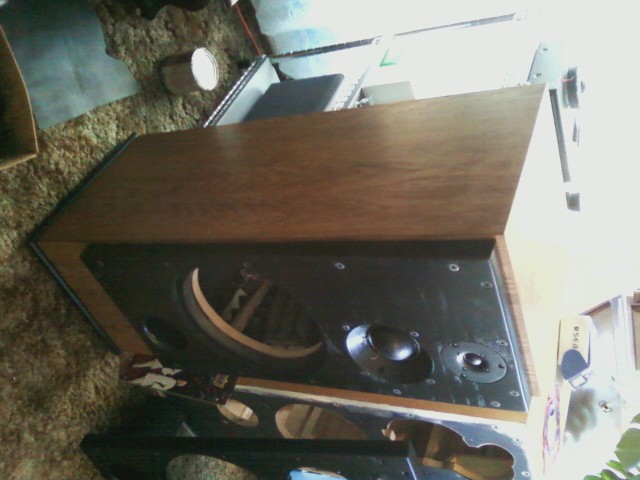

Getting there....Starting to look like I might finish this decade. I'm not thrilled at the plywood grain showing on the baffles. It looks OK. If I was to start over again, I would have used a thin sheet of hardboard over the oak ply to get a smooth finish. I spent hours and hours using different fillers and primers to build up over the grain but it always looked like ***. So I called it quits on that aspect.
I got the crossover mounting holes drilled perfectly. That was worrying me since I needed the placement to be pretty exact. I used pond liner as the baffle seal. I didn't know what to use as my seals until I happened to be at a garden supply store and saw this marvelous black rubber sheet on huge rolls. Twenty feet x 18" strip was only $20.

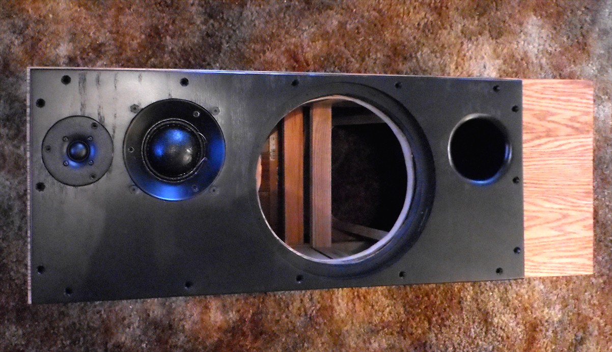

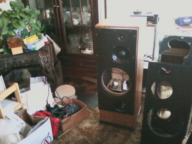

Baffle and base mounted and crossover installed. I just need to get the binding posts attached, drop in the woofer and I will be done with the one anyway. I lined the cabinet walls with wedge shaped acoustic foam.

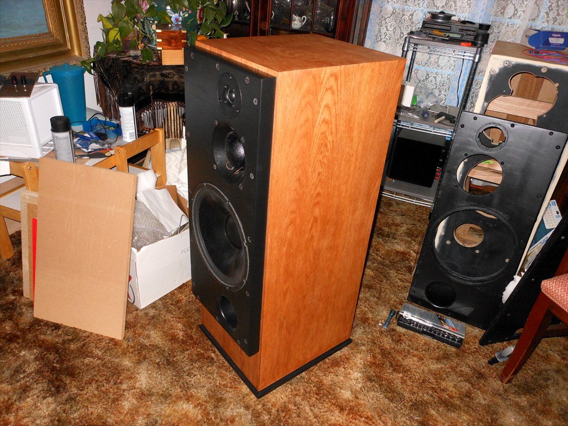

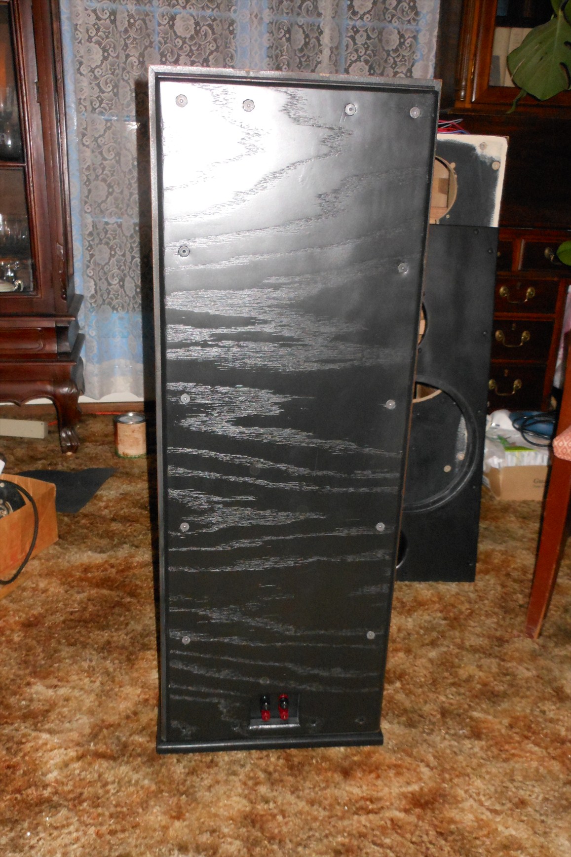

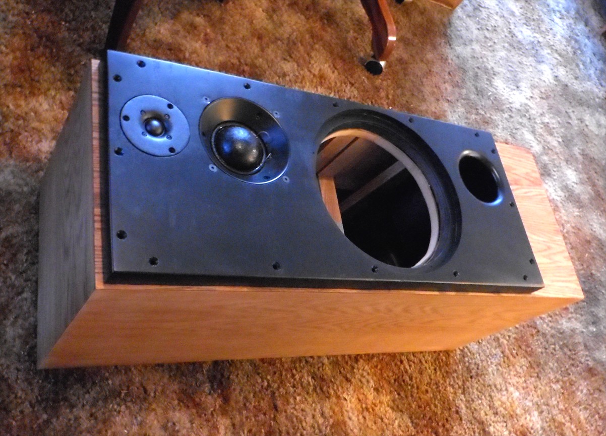

One is done. Seven months of Mondays. Weighs 140 pounds. I must say it looks pretty good for a total amateur.
