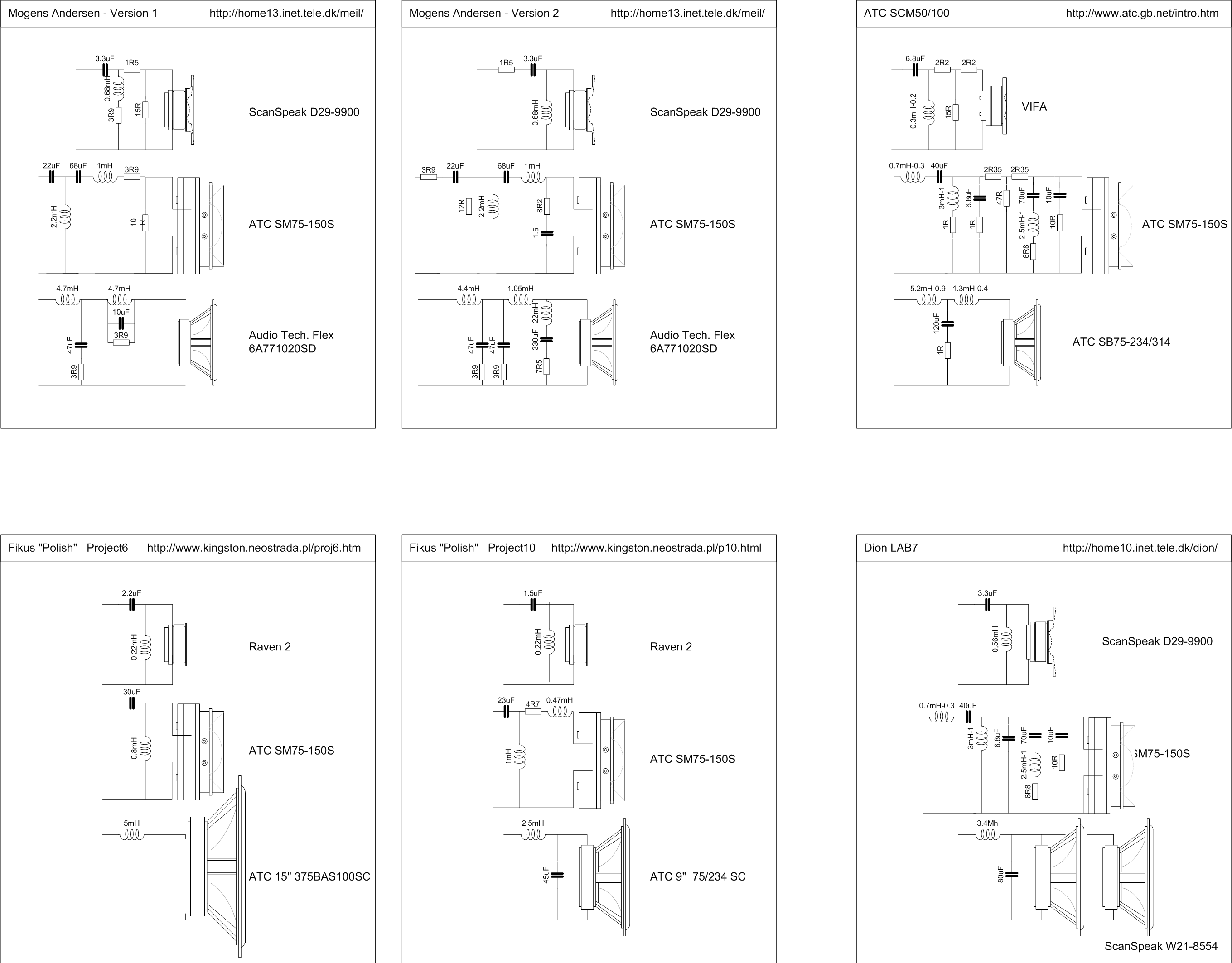

original crossover schematics for clone ATC SCM 100

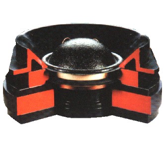

I rember a picture of a cut model of the dome. But I didn't found it now.
Found this on Wilmslow Audios website...
SM75 mid FR isn' flat without EQ, because there are response peak at around 1Khz. The mid is crossed over at 380hz with 2nd order high pass filter that would give 24dB/ octave slope. Using 4th order low pass filter for SB75-234 woofer will work but not that important since what ATC designer did was merely having correction of baffle step.
