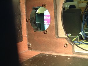

The SCM50/ SCM100 used the old model Vifa Ferrofluid-cooled Soft dome 25mm (one inch) tweeter, which i presume made to order per ATC specification, unkown type/ model - probably similar to D25-TG-05-07. That was before 1997/8??.
The newer model, especially SCM50 SL PT / SCM100 SL PT 3-way passive monitor floor standing system uses Seas Excel either T25C-003 (E036) or T25FC-001 (E006) and for sure not a Millenium T25C-002 (E011).

I am pretty sure for this. See the picture of the tweeter.

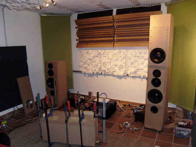

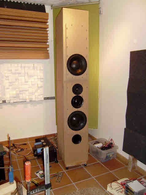

Nice build! Couple questions for you. On the tweeter and mid ATC is using a sort of T pad layout for padding. Anyone know why they use this over something more conventional like an L pad layout?
Also is the top of the mid dome flush with the baffle or is it recessed pretty deep? What is the curvature of the roundover for the mid? Looks like maybe 1 1/4"? Also do you have any close up pics of the dome so I can see how the dome and roundover are in relation? Also do you have response measurements of this driver? Reason I ask all this is I'm using a new 3" mid from Tangband that I need rearmount in a waveguide similar to the ATC but I'm unsure of the dimensions. Here is a pic:

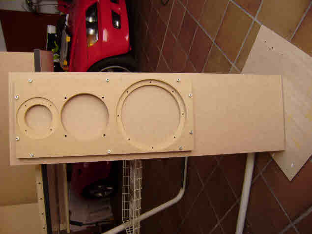

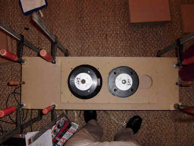

There is a "mini" WG Baffle delivered with the ATC. With this part you can put the driver on the back and the dome doesn't touch the gorund.
But you can remove it - carefully!!
I use the ATC in a selfmade Waveguide.

Thanks for the pics. looks like the waveguide profile is about 1 1/4" or so. With the factory waveguide how much clearance do you think there is between the tip of the dome and the top of the waveguide/baffle face? In other words how deeply recessed is the dome?
