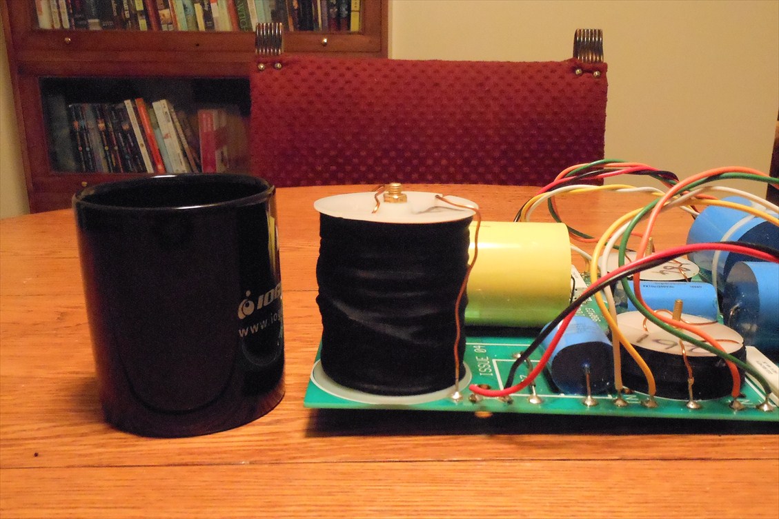

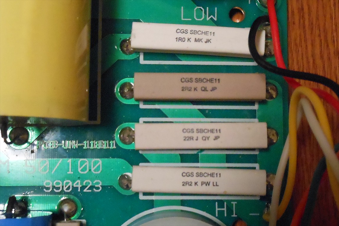

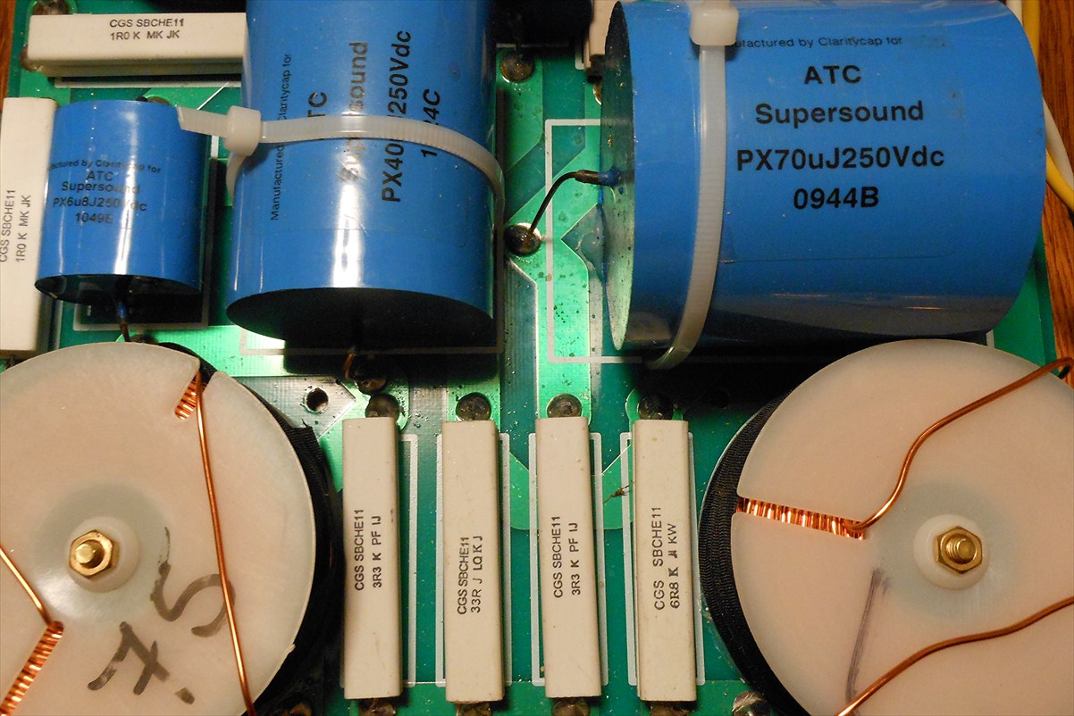

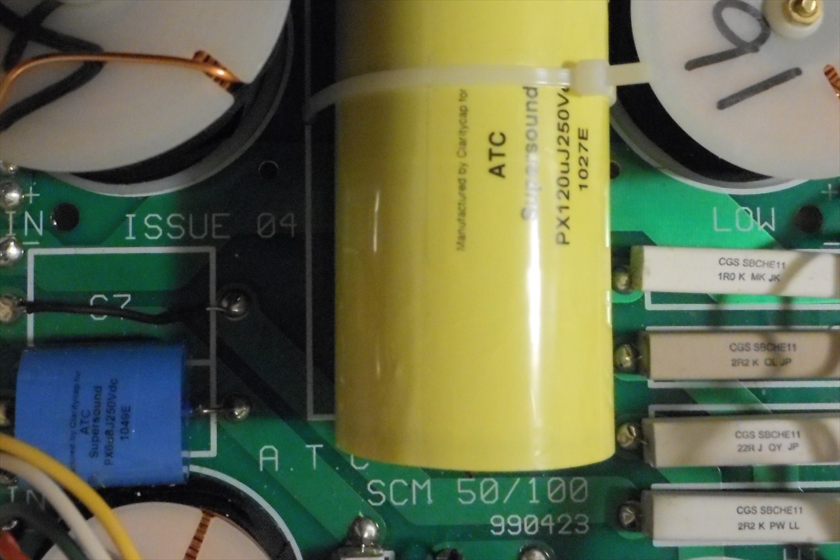

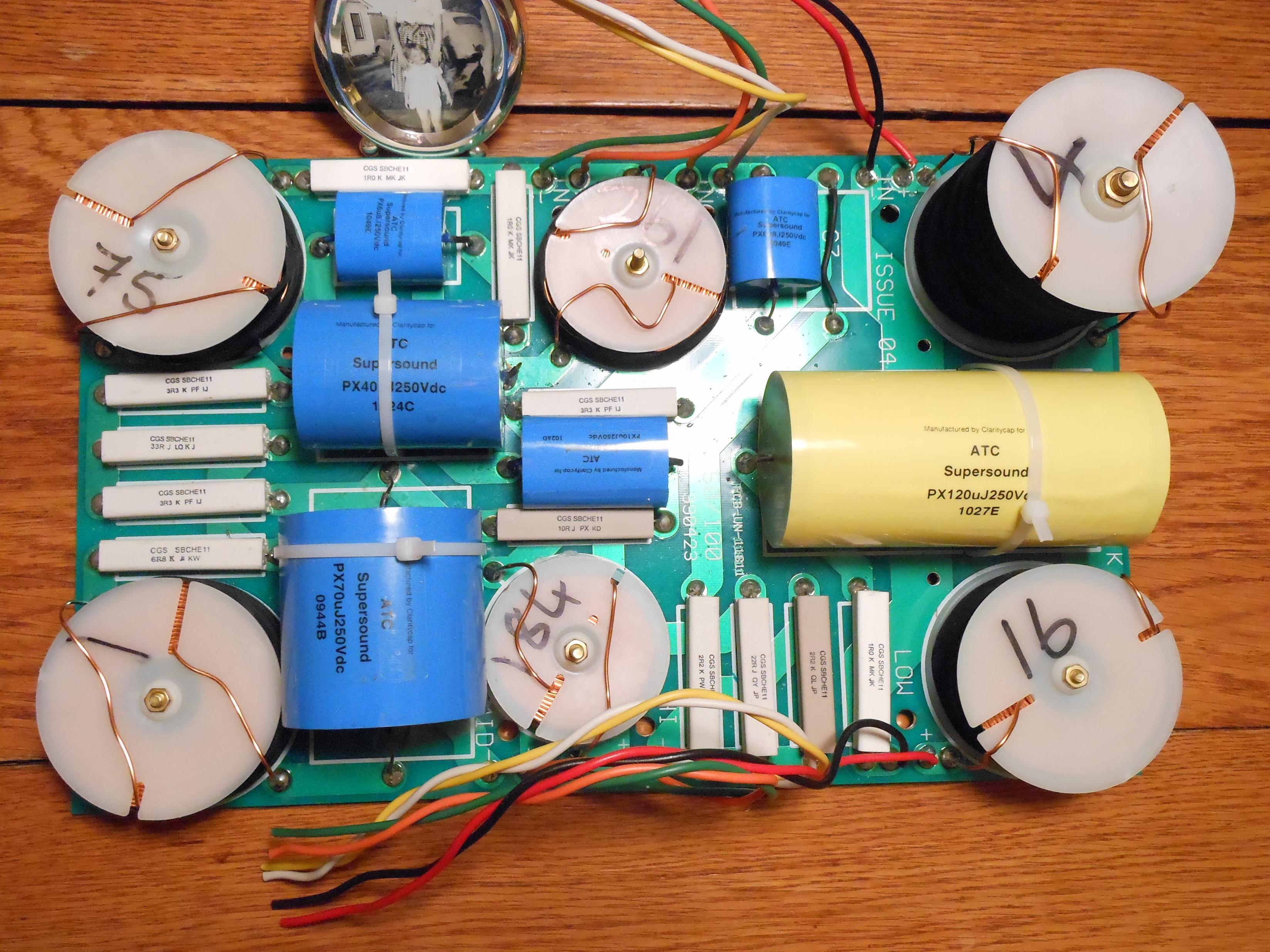

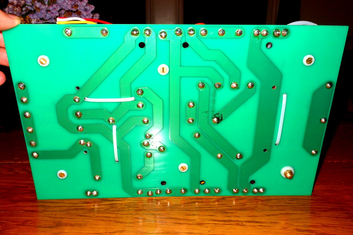

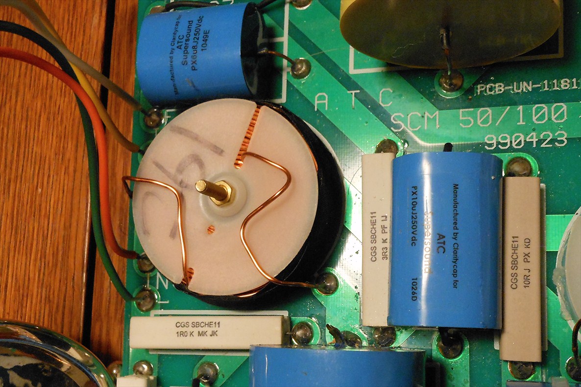

I'm thinking it might be useful for a person wanting to build their own passive crossover to see where ATC laid out the components. I've read where it can be difficult to bring a schematic to life. The bottom of the board shows the same orientation as the top. I just tipped up the board.

Hello ewhitaker!
many thanks for the photos!
But the value of the resistors is different than the schematic of posting 3 of first page.
Do you think that there is only a adjustment for the Seas tweeter?
Can you measure the exact value of the coils?

Seyed, A representative at Flat Earth Music (North America ATC distributor) told me the crossover is the same with both tweeters. I would be happy to measure the coils, but can I do that when they are soldered into the circuit? Possibly the schematic is a different generation than the design I have? If there is a way to measure the inductors in circuit, help me through it and I will do so.
Helloewhitaker !
Unfortunately you have to unsolder the coil to measure it.If you have a multimeter with optional to imeasure inductive .

I am guessing the values written on the coils are the inductance values.Helloewhitaker !

Hi ewhitaker,
If it would not be too much of a bother, could you take another picture of the PCB from the underside but ideally with light shining through? It makes it easier to get a sense of the two traces - top and bottom. Not sure if this would work, but holding to a window might work.
Cheers and thanks for posting the pictures - already I am seeing some differences with the your xover and the published one.
Hmm strange.. I cant get the first pic to open bigger, the one with the whole board, maybe the link is broken? Any chance of reposting it so we can work out the circuit?

The whole board picture opens up when I checked. I didn't resize the original image so if the icon at the lower left of the enlarged picture is clicked on, it really opens up and defeats the need for looking at the other images, IMO.
Really odd as it does not on my computer and it did yesterday (the pic of the front of the board not the rear). All the other pics open up no problem. Any chance you could post another link to that pic so I can try to work out the board?The whole board picture opens up when I checked. I didn't resize the original image so if the icon at the lower left of the enlarged picture is clicked on, it really opens up and defeats the need for looking at the other images, IMO.
