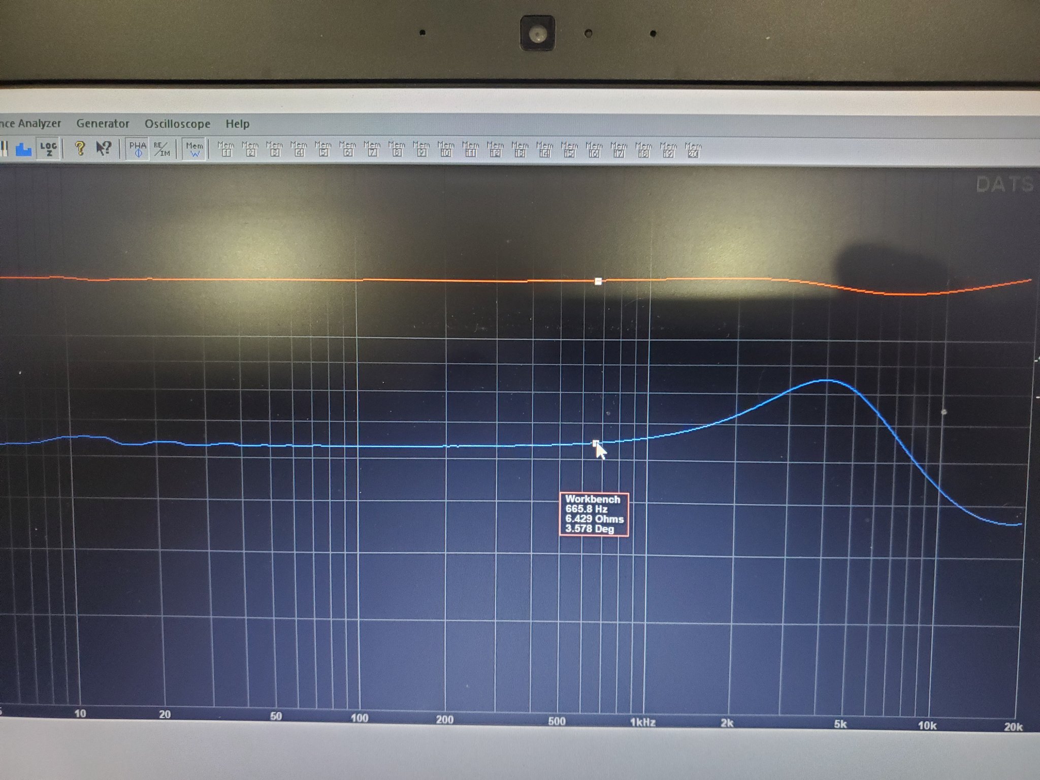

Well my diy planar magnetic panels are 6.5 ohm impedance across the the frequency band from 10hz, to around 10k, then rise slightly to around 7.5ohm. Out to 20+. And that is measured impedance. Just want to try to match everything up. It is really amazing how flat planar magnetic impedance curves are.
But I'm leaning towards the 6.6k/8, for the actual 5360. Am I wrong to assume better to error on the high side?

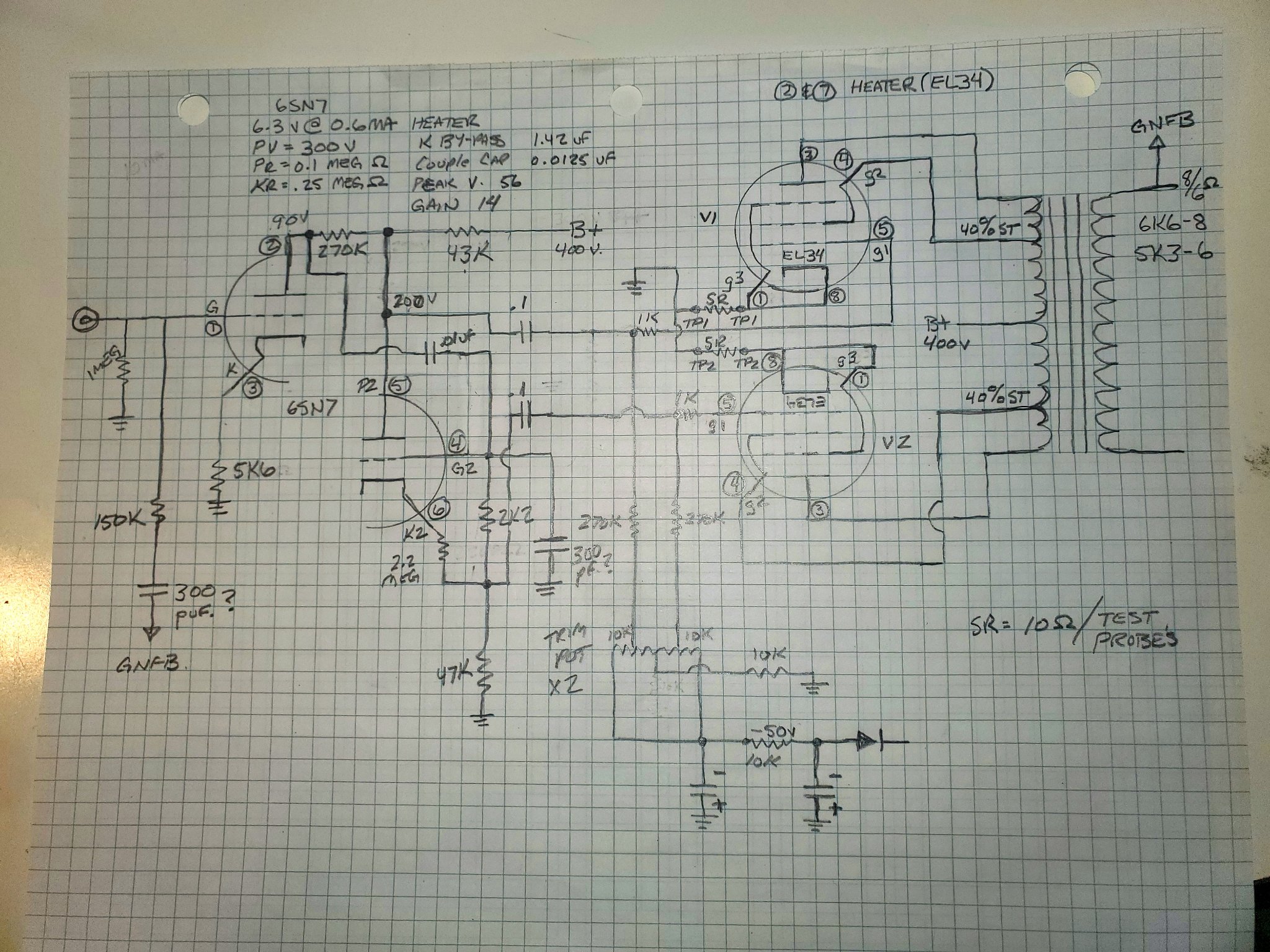

Somewhat unrelated to my original post, just did a deep dive into the schematic for the organ these came from. 48 tubes!, wow. Lol. So shouldn't have any trouble with a pair of el34. But also scored some 6550s so looking at those?

Yes indeed, already ordered a pair of OTs. And have the diodes already. Just looking at thermistor to limit in rush current a bit. Also debating using cathode bias, or fixed bias. Thinking about fixed bias for each el34, just to balance them more accurately.
The 270K on the 6sn7 gain stage needs to go to b+. You want to apply the GFB to the cathode of the 6sn7 just to not mess with the input impedance. It may just mean you need to ground the positive side of the output transformer and take GFB from the negative side. Or flip the power tube control grids.
Also this will not have as much gain and make need 5V for full output once you have appropriate negative feedback. Organ amps used a lower gain approach to keep hum levels low in many cases.
Thank you so much for your help. I thought about using a different driver stage, but my preamp puts out quite a bit of voltage . (Carver C1) and I already built " color preamp" Skunkie design. I may mod. It put be a higher output preamp for these.
And should the 270k on the 6sn7 first plate go to the 400v with out the 43k. Wouldn't that make the voltages on the plate higher? 310 ? No first voltage drop?
