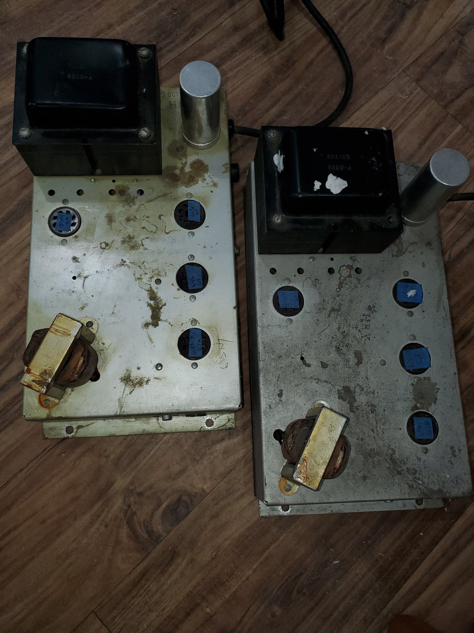

Well, I switched the tubes and measured them again. And one tube is the low current draw. Not the socket. With the bias set at 40ma on one tube. The low one would be at 25ma. Oh, and I ended up using matched sets anyway, I didn't get a matched quad. So I replaced the set. Much better, only differ a couple ma.
