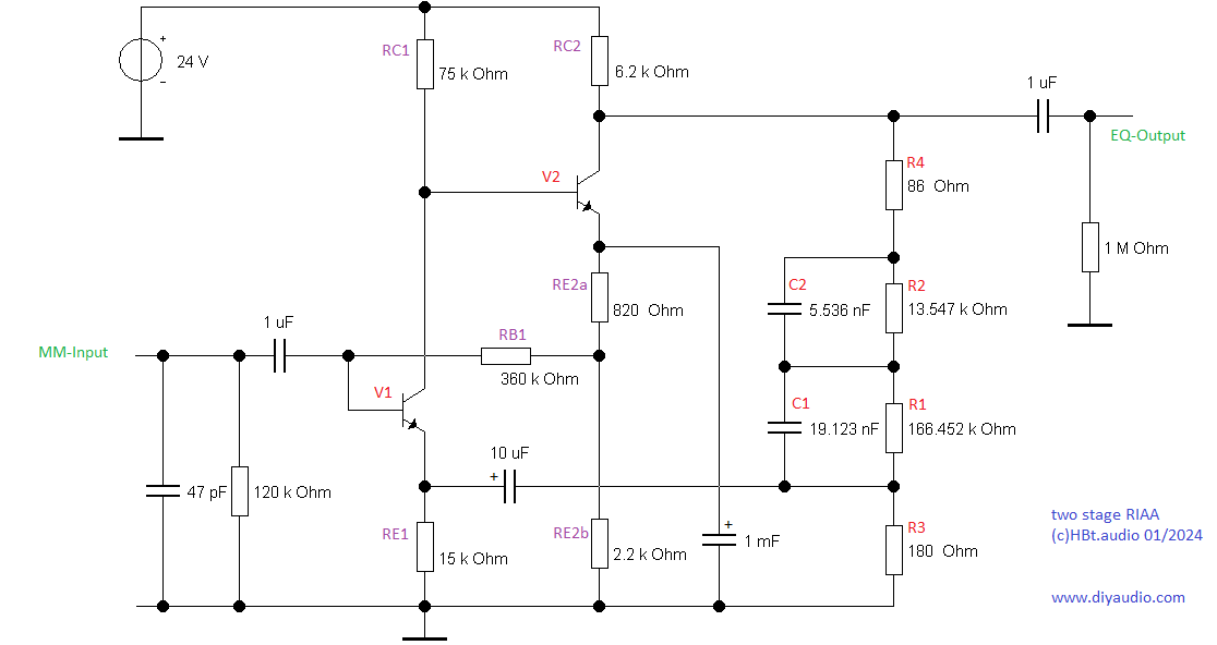

Oread - a DIY MM phono approach

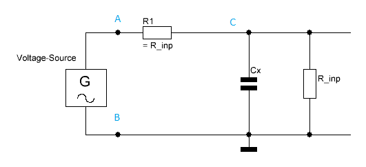

How to check Cx size with home remedies?
Our big advantage is that the input impedance is not unknown. We approximate it according to the sketch, Z_inp(jOmega) = 1/ ( 1/R_inp + jOmega*Cx). We have a function generator and an oscilloscope as well as an ohmic resistor at our disposal. With the assumption that Cx, but above all R_inp (the real part) is frequency-independent, we can already get started.
We choose R1 = R_inp (=47kOhm) and thus build a simple voltage divider, we can neglect the internal resistance of the generator (if it is significantly smaller than R1, 50 Ohm is it).
As a first step, we choose the voltage U_AB sensibly, because we do not want to overdrive the EQ, but at the same time maintain sufficient reading accuracy on our oscilloscope screen. U_AB = 200mVpp from this follows U_CB = 100mVpp -> we obtain an equivalent voltage source with the internal resistance of R_inp || R1 = 23k5Ohm, as well as a source voltage of 100mVss = 35.36mVrms. We check whether this is the case between f=100Hz and f=1kHz. We don't have any sophisticated measuring equipment at our disposal, so we make do with the fact that a simple first-order low-pass filter should be present.
We know neither the phase angle nor the current, virtually nothing but the voltage at the complex input impedance Z_inp, but that doesn't matter. Because now we increase the signal frequency up to /till U_CB from 100mVpp to 70.7mVpp
Now we increase the signal frequency until U_CB has dropped from 100mVpp to 70.7mVpp and note the frequency.
We calculate a C, but not Cx:
C_test = 1/ [ (2*PI*f_test) * (R1||R_inp) ]
We also need to remember and know our measuring equipment and the data of the test leads, probe, etc. typical for a scope is an Rp of 1MOhm in parallel with a known or unknown Cp.
Rp must of course be much larger than R_inp if we want to neglect it, but Cp, all parasitic capacitances that we (unknown) connect in parallel to our test object increase C_test.
Cx is sufficiently accurate = C_test minus the sum of all parasitic Cp's at f = f_test. This is one way to determine Cx at home with simple means and with sufficient accuracy.

Also, in the schematic they connected a 4.7pF (4p7) capacitor to the input, which doesn't make sense when there's already something around 280pF present. Maybe someone had problems with decimal points back then? 28 pF would be more in line with our measurements/simulations and then adding 47 pF would be fine.
I suspect that Elektor Cx could have investigated in the manner described above, but in the haste may have forgotten all parasitic influences. Maybe they tried to oscilloscope voltage and current and use XY mode to get the angle information from the Lissajous figure. They may have approximated using the idea |phi| = 45° ... Here you can make more mistakes than you realize.
Today we cannot possibly say what the masters of the late 1970s did in the laboratory - but we can measure it ourselves. It is obvious that there must be an error in the publication. But so what; my masters knew exactly what they were doing back /in time then, I remember them very fondly.

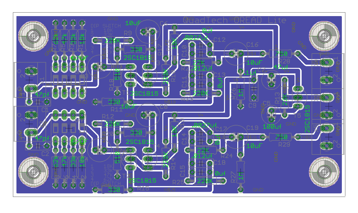

Very interesting, the supposed high input capacitance never caused any problems for me and now I know why, it was never real! So I decided to experiment on my own, I have a DER-EE DE5000 LCR-meter so I simply connected it to my preamp, it was powered on, selected 10kHz frequency and what do i get? The short cable used was 33pf the meter showed 64pf so 31pf left for the input capacitance. I measured the LCR meter with my oscilloscope and it puts out 550mV RMS 10kHz sine wave with these settings, a bit high but not unreasonably high. The preamp output was not connected to anything so I did not explode my tweeters.
Reactions: hbtaudio

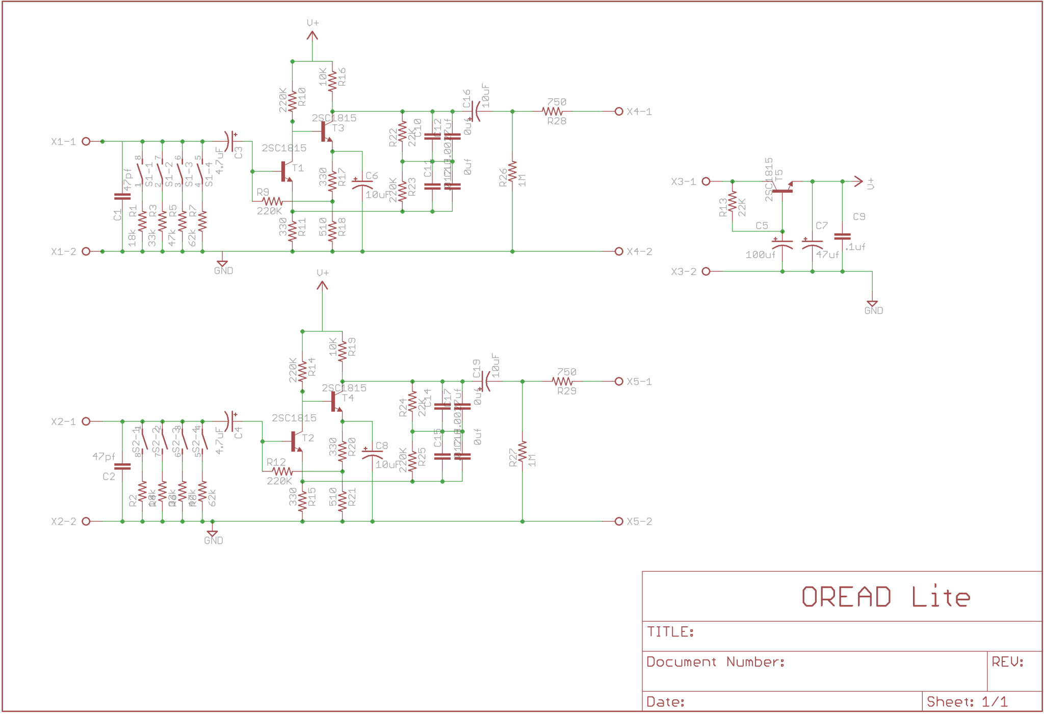

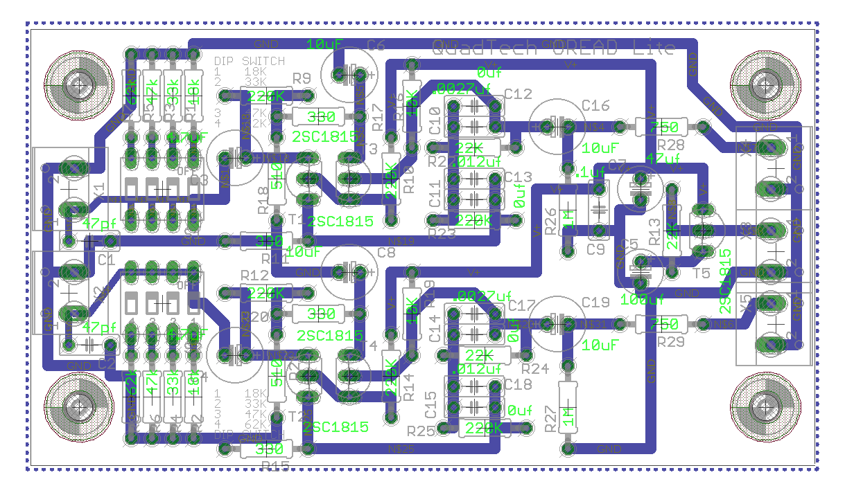

Hello "quadtech",

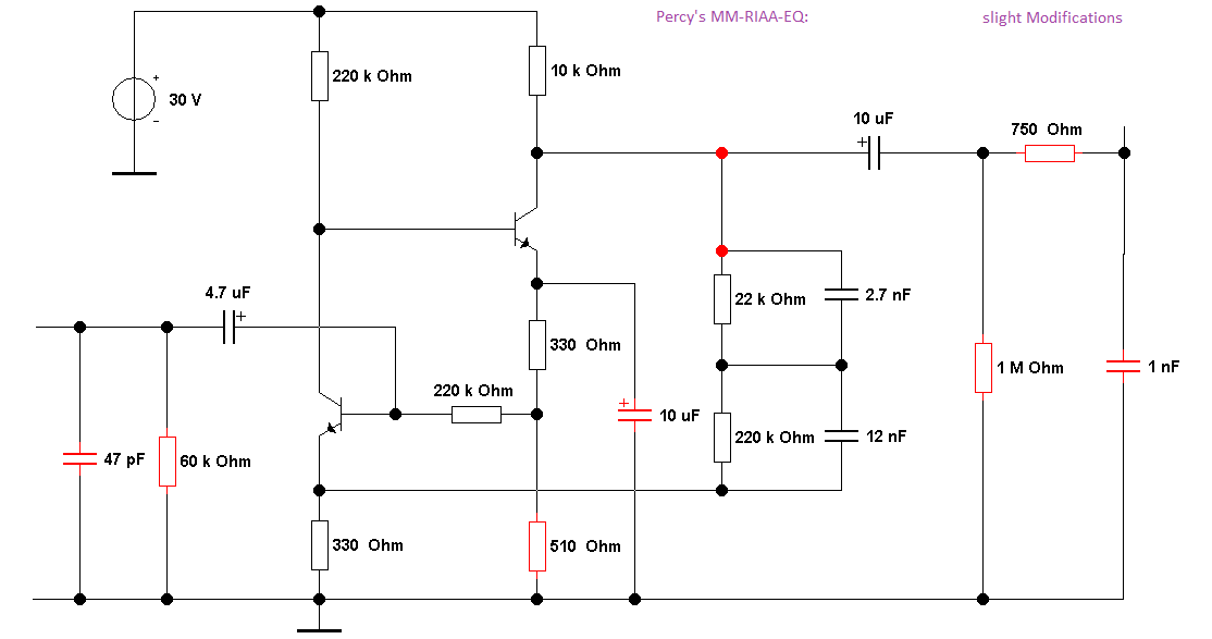

percy" will be pleased - you have designed a nice layout for his circuit, so it's no wonder that you found the source.
From the discussion thread there, a completely different exemplary dimensioning has emerged - which comes 100% from my brain and is based more on an ancient Valvo dimensioning.
What do we do now with your beautiful implementation? Post it again in Percy's thread!
Here again OREAD light:
