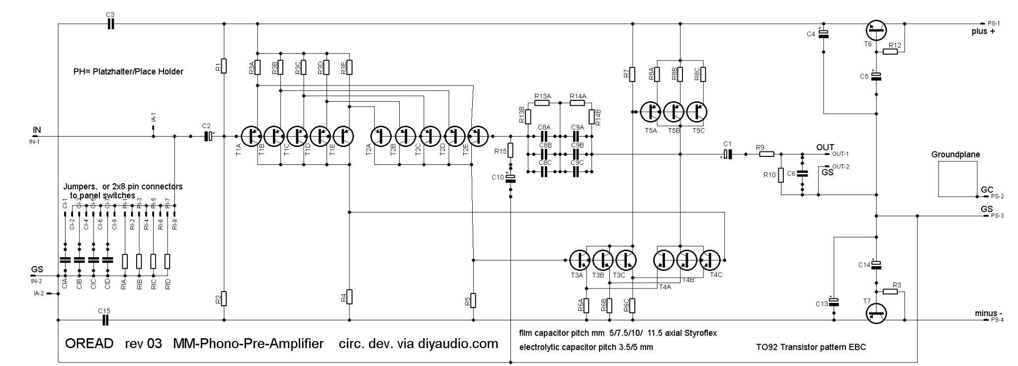

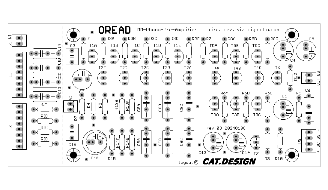

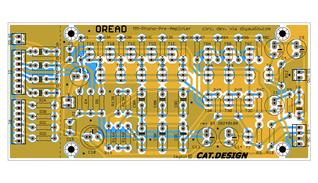

I optimized the board a bit. Various designs can be used for the film capacitors with pitches of 5, 7.5 and 10 mm as well as axial (Styroflex) capacitors up to 12mm. Radial electrolytic capacitors can have a pitch of 3.5 and 5 mm and max.12 mm in diameter.
(One don't actually need 47µ for input or output capacitors. 4.7µ is sufficient and fits easily as e.g. WIMA MKS2.)
The circuit board contains resistors and capacitors to adapt the pickup used. These can either be selected/connected by jumpers, or the contacts can be used to connect external selector switches, for example.
If one don't need or want that, one could simply ommit the parts or even cut off the circuit board along the dotted line and use connector IA as the input.
There are ground planes on both sides that are connected to each other, but otherwise have no contact with the circuit. They can/must be connected either to the signal ground or, if used, to a metal housing and suitable ground routing.
The cost would be around €50 for 10 boards, including shipping. In addition, there may be Customs fees of an estimated €10 if the package is not waved through directly. There are further shipping costs for shipping the individual boards to interested parties.
So you should expect a total cost of around €15 for a set/2 boards.
But before anyone place an order, there might be other suggestions, designs, or someone might find a mistake, etc.

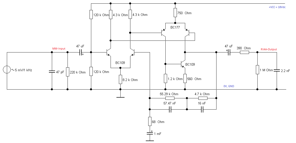

The routing matches the circuit, this is monitored by the PCB software. However, I transferred the circuit from the working LTspice file to the PCB program by hand. I don't see anything wrong, but when you look at your own drawings, sometimes you just miss something. It would therefore be good if the people involved here also check whether the circuit diagram is OK.

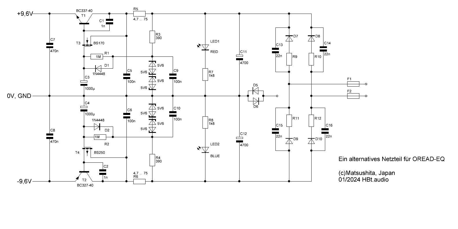

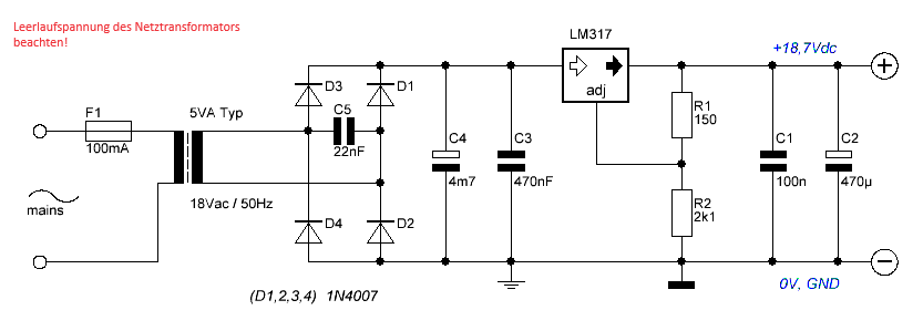

Via a power supply unit
The circuit is very simple, it is not complicated and relatively easy to understand, but at the same time flexible - and that is precisely the intention.
Personally, I would operate both channels with an external power supply of 18Vdc or slightly more, namely 18.7Vdc. So unbalanced - with an LM317 voltage regulator, a charging capacitor of 4700µF/35Vdc, a suitable bridge rectifier, an 18Vac 5VA mains transformer ... and so on.
It is important that the mains transformer cannot be subject to magnetic interference and that it does not hum mechanically and possibly cause its entire environment to vibrate mechanically.
So a little more design creativity is required here than when designing an electrical EQ alone.
The circuit is less half of the battle,
the rest is the challenge!
HBt.

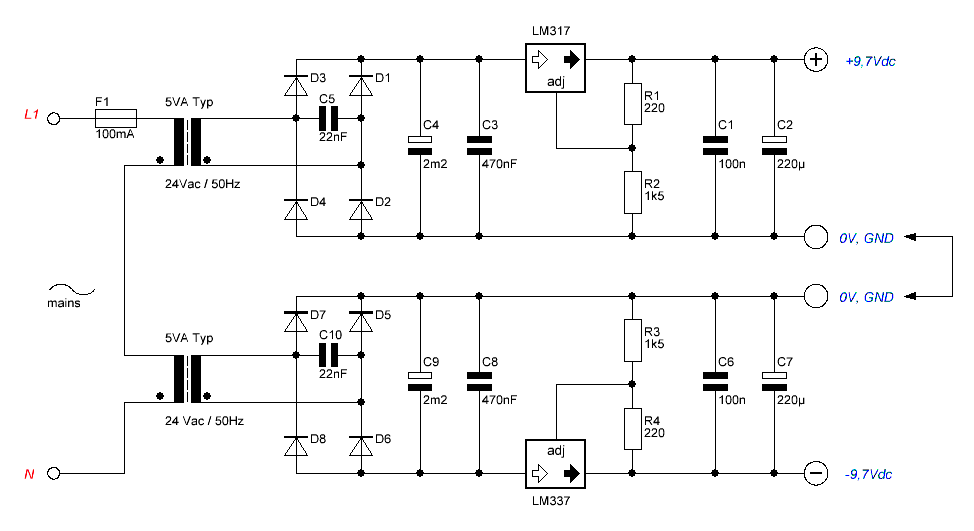

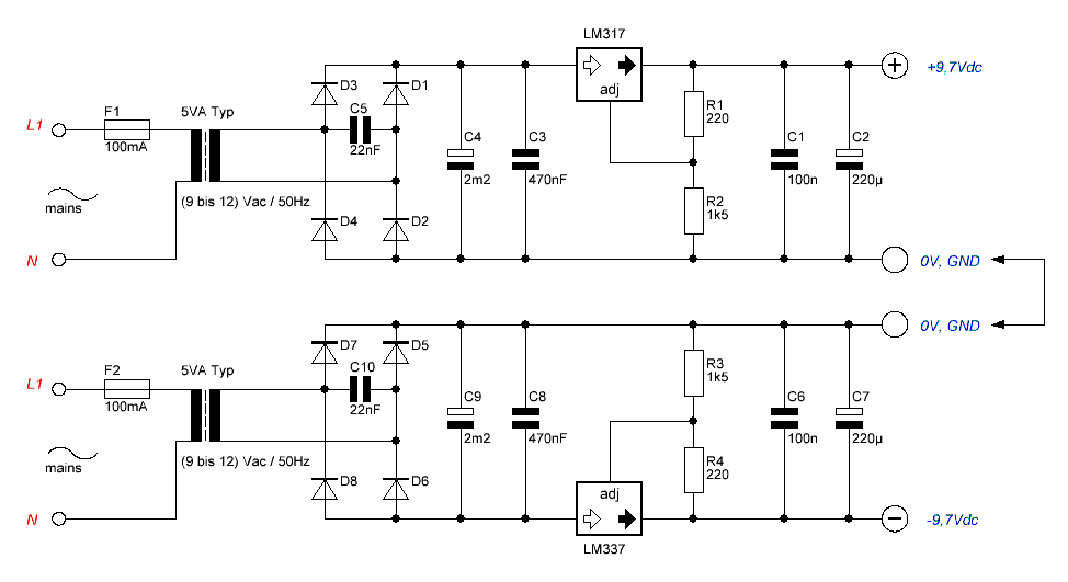

Quick and very simple PSU
The dielectric strength of the electrolytic capacitors should be 35Vdc
and of course the voltage regulator have a small heat sink. A secondary winding with 15Vac could be sufficient for the mains transformer, i.e. the rectified input voltage of the LM317 regulator should be around 22Vdc to 24Vdc (plus ac-ripple) under load - the tiny 5VA transformer works almost at idle.
It's only a possible example for both channel at once.

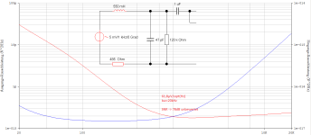

Noise

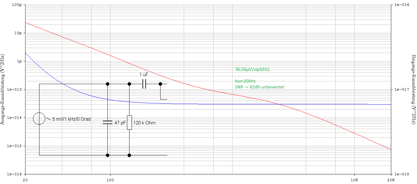

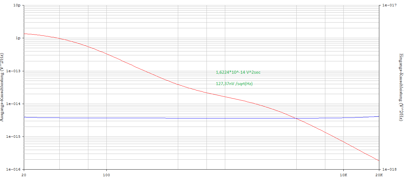

I have three bags of the following old small signal transistors 2N2484, BC177 and BC109. Fifty of each, manufacturer unfortunately CDIL - I'm curious to see if they come close to the old known specifications.
Used in the OREAD-EQ, this housing shape certainly looks very chic and oldschool - it certainly simulates extremely promising.

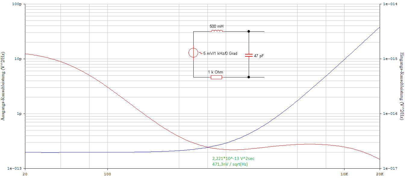

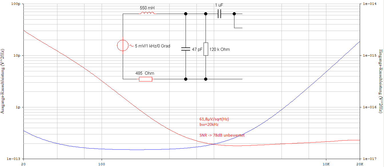

See for yourself, even with the tiresome R-L input combination as a poor MM replacement, I'm guessing a rated SNR of at least 86dB, at least ... now I have to set up a test circuit again 😉.
HBt.

In this case, the input pair should definitely be selected for maximum hfe because of the relatively large IC of 500µA dc - due to the chaotic shot noise at each PN junction, the path resistance. In any case, the C type is used for our /my present dimensioning proposal*, and C is also written on every small TO-18 cylinder.

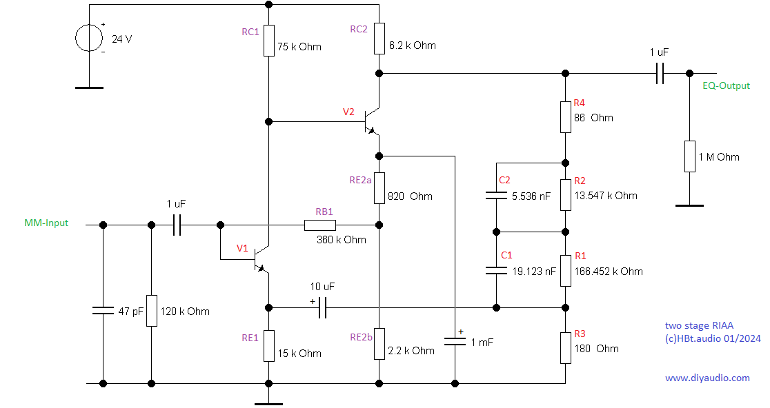

Can we call the simplest, two-transistor version OREAD light ?
