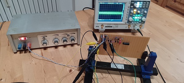

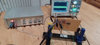

OREAD works 🙂
measured, overlapped, listened to with headphones (turned up to maximum!)
I couldn't wait!

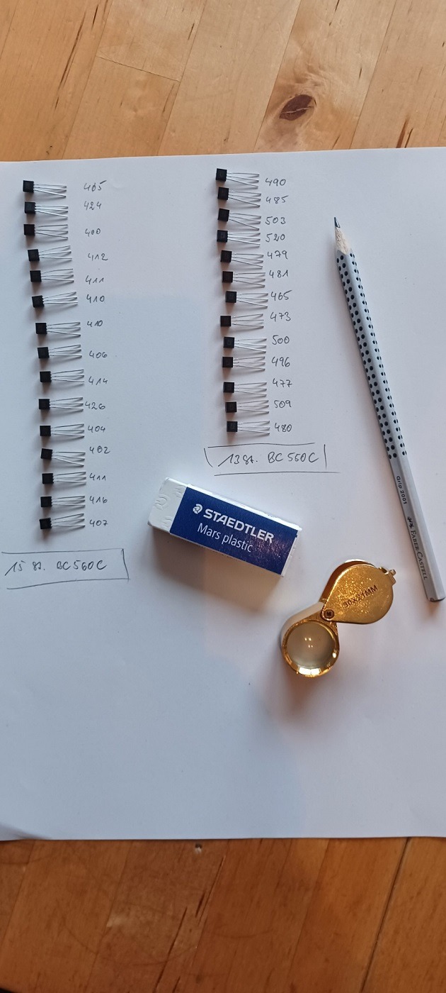

To do a test setup with the good old BC560C and BC550C. I quickly determined hfe and started soldering. Please bear with me regarding the flying setup.
And the biggest surprise is:
no disturbing or even audible shot noise. Of course it is there, but not really significant. Roughly speaking, the unweighted SNR is already >76dB.
A proper layout and an RF-tight shielding housing and so on, and OREAD will be a success. I am already very satisfied with the first step.

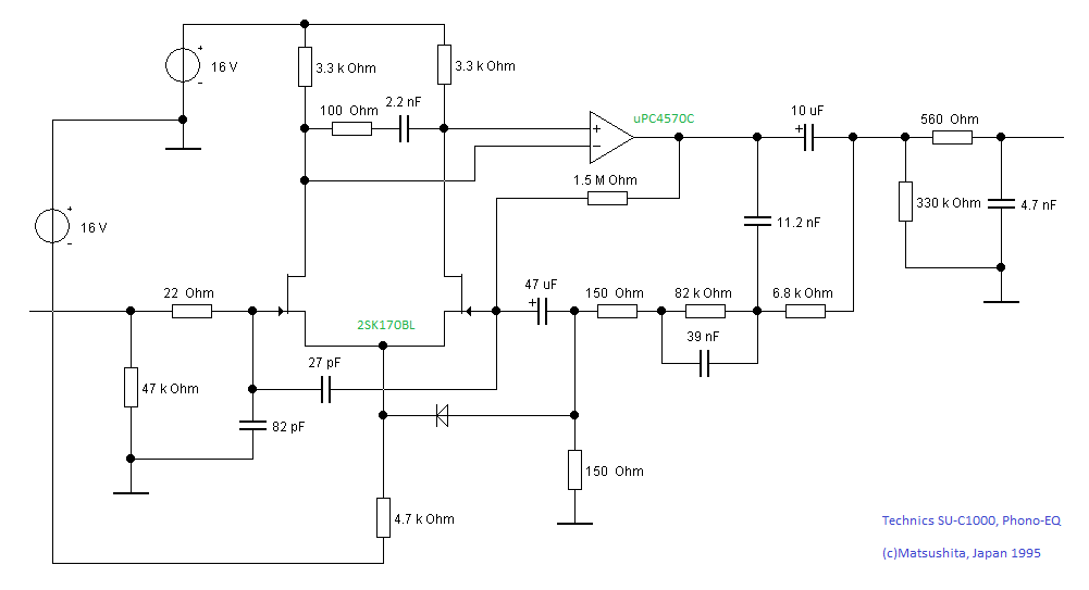

A final illustrative example concludes this excursion into the world of jFet's
The specifications are identical to the previous example, but here the clipping resistance / strengh is also indirectly specified as >34dB (f=1kHz).
A jFet input pair has been common practice for (four) decades ...
The integration of the coupling capacitors in the negative feedback loop can be seen very clearly (here as an example) and much more.
More circuit examples will not follow from my side on the subject of jFet. OREAD is fully BJT's.

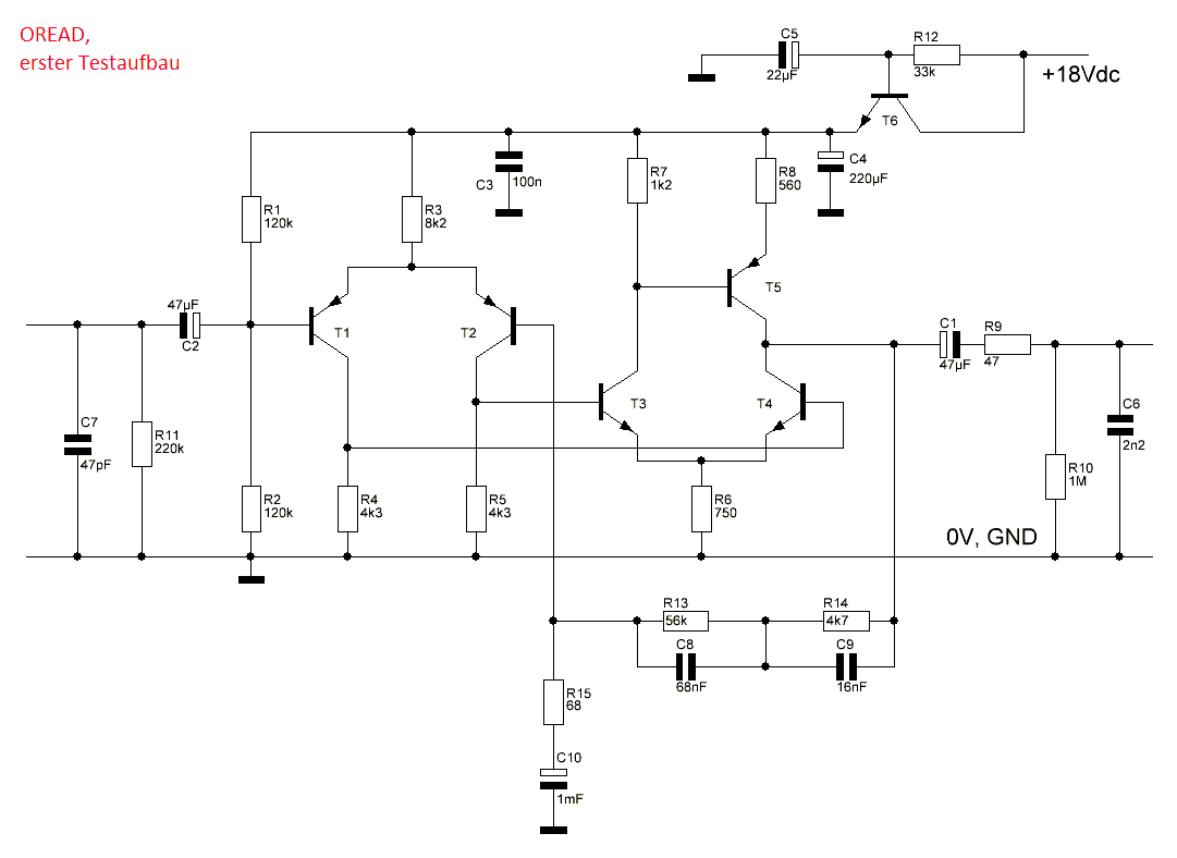

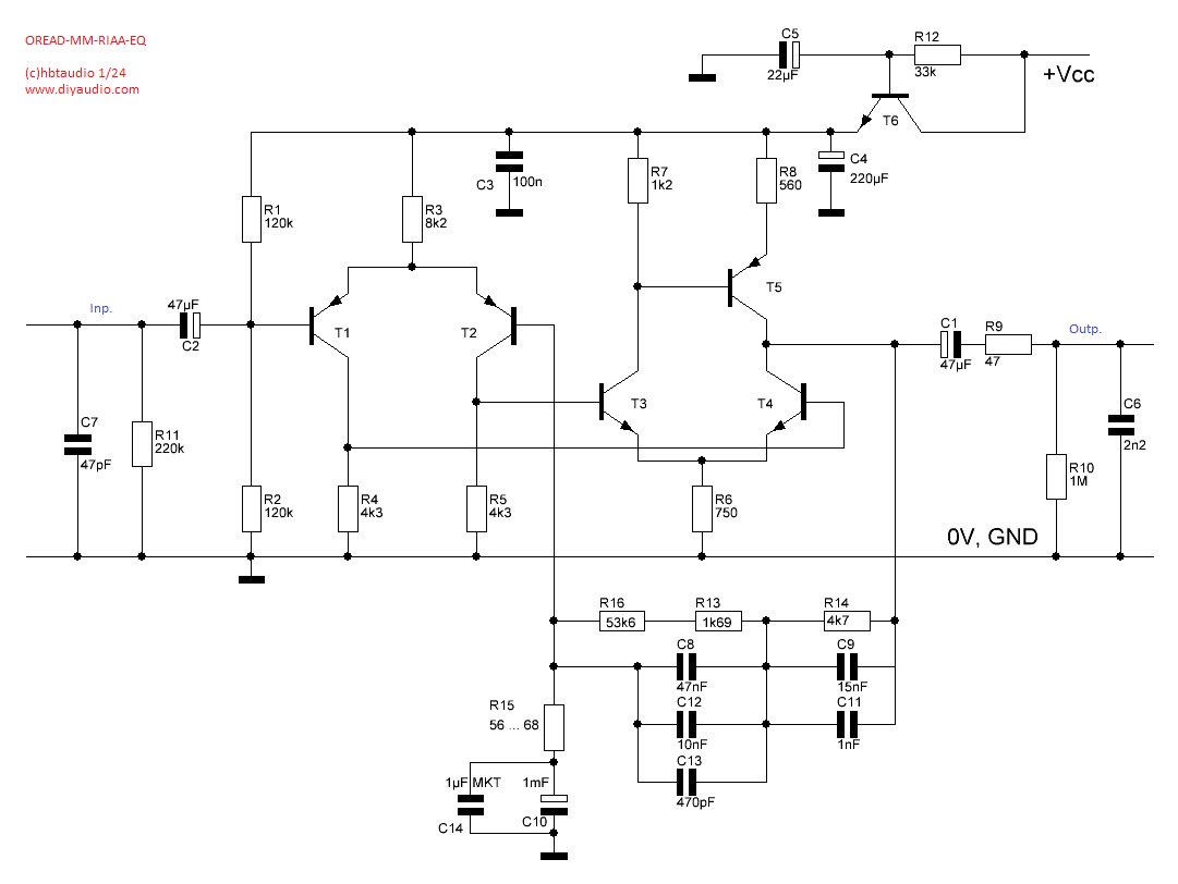

C8 is now 58nF 🙂,
cause R14 = 4k695 and R13 = 55k305 with C9 = 15,974nF and C8 = 57,555nF (as calculated) ! Would you like to generate a THD plot "catd"?
Nice that you are with us on board,
HBt.
4k7Ohm * 16nF = 75,2µsec; 55k29Ohm * 57n47F = 3177,5µsec; 4k332Ohm * 73n47F = 318,3µsec
Here is a fairly accurate RIAA approximation with available standard components (in Germany, REICHELT).
1% metal film resistors and 2.5% FKP, Styroflex, MKP, MKS film capacitors. BC550C & BC560C are also available.
All that is missing now' is a sensible layout, a circuit board and housing.

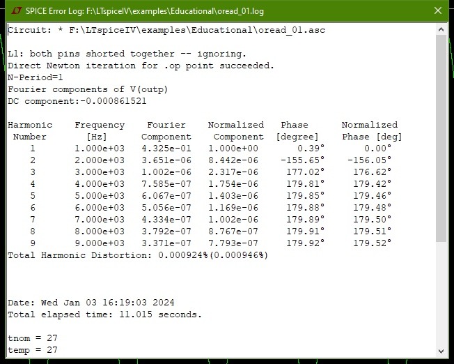

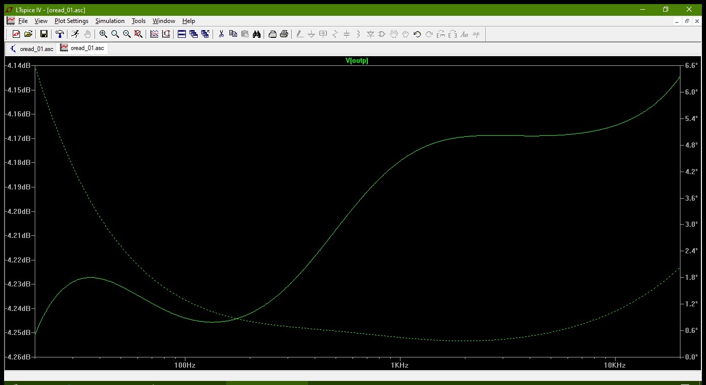

Below are LTspice-Files with symmetrical power supply.
I simulated with +9V/-9V, (directly, without cap multifier) this shows same results as with single supply 18V.
Simulation with +15V/-15V shows a bit better performance, e.g. lower THD, which appears in the fourth place after the decimal point.
I think this doesn`t matter in real live.

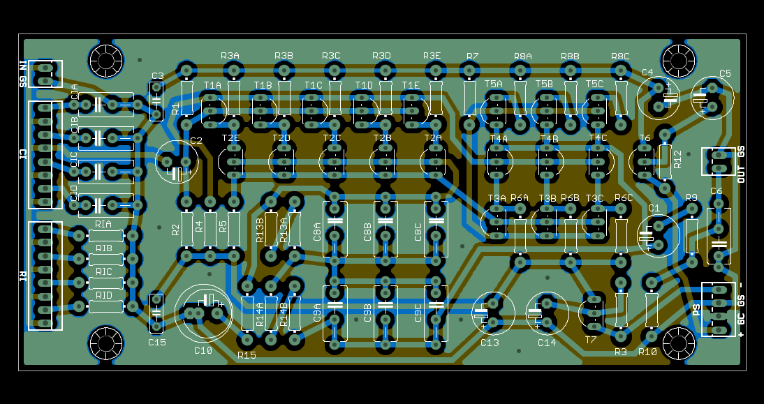

Will you do it yourself or should anyone else? Wouldn't make sense to later have more different layouts then needed.
I would prefer a kind of universal board, one per channel, which supports the multitrans version as well as single- and symmetrical supply.

Schematic of the first finale
I don't have to push myself forward, I am very happy about active cooperation and certainly also "Kastanienbrotaufstrich".
My layouts are always very special and not everyone's cup of tea. A universal PCB would be great, if you have the time and inclination, go for it.
If this thread mutates / evolved into a free forum project, so much the better - that was and is the intent.

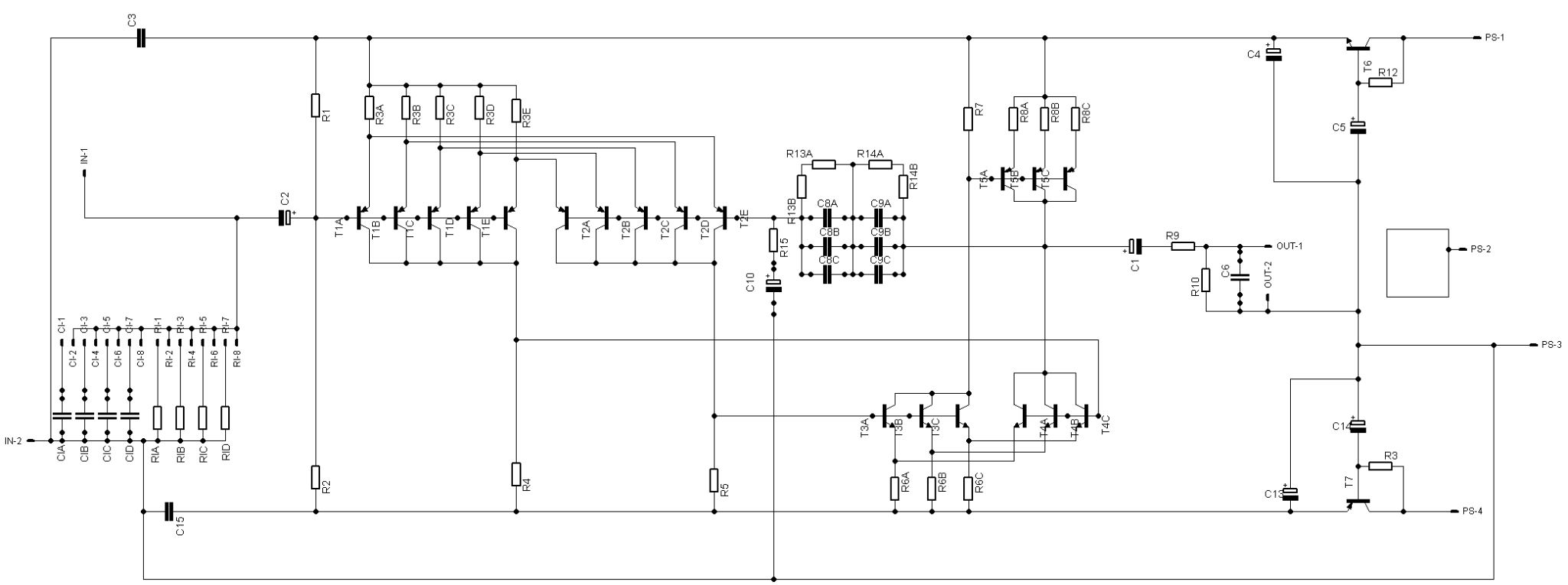

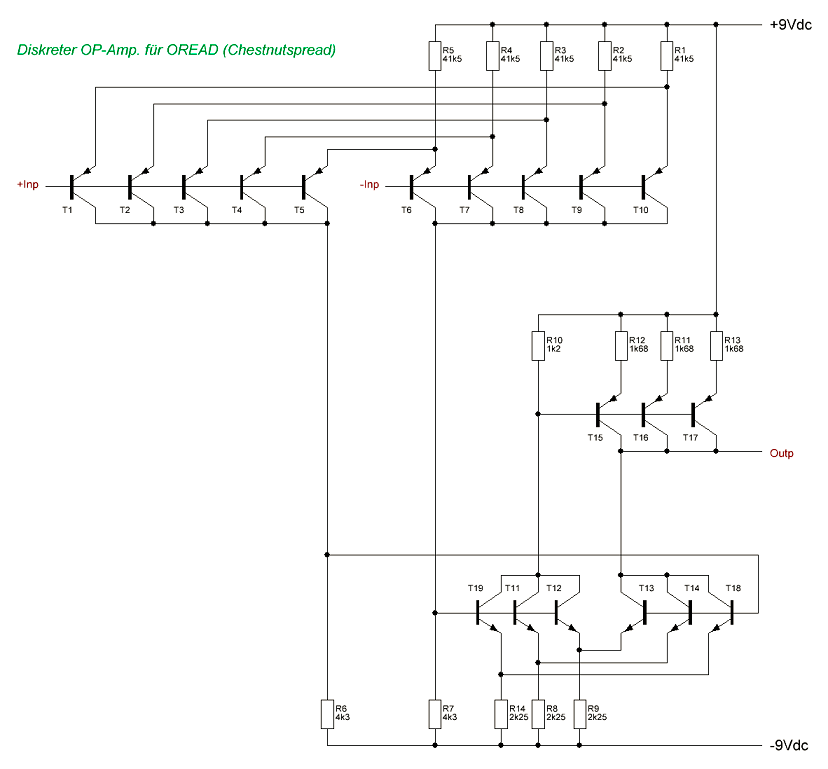

Outlook
The present project opens up several options:
1) PNP -> NPN & PNP, five bipolar transistors
2) NPN -> PNP & NPN, five bipolar transistors
3.1) Parallel connection, nineteen BJT
3.2) Parallel connection, nineteen BJT
4) Other negative feedback networks
5) Power supply variations
6) SMD versions
