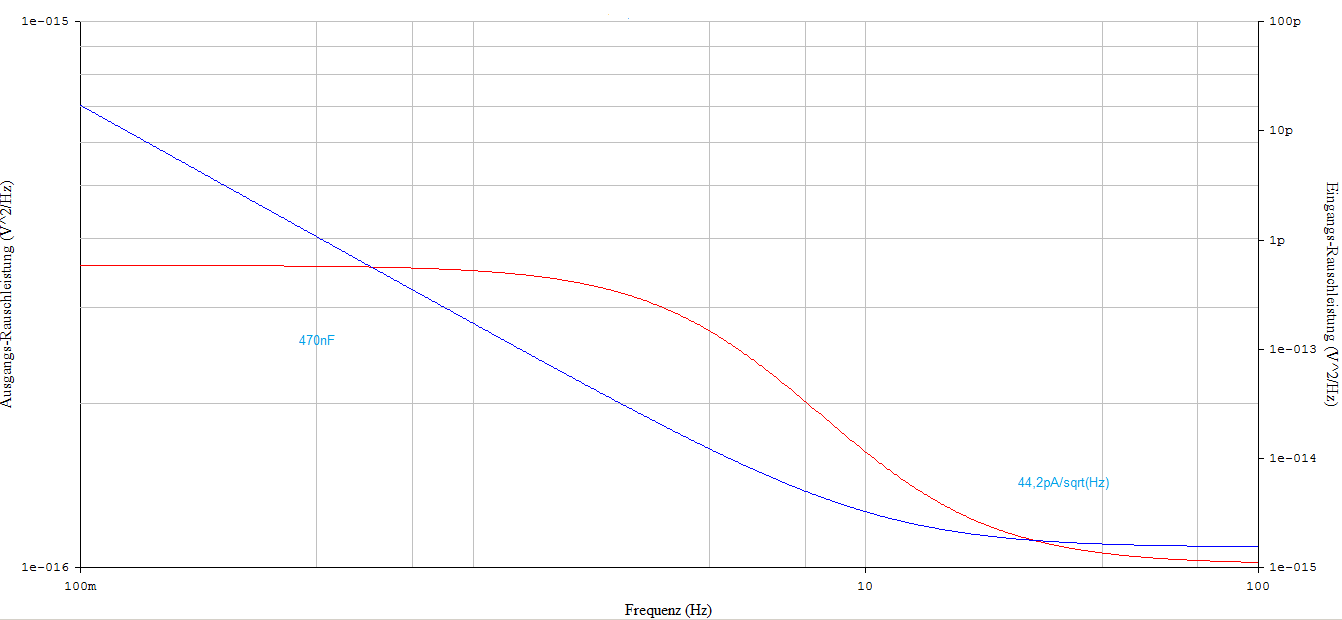

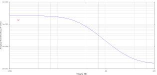

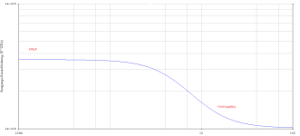

Just noticed that the C1 suggested 470nF has a lot of impedance at low frequencies (17k at 20Hz) - best if it were say 10µF or more, then you won't have to worry about the 1/f current noise of the input transistor generating avoidable input noise across C1.

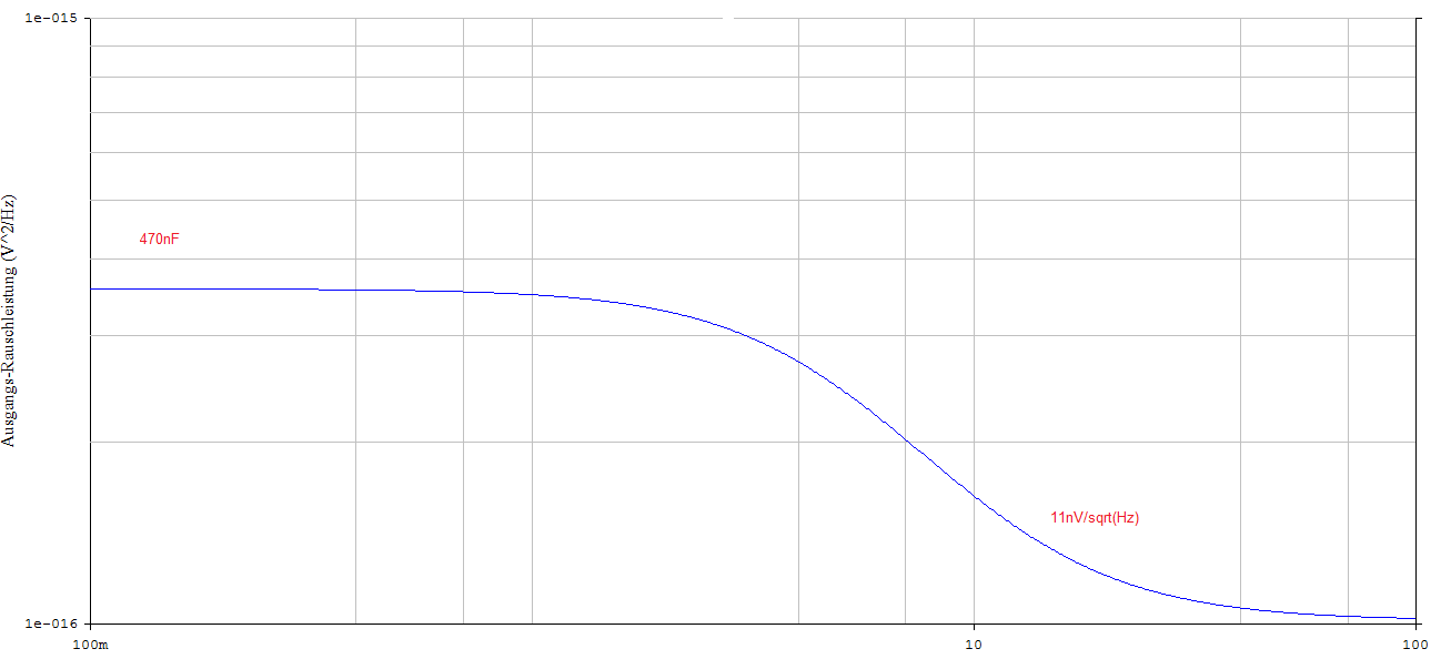

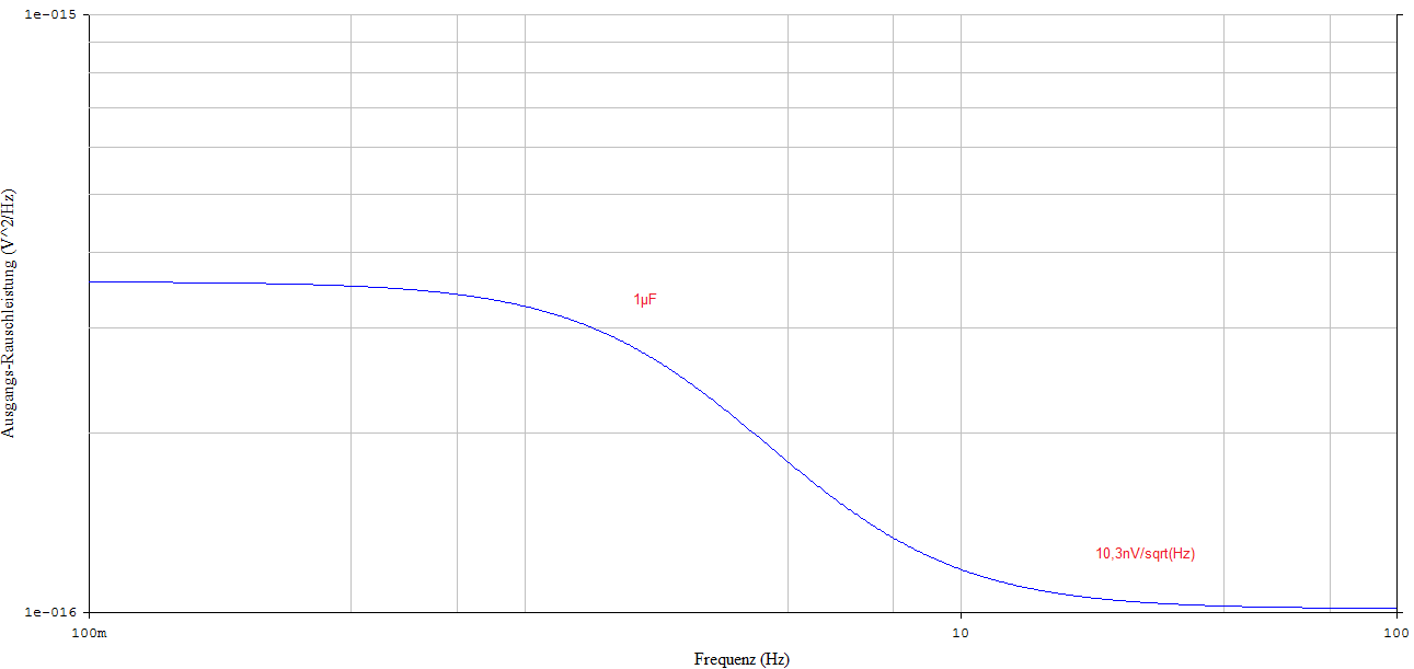

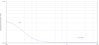

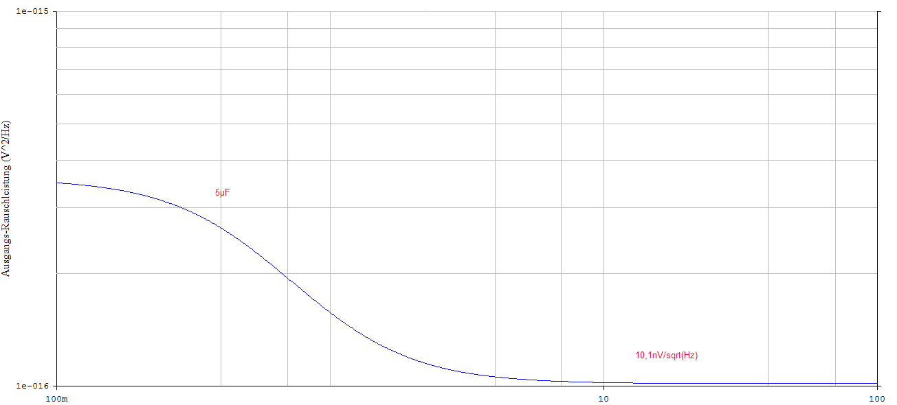

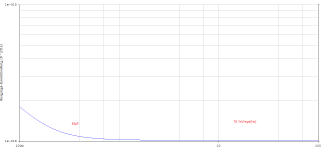

It is easy to simulate the inherent noise at the input node, the base electrodes of the transistors.
Let's take a look at what is generated at f=20Hz.
7,1nV / sqrt(Hz) , 20Hz
4,2nV / sqrt(Hz) , 20Hz
We recognize the attenuation curve of a 1st order high-pass filter. No more and no less.

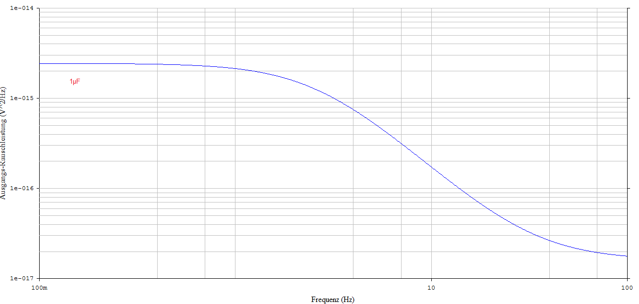

470nF, 1µF, 2µ2, 4µ7, 10µ, 22µ, 47µ ... none of these values present a real problem in terms of additional 1/f noise.
I can only make one recommendation:
contact catd and order a board, set up the EQ and enjoy your TT with an inexpensive MM.

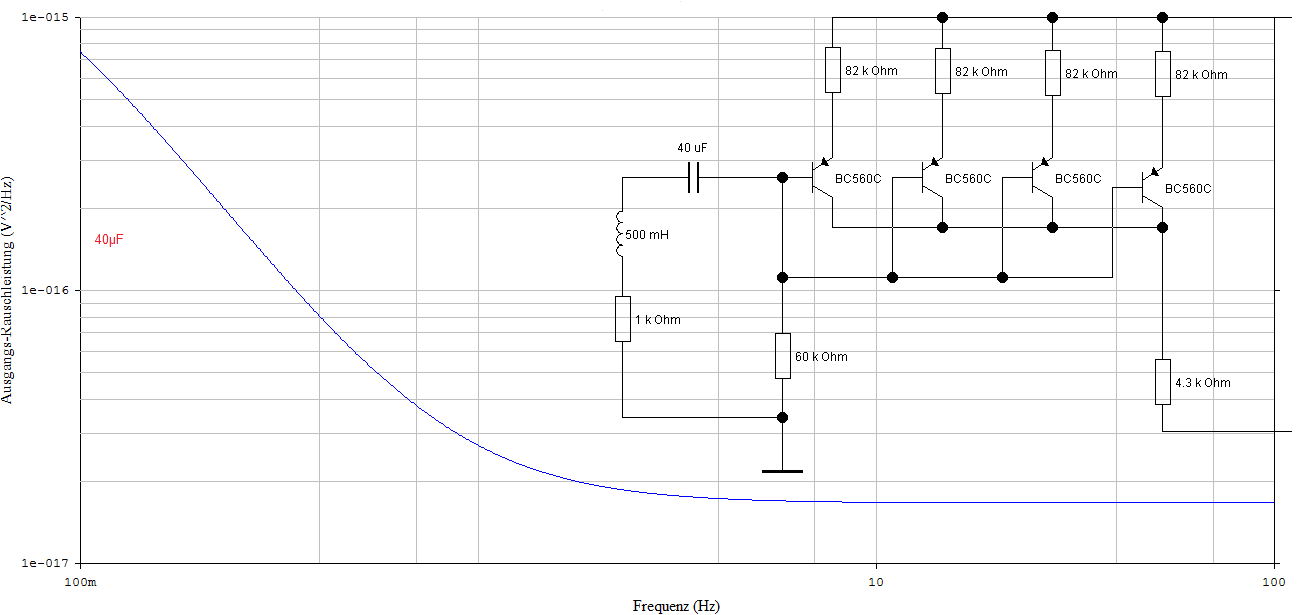

(...) about the 1/f current noise of the input transistor generating avoidable input noise across C1.
Ok,
"Current" is equal
to voltage divided by effective resistance or the resulting impedance (?)
- active, effective = constant
- impedance is a function of frequency and value of C and R
I decreases with increasing Z -----> but ... "Voltage" is I * R ... but I_noise * -jXc is not ...

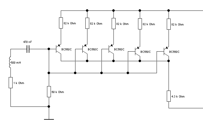

I suspect the recent comment from a user is about the typical noise, behavior of a bipolar transistor at low frequencies.
Looking at the equivalent circuit of this case, or modulating it, we find five noise sources, two u_noise and three i_noise. The so-called excess noise is now attempted to be described with the help of the basic shot noise. Experimentally, our forefathers have determined that the current noise of a transistor increases at low frequencies (and this is what the egg dance is all about, digression) with 10dB per frequency decade (to the left). There is simply nothing we can do about this, except perhaps find a transistor that is better suited than a BC5xx, or ...
Consider 470nF simply as a small subsonic filter directly before the amplification and 47µF as a practical short circuit -> in the end it is a coupling capacitor that keeps possible DC voltages away from the MM and also randomly injected DC voltages away from the amplifier.

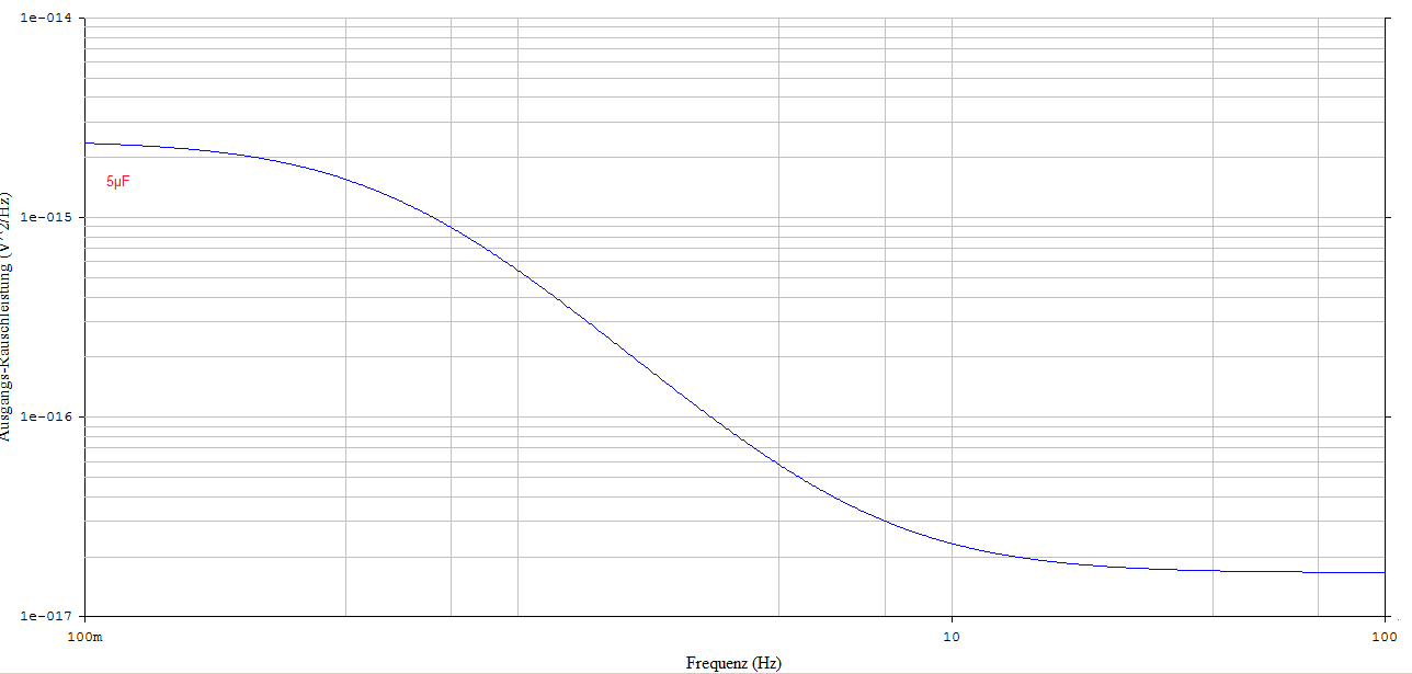

From a practical value of 4.7µF (a nice little WIMA MKS and a 10nF WIMA FKP in parallel), nobody has to worry about generating terrible, nasty, low-frequency noise.

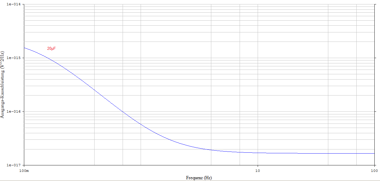

If an electrolytic capacitor is used as a coupling capacitor at this point, it should be larger than 17µF. 22µF/63Vdc would be the value of my choice, it must not be smaller and it may also be a 100V type as dielectric strength. Why is this the case? is slowly going beyond the scope of this excursus.
Please do not worry about this coupling capacitor at the first position within the entire signal processing chain.
4.7µF as a foil /or 470nF as a foil if you want to establish a small first subsonic filter just before ultra-low frequencies are amplified.

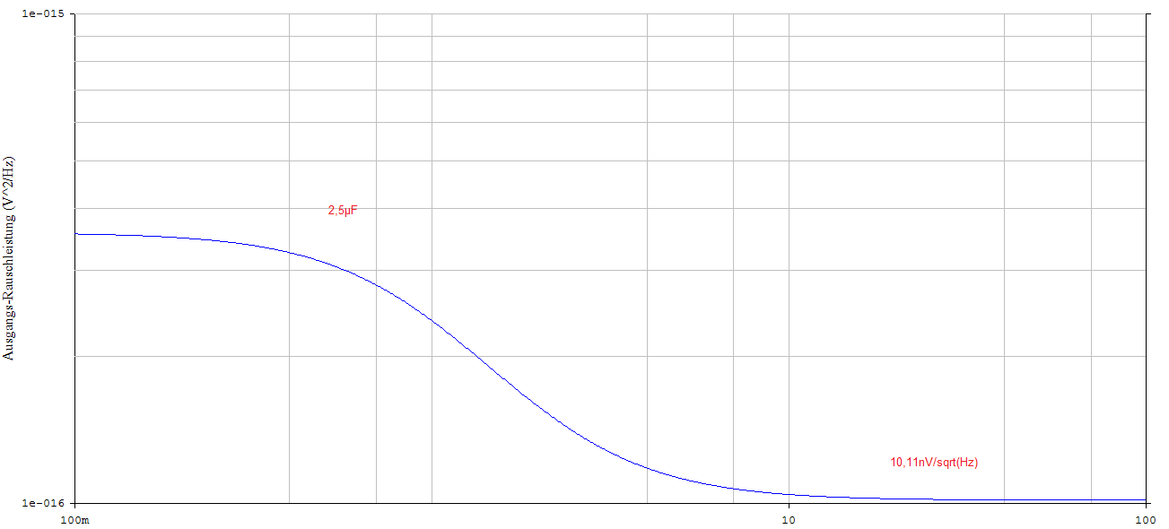

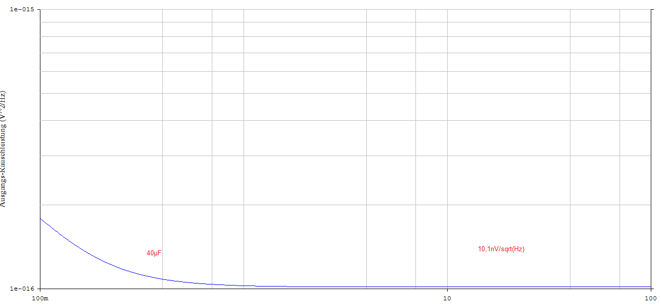

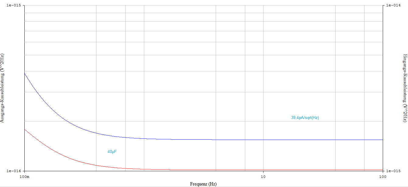

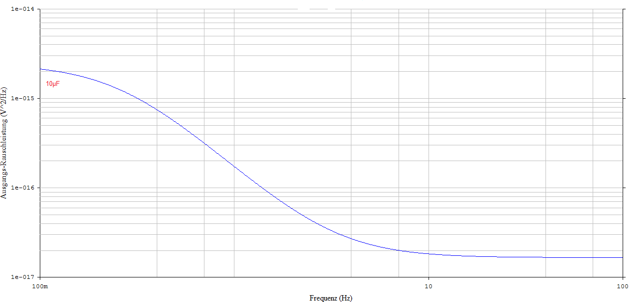

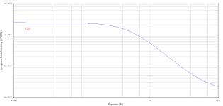

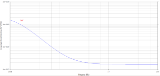

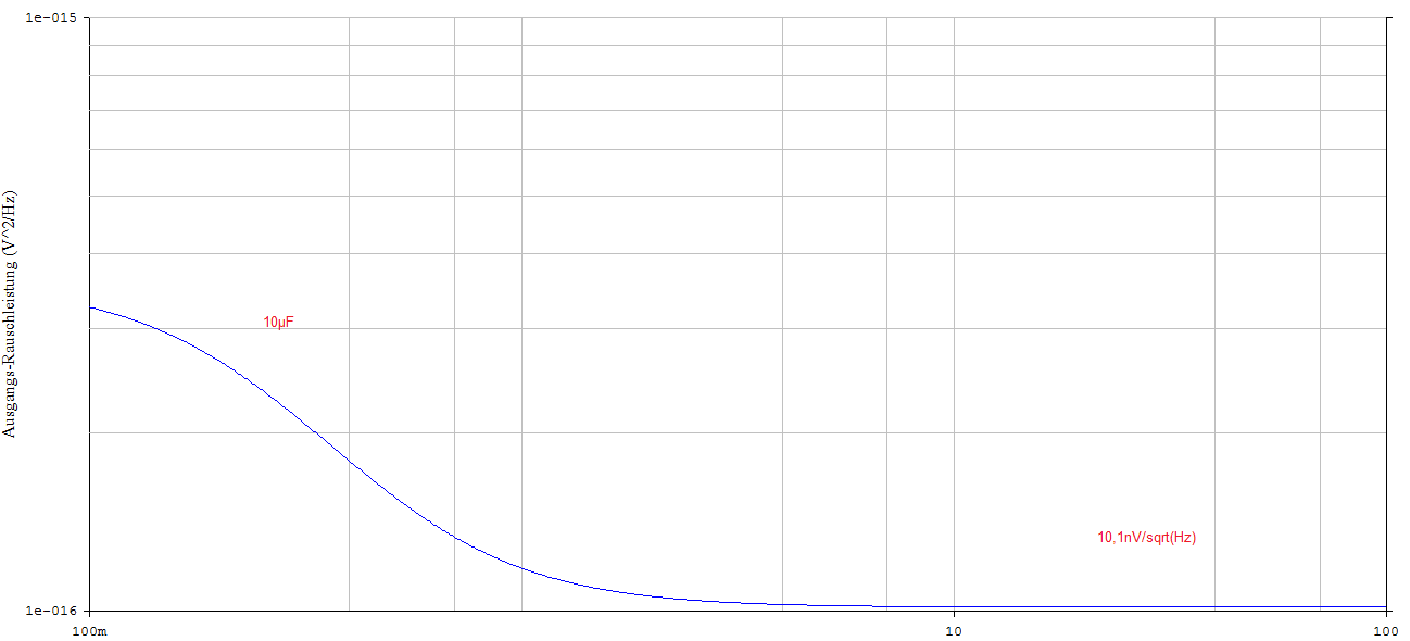

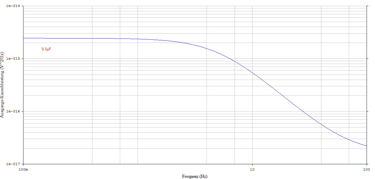

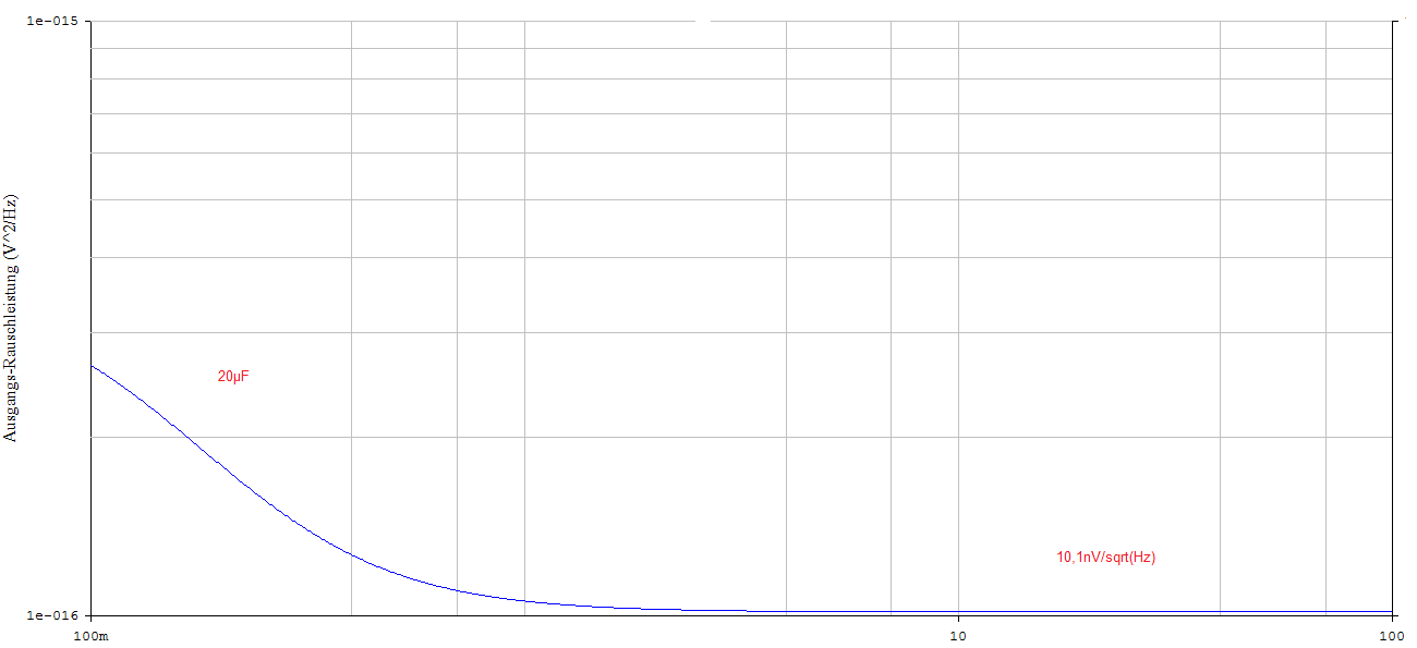

Let's look at the output node and consider the inherent noise (from 20Hz upwards) as a function of the coupling capacitor.
If we want to know which quasi noise current in the input circuit, i.e. at the effective resistance of the system, is a... constant horizontal line over the low frequencyband 1Hz to 100Hz ... independent of the reactance of the capacitorin the range of 470nF to 40µF:
4.123pA/sqrt(Hz)
The coupling capacitor is not a noise amplifier.
4.123pA/sqrt(Hz)
Now with MM as the noise source - but of course this is not the 1/f current noise of the emitter base sections.
But our two setups (catd & hbtaudio) work perfectly.
Value 470nF as a coupling capacitor value should be interpreted as a subsonic filter. Point around.

Precisely:
small values for the first coupling capacitor indicate (and define) a lower cut-off frequency.
You can like this or opt for 22µ to 47µ - all without any harm. The question is, why should the lowest interference be amplified by a factor of 1000?
