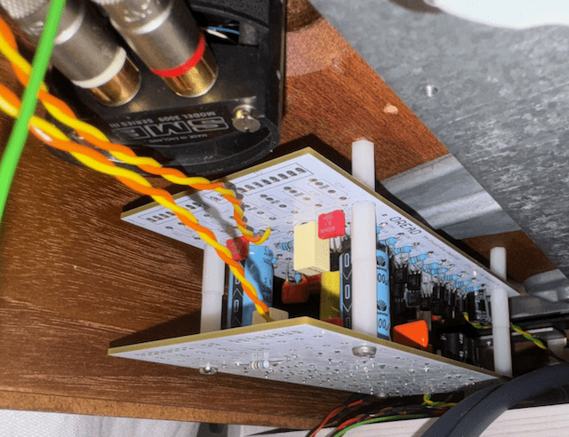

Just a sneak peak under the tonearm board of an old Thorens. Everything isn't in place yet. Especially I haven't solved how all conductors should enter or exit the turntable. But the sound is already marvelous. Without any kind of shielding even if the motor and its control board, with mains transformer, also resides in the plinth.
The expert for the installation of an MM-EQ in the chassis of the TT should be Nick S., he propagates this procedure.
I have only done this once before, with an original Supra1982, over 30 years ago. It worked great, but the belt drive used a real DC high-speed motor.
Maybe Nick S. can help better than I can - in this case.
This case actually calls for a tiny SMD-equipped circuit board
Yes, the best place for preamp is a TT inside, see my full phono preamp with smd components [ https://www.patreon.com/posts/insaidnyi-ot-vip-72574505 ]

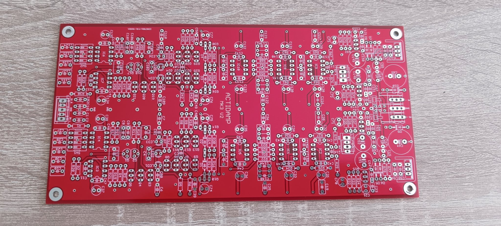

H ya I'm going to work on a rudimentary PCB, but there's no way I'll get to a test setup before the weekend
I would breadboard it first to be sure it is working as it should before going to the expense of creating a PCB.
@egellings
Didn't you read the whole thread? Obviously not.
There is already a PCB, (second edition), and some OREAD units in operation.
I did not read the whole thread; I just happened upon this page of it, and as a result was not aware of the availability of a PCB for it.

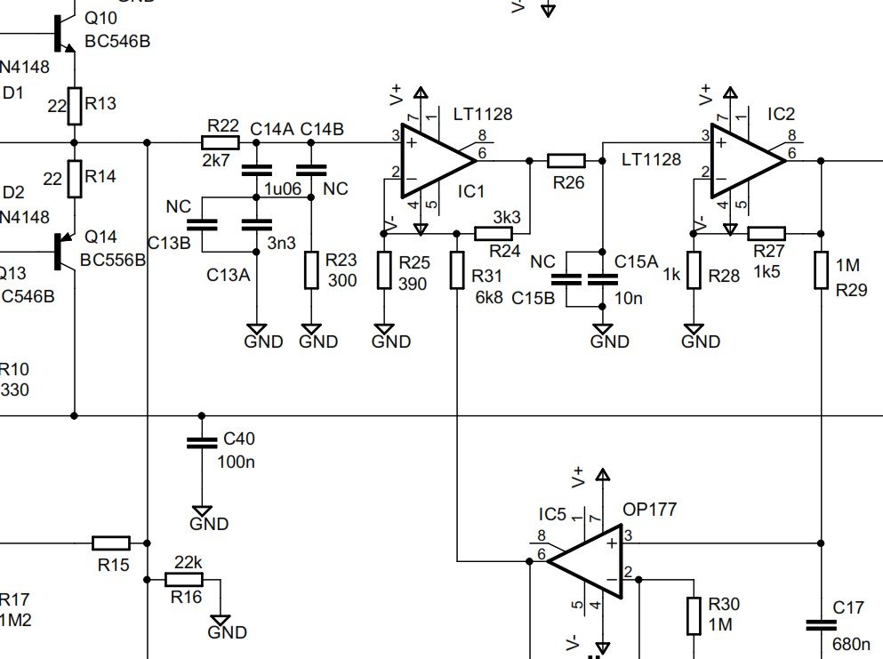

I wanted to revive the sound of vinyl, I have some good pieces from 2000 to 2005, which are not available on stream and if they are, they are in poor quality. At the moment I only listen to tidal + dac. Many of the MM preamps published here also have RIAA correction in the feedback, which is not sonically optimal. I'm working on one preamp for MM, topology is from 90's but even then it was able to outperform several times more expensive preamps even from world manufacturers. There were also listening tests and this one outperformed literally all the participants. It was originally designed as follows: discrete input amplifier input pair 2sk170, + two stages of passive correction. In the original wiring were used NE5534, which nowadays is no longer any glory and so I needed to replace them with something better, the requirement was that the IO in THT design and with a maximum power supply up to 20V DC since behind the capacitive multiplier is about 19V. In the end I used the following types in the wiring (LT1028, LT1128, and in the DC servos LT1055, LT1012)
