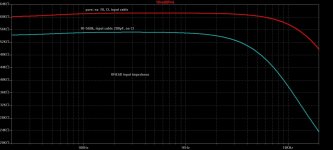

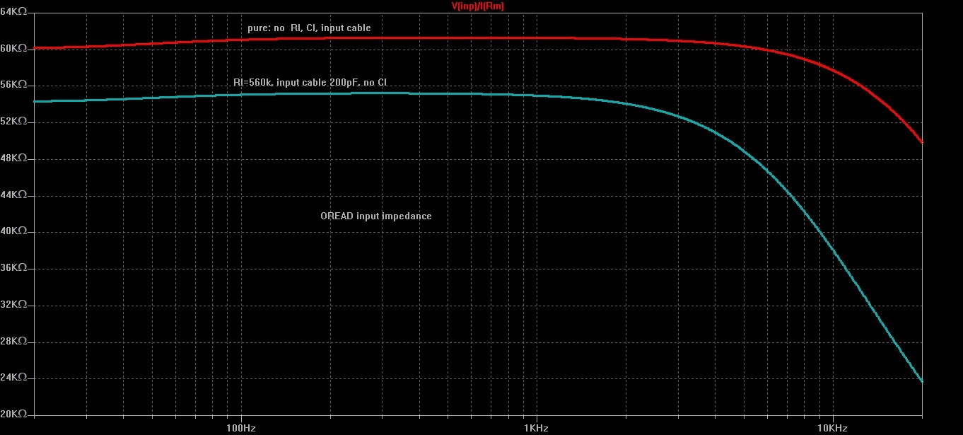

Earlier in the thread we found that the input capacitance of the OREAD is max. 75pF; without an additional capacitor CI connected in parallel.
Together with a standard cable with a capacitance of approx. 200pF/m, even an AT pickup is still fine if the cable is short enough, e.g. 50cm.
I have a ~1.2m connection cable with 210pF, no capacitor CI connected and an additional input resistor RI=560k connected for an Ortofon OM10.
But if I connect an AT pickup instead without any further changes (SME headshell, AT72), I cannot detect any significant change in the sound.
The same goes for a DUAL TKS236.
I think you don't have to take it all so seriously if the capacitance values stay within reasonable limits

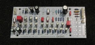

I got the new OREAD PCBs, version r06, and immediately assembled one.
This time, as already announced, the 'NPN circuit', i.e. with NPN transistors at the input.
All other transistors, electrolytic capacitors and of course the operating voltages have their polarity swapped accordingly.

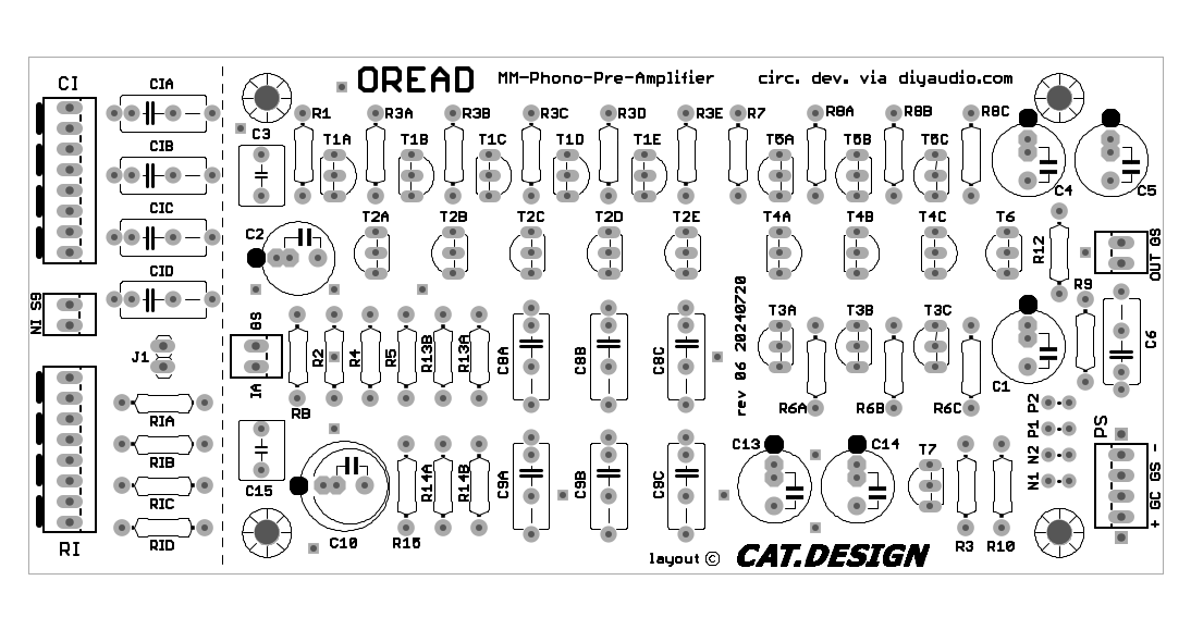

To do this, I made a few small changes to the board layout compared to version r04.
To avoid the operating voltage having to be connected the other way round than the board print indicates depending on the selected circuit (NPN/PNP), the polarity of the operating voltages on the new board r06 is determined by wire bridges P1/P2 and N1/N2, but the external connection to the power supply remains as before.
The polarity of electrolytic capacitors is also marked by a dot in the assembly print.
There is also now a separate place and print for the resistor RB.
PNP circuit:
Wire bridges P1, P2
Transistors T1, T2, T5, T7 = PNP
Transistors T3, T4, T6 = NPN
Capacitor connection: dot = negative
NPN circuit:
Wire bridges N1, N2
Transistors T1, T2, T5, T7 = NPN
Transistors T3, T4, T6 = PNP
Capacitor connection: dot = positive
I used the transistors BC107B (NPN) and BC177B (PNP) in the NPN circuit because I have a lot of them; I kept all other component values.
Thanks to the modified design of the circuit board described, I was able to swap it - even with the NPN circuit - for one of the two (stereo) PNP circuit boards (r04) in my phono preamplifier simply by plugging it in. It worked straight away without any problems and there was no difference between the two channels when I first listened to it briefly.
There is also no difference in terms of noise. You only hear a very quiet hissing sound when the volume control is turned up all the way, the same for both versions.

All variants of the OREAD idea can be implemented with the current board
For me, this means that the OREAD chapter has moved beyond the prototype status - and we could be approaching the project supra2024 in the foreseeable future, which would ultimately be a fork in the road that the initial discussion thread had also taken.

What is 'measurable', however:
When looking through the data sheets, you will notice that the PNP transistors have stated higher capacitance than the NPN, about twice as much.
This is correctly taken into account in the LTspice models BC550/560/107/177.
When simulating the NPN circuit, the input capacitance shown is therefore about half that of the PNP circuit.
Input capacitance of the NPN circuit: 35pF
10pF for the circuit board is included in this value.
If you use pickups for which the manufacturer specifies a low connection capacitance and therefore believe that you have to avoid every single picoFarad, you should use the NPN version.
