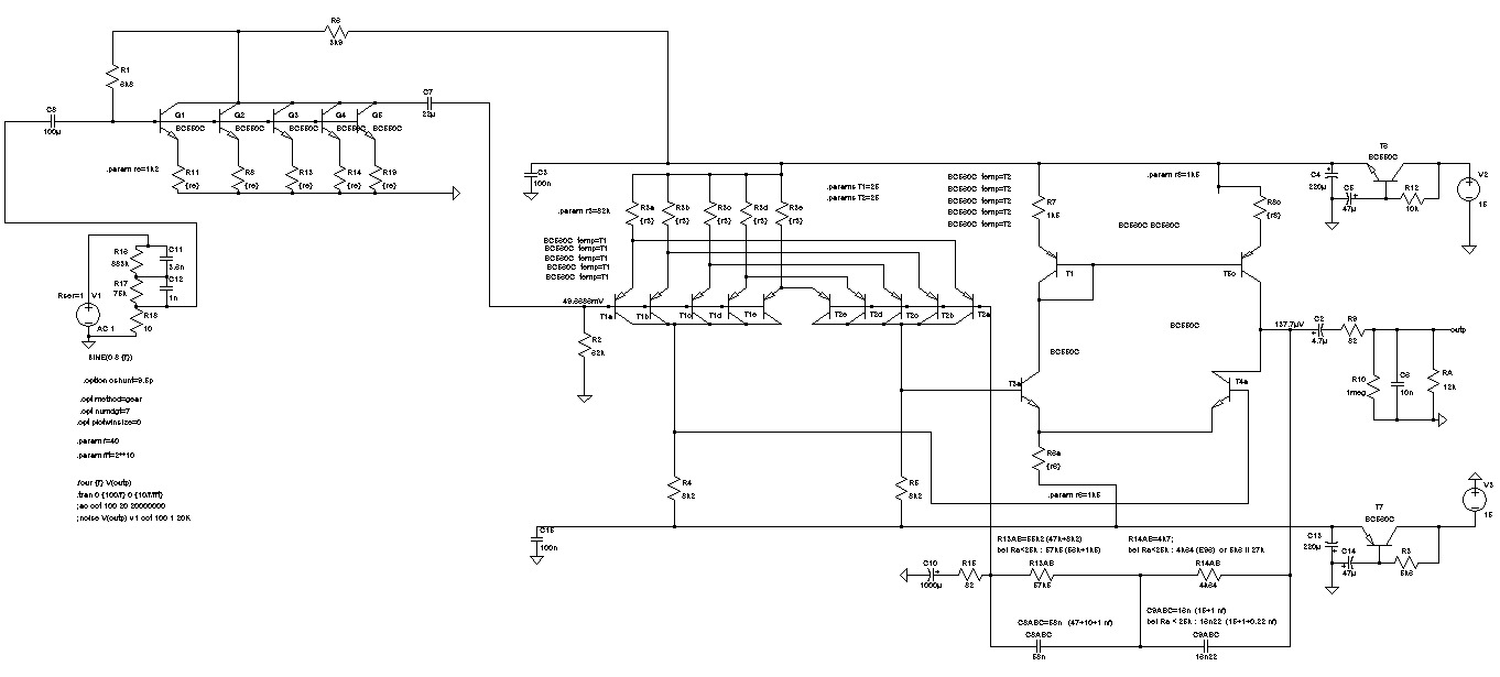

Last Friday I did a test assembly on a wooden board. This didn't work out well. Only got some hum on the outputs and the negative fuse went after like a minute even if nothing heated up. When there's time again I will inspect and connect one OREAD at a time to the P/S to work out what is wrong. Worst case I do have an old oscilloscope... but it's probably just some silly mistake on my behalf.

How can I /we help you?
I hope you find the error quickly and it has no consequences for the EQ.
  • Always test the power supply alone and first
  • Check again that you have inserted the correct order of PNP or NPN on the OREAD boards; an accidental swap is not unlikely
  • But somehow the scenario sounds like a short circuit.

Thanks for Your concern, I'm convinced it's my fault. I'm not at home, so You will have to endure until I've had time to look at it again. As You suggest I can very well have mixed up the transistors. I did test the P/S separately and it worked flawlessly, with its soft start.

As far as I can tell from your picture,
1.) you have not connected the ground planes GC of the boards.
They should be connected to GS/ground, otherwise there may be oscillations, at least if there is no shielding housing.
2.) you have left out the capacitors on the outputs of the power supply.
As far as I know, the LM337 in particular is a bit finicky if it doesn't have an output capacitor.
So there should be at least small capacitors (e.g. 1µF).
But I don't know if that has anything to do with your problem.
First test the power supply by running it with and without an appropriate load (e.g. 500mA) and measure whether the regulation works, i.e. whether the output voltage remains constant.
When running the OREAD, measure the current consumption of one circuit/board, which should be around 2.5 mA at each voltage/rail. (at +/-15V)
To be on the safe side, you could also test the OREAD with two 9V batteries first to possibly avoid blowing anything in the event of an error.
Then there will be 1.3mA per rail, per board

Excactly this was the problem. A spare 47uF I had lying around was used to prove Your point. I have encountered the same problem before, but I thought the capacities on the OREAD board would be enough. Apparently not. Without any load it measures 15V, but as soon I loaded the -15V it dropped to around -2 - -3 V. After adding the capacitor the voltage had to be readjusted. The positive regulator is more fault tolerant.
You are also right about RB being soldered on the underside of the PCB.
I didn't bother about the GC connection for now. Proper shielding will not be provided until I've built an enclosure anyway. I do appreciate You have provided the wiring of the complete circuit including P/S and enclosure. I consider following Your instructions better this time 😀

I see You've changed the output stage of OREAD, in my eyes to simplifiy building it, fewer components?
MC is just a simulation. I don't have an MC pickup system for real testing.
The output stage with single transistors is also just a test. The output stage contributes relatively little to the noise of the circuit, so here the paralleling of transistors is more of a high-end cosmetic.
But I haven't really thought about simplifying by reducing the number of components, although on the other hand that might free up board space to accommodate the MC stage parts and keep the board size.
But these are all just thought experiments while I wait for the new OREAD boards. I want to build the current circuit version with the polarity reversed first, so with an NPN input stage.
I don't own a MC cartridge either, so You researching reversed polarity is probably closer to home for me 🙂 A pre pre amplifier is certainly less expensive than a Step Up Transformer, but the latter would be an alternate solution if one wants to use OREAD from a MC signal.
