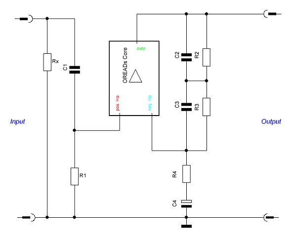

After the somewhat strange introduction, the guide, once again a more appealing and familiar picture. The first part of the guide shows how to arrive at the theoretical component values.
Now the puzzle game can begin!
But the question of the core, the heart of the equalizer, is perhaps more interesting ...
We create a new image - and thus also gain a different perspective and broaden our understanding.
Who cracks the mystery? before moving on to the actual amplifier design, which could obviously just be an integrated operational amplifier - type NE5534 or TL071 or similar.

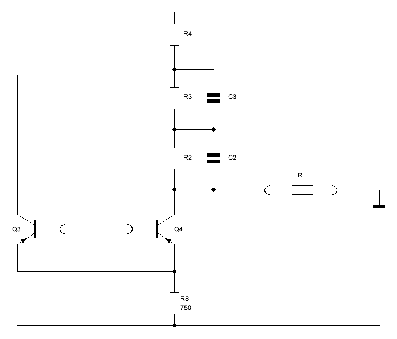

Error:
UR8 = (R3*0.5mA) - 0.7V = 1.45V
To calculate R8, the corresponding current is still missing. In short: Doubling, 2 * I of the first stage, leads to 2mA.
1,45V / 2mA = 725Ω
We approximate this value according to the E24 series and select the value 750Ω for R8.
Note
The QREAD document is also in an evolving state. The approach is identical to the motto, the leitmotif of this thread. I therefore urge caution or cooperation.
Correction:UR8 = (4.3V - 0.7V) = 3.6V
To calculate R8, the appropriate current is still missing. In short: doubling, 2 * I of the first
R8 = 1.8kΩ we even find this value directly in the E-series.

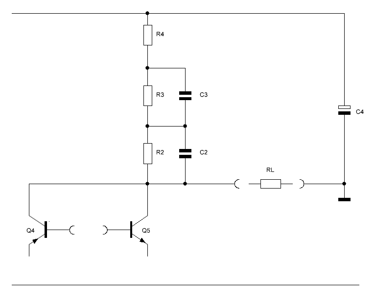

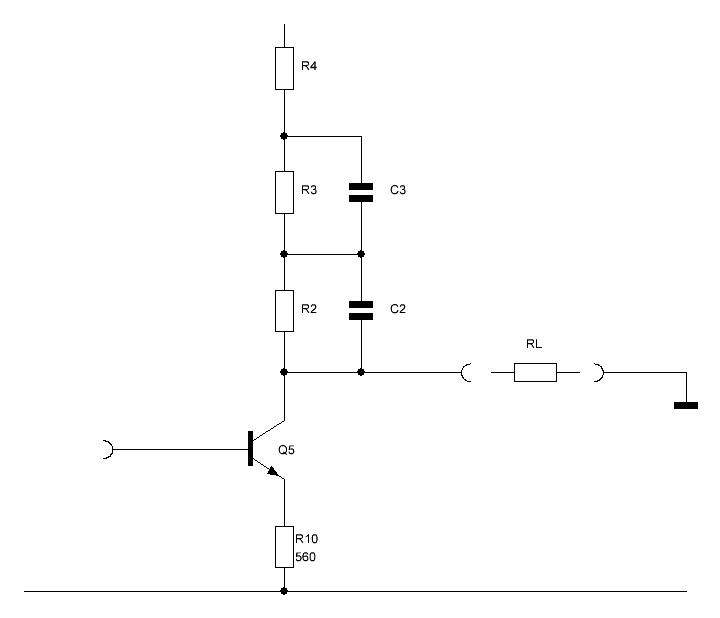

To get to the bottom of the mystery, we have to take a different perspective. The dynamic or ac-view - often called small signal analysis.
Perhaps three simplified pictures will help to lift the curtain?
What makes this approach special?
The RIAA network itself is the so-called working resistor. The core is nothing more than a voltage-controlled current source.
If implemented monolithically, the two common ohmic emitter resistors would naturally be current sinks. This will be familiar to many DIY enthusiasts, but the actual why is certainly not.
With a real operational amplifier, the OREAD design would be nothing special. With the very simple five-transistor thing, it is quite unusual, but also well-known.
