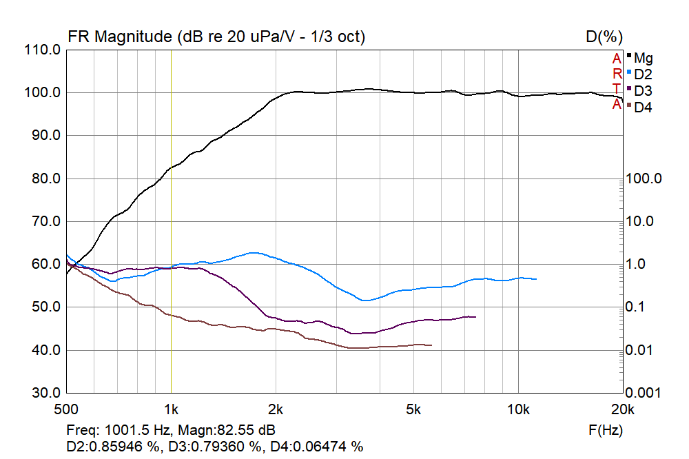

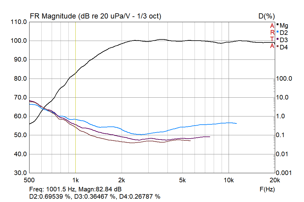

Would be nice to do the distortion relatively (in dB or percentage).
Here you go. Both 100 dB SPL, equalized; left free air, right waveguide.
I should note that while SPL calibration was accurate, I used different measurement chain gain structure for either run. So higher harmonics might represent the noise floor of the signal chain, especially in the waveguide measurement. Getting those 100% representative is very challenging, especially with high end hardware like the Bliesmas with ultra low distortion figures... you can't have any bit of slightest noise introduced into the measurement from any of the multiple potential sources.
Reactions: IamJF and b_force
Well if it's fully masked by the noise floor anyway, I guess the numbers don't really matter anymore to begin with 😉
Higher harmonics != all harmonics. K2 is definitely fully representative in all the graphs, and H3 almost as well. If you've once seen how electronics noise floor looks like in distortion measurements, as opposed to loudspeaker distortions, you'll also easily recognize it - it's basically a flat line of all harmonics mashed together. That's not what happens here.

At 100dBSpl our ear already does a lot of THD by itself. These drivers have so low THD - with a cheap/small measurement mic (these 1/4" ref mics have a LOT of noise) you will always run into the noise floor. I always do a noise floor measurement when measureing outside my lab room.
(I never could measure the noise floor in the listening/measurement room. The mic with the lowest noise floor I have is around 8dBSpl(A) and I can measure this noisefloor perfectly 🤓 )
In my case it's (mostly) the pre-amp. It has an SNR of about 80, 90 dB. If I set the gain structure for the measurement to (almost - don't want to clip either) max out its dynamic range, the noise floor will be low enough relative to the actual signal to show accurate behavior for even higher harmonics. If I did that though, I'd have to switch gain on the pre-amp and then load an appropriate calibration file in ARTA for practically every measurement, and I'd never get any work done. So in practice I use two to three gain structures & calibration files for various levels, mostly just two (one for up to ~100 dB, one for up to ~125 dB), and that's good enough for most cases.
But yes, of course, the whole signal chain (& environment) is to some degree an influence. In the document I linked in my first post in this thread, ARTA Ringversuch, you can see my measurements of a Purifi midwoofer & SB26ADC vs. a Klippel NFS with G.R.A.S. microphone and electronics. While our frequency responses (frequency & SPL calibration) matched almost perfectly, it thoroughly outclassed me in the low level distortion measurements of these also very low distortion speakers. That's where the wheat separates from the chaff, and one knows why the other guy paid x times as much for his hardware.
If it's just about noise floor, you can average your measurements.
Although that only goes with a 10log.
So getting more than 12dB extra is getting very tedious. (that's 16 averages)

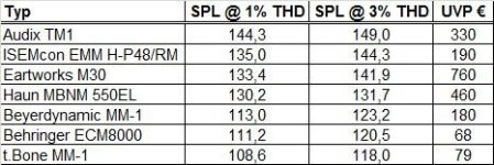

Quick comment on mic options: Earthworks with ultra high sensitivity that requires a level pad for high level measurements - no thanks. MM1's Max. SPL @ THD is lacking and would add significant extra distortion probably already @ 100, certainly at 105 dB; SNR isn't the only thing that counts.

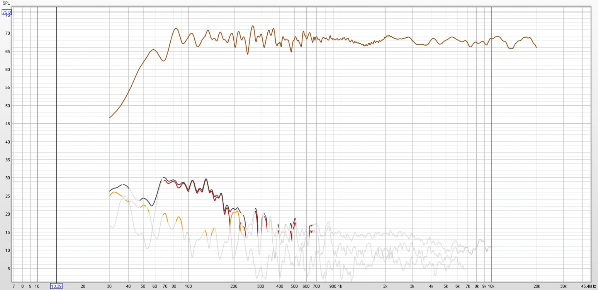

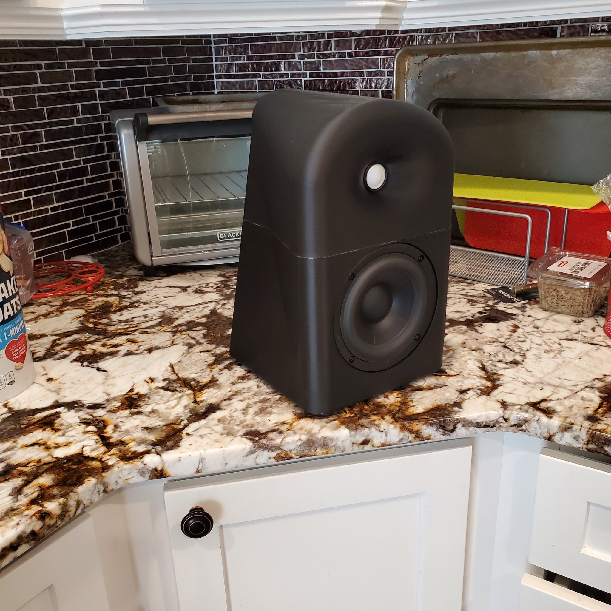

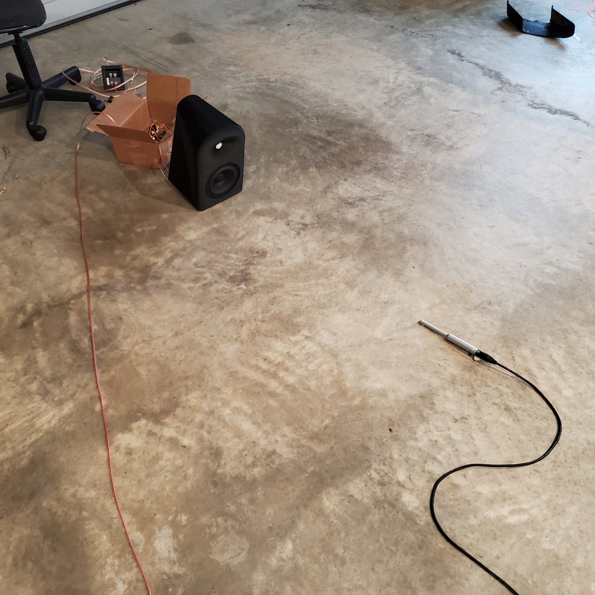

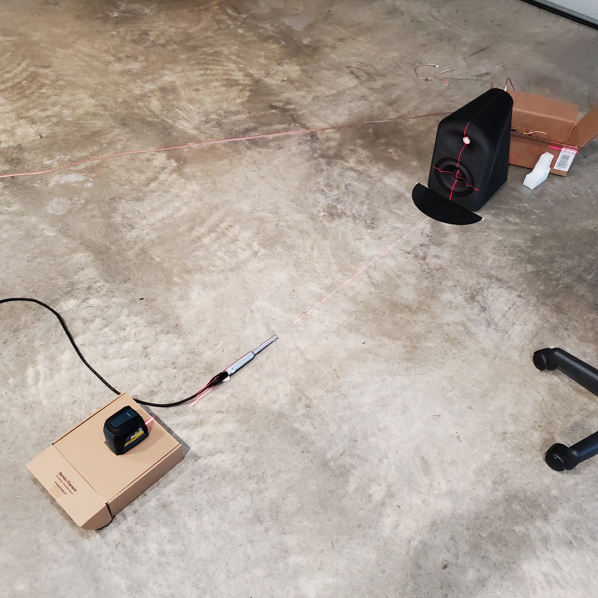

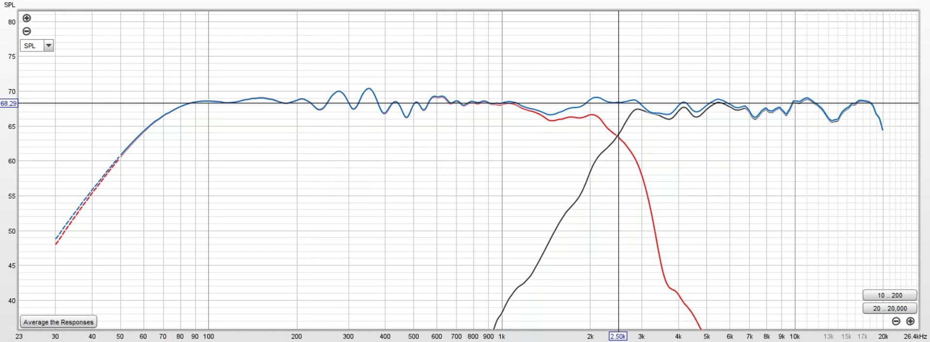

I think I've settled on the final(ish) design for the smaller two-part 3D printed enclosure with the integrated AP waveguide. This particular test shows the sealed design, but also have final(ish) designs for a ported box. I've done a preliminary run through with some spare x-over parts I had laying around.
Here's an un-gated distortion plot, pay no attention to the SPL, I have yet to calibrate it:

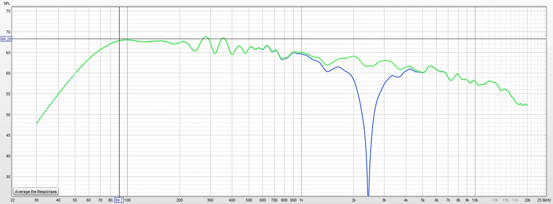

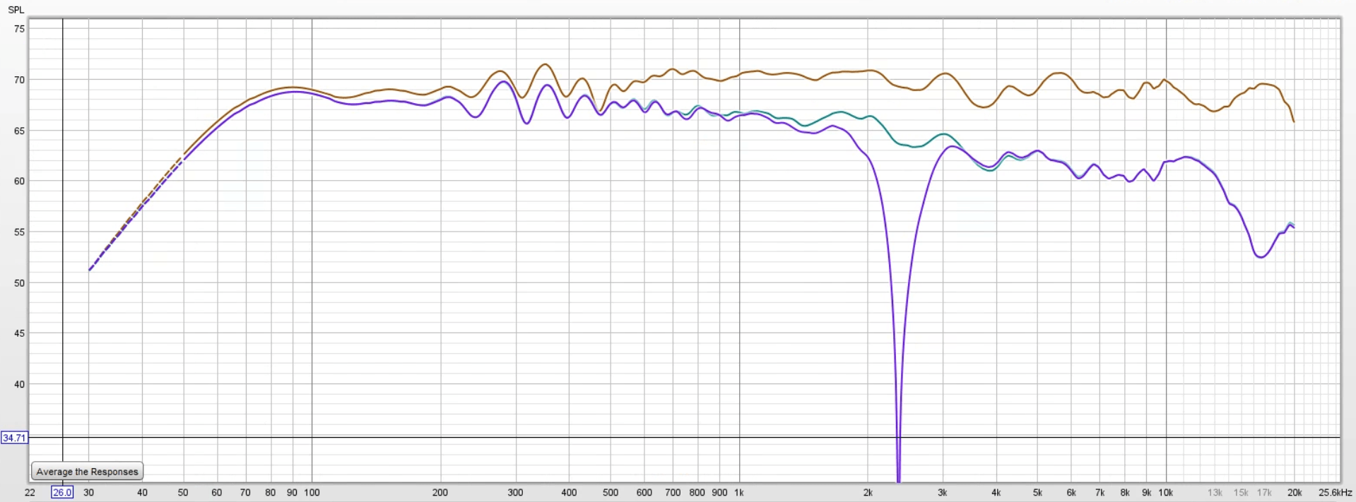

As well as the 60 degree off-axis and inverted plot, 20ms gating at 15 cycles:
It's been hot a heck in my garage so I haven't persuaded myself to do a complete suit of directivity measurements and the like. Also since I am still fine tuning the crossover.
I'm all open for comments if anyone has suggestions or advice regarding crossovers, measurement techniques, or anything else!

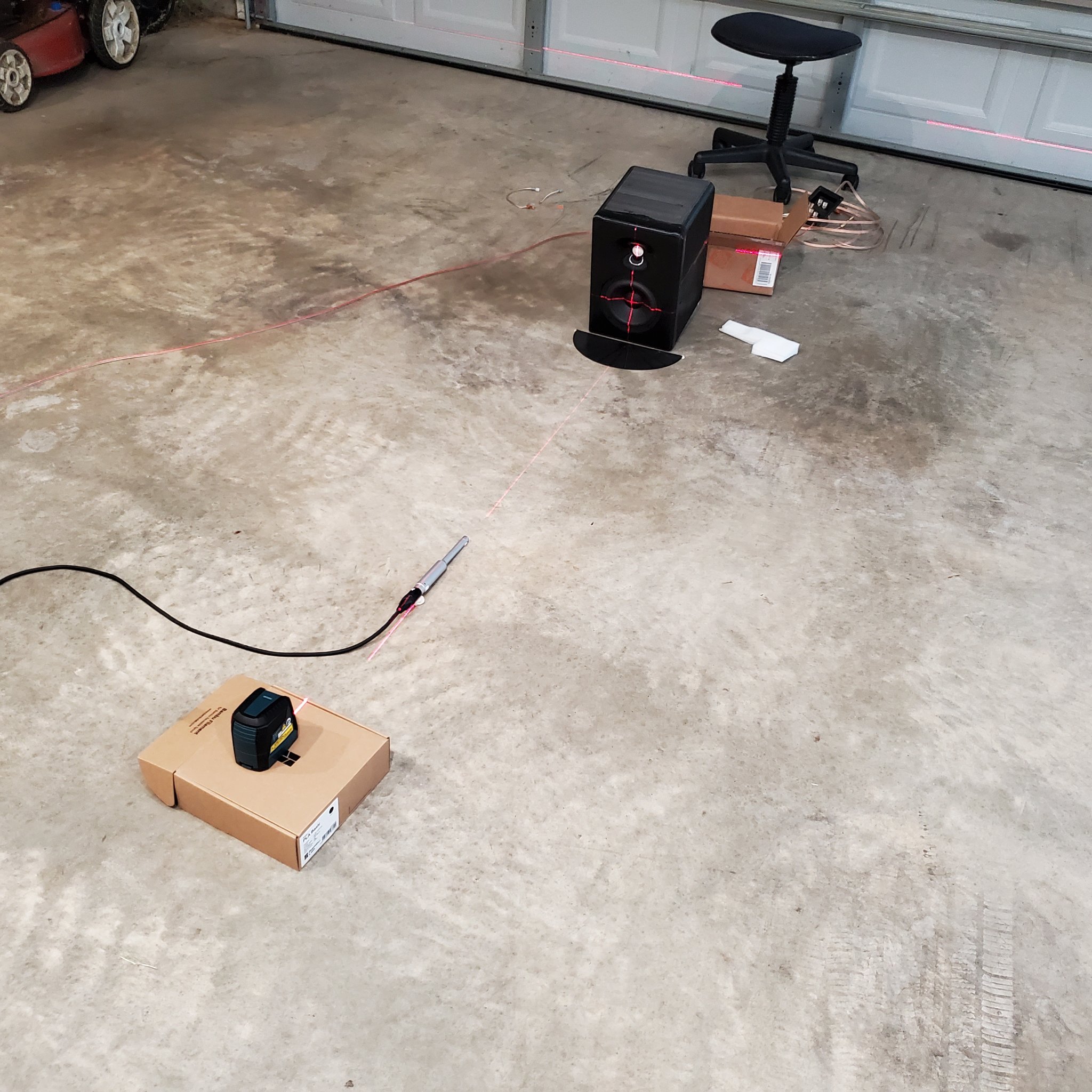

There is still quite a bit of interference in the measurements.
Probably coming from the garage door.
Keep in mind you need around 1 meter (about 3 feet) of free space around your speaker (seen from front baffle) as well as the microphone.
Having things anti-parallel to the walls can also help a bit.
I would suggest using a hybrid method with stitching, near-field as well as ground measurements! 🙂
