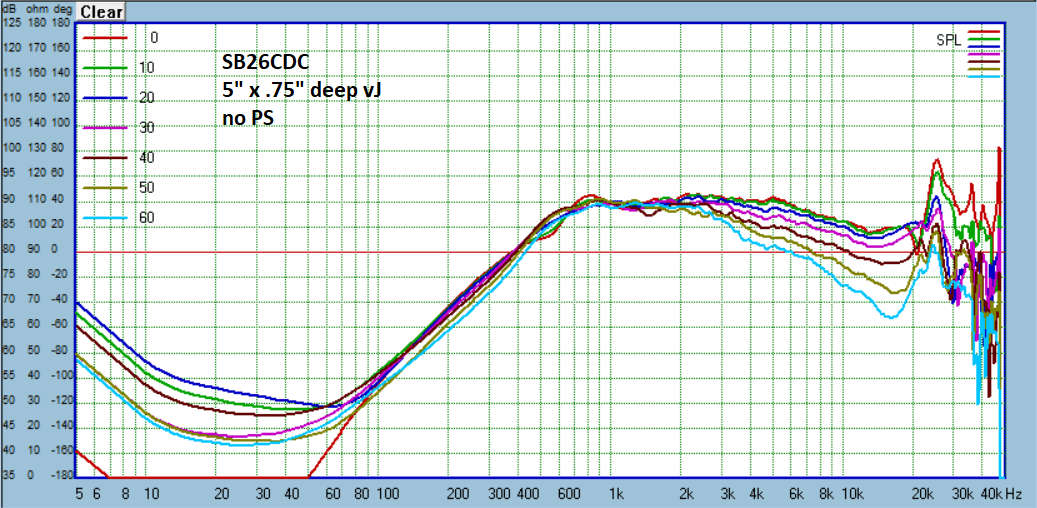

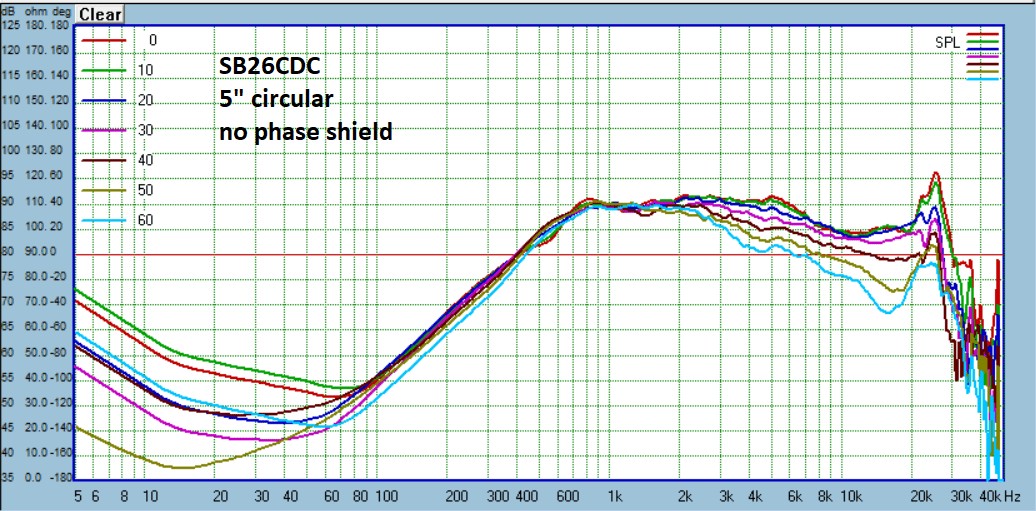

Following your thread, I think you have made a circular version of sb26adc waveguide but didn't posted it(only image of it). What I can find on your website is only ellipse versions.
I do know that ellipse versions have higher potential especially on the vertical dispersion, but still if it doesn't bother you much, would it be possible that you post your pre-designed circular version as well?
Specifically I hope I could get the 5" no ps version, but anything would be just fine.
For days I tried to do it by myself, but for a dumb like me modeling through mathmatics is extreamly challenging.. 🙁

Here is the 5" circular guide. the contour is the same as the elliptical in its horizontal axis, so just a round version of the elliptical.
I'm no expert, but I would imagine the air impedance loading would be much different in a circular waveguide, compared to an oval waveguide with the save X-axis profile.That's interesting - I would have expected a more even radiation in all directions of a circular version vs. oval but not a worse frequency response?
