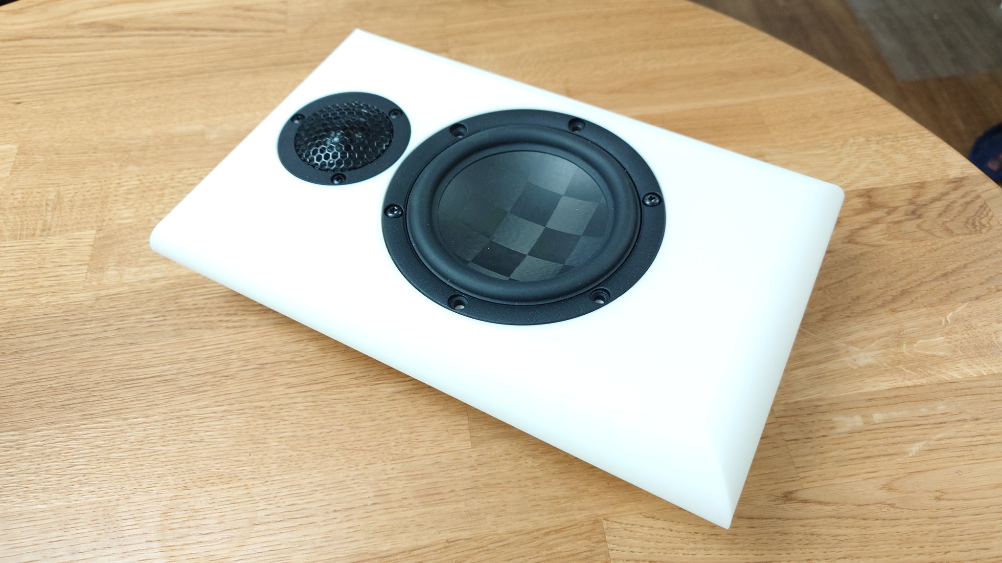

My first 3D printed Baffle. Took the new & fast printer about 11h ... will probably take 2 days for a serious speaker with big waveguide ...
But everything worked and is precise.
Btw - how to glue PLA to wood?

I had quite good results with normal PVA wood glue (ponal express in my case). even when gluing PLA to PLA.Btw - how to glue PLA to wood?

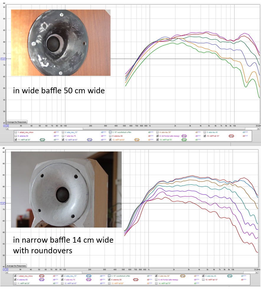

I once read that the waveguide should be about the same size as the midrange driver and that the baffle width also plays a role, or is that rather negligible for a waveguide?
again this is very VERY dependent on your crossover frequency and order.
I learned from mabat's thread and by experimenting with waveguides that it does not make sense to stop considering the "waveguide" just because the physical waveguide edge / because the waveguide meets the baffle.
for higher frequencies you can probably just neglect the influence of baffle width and baffle shape, but it has big influence for the lower frequencies.
here below an example of a very mediocre waveguide in a wide baffle and in a rounded over narrow baffle (0-15-30-45-60-75-90° horizontal).
please take it with a grain of salt, as the measurement parameters were not exactly 100 % the same!

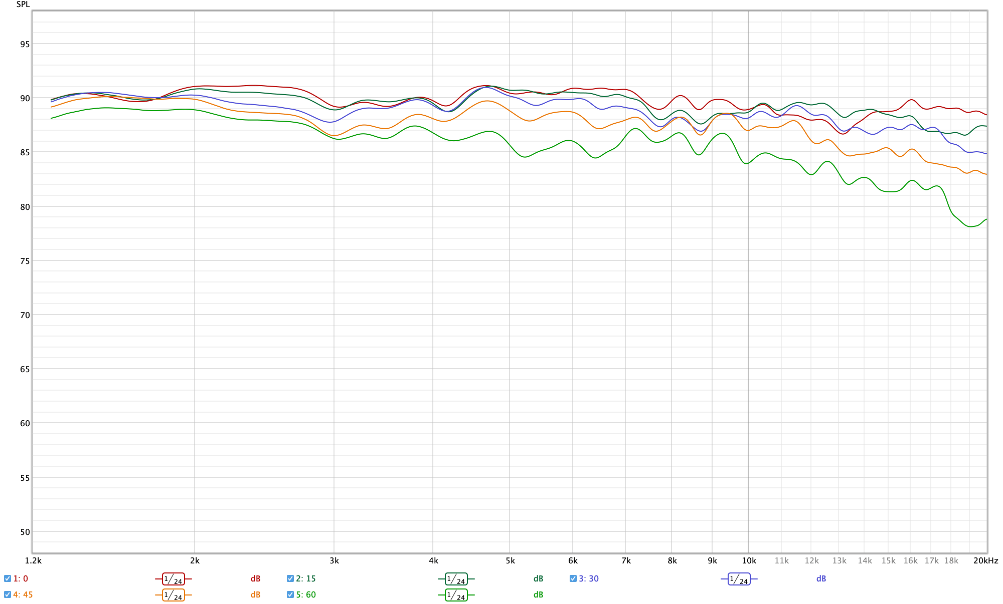

Here's a more recent measurement after filling the tiny gap around the waveguide and with a few extra filters applied:
I am really happy with the result. Radiation is still wide (that is what I wanted). But diffraction seems to be less pronounced than without the waveguide.

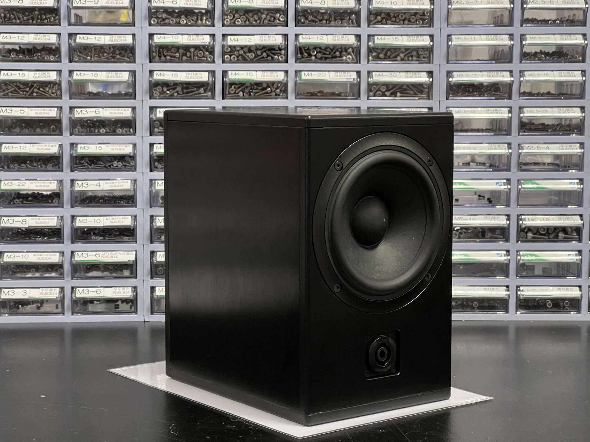

I assembled a prototype.
Enclosure parts are all anodized aluminum and the waveguide is 3D printed (SLA).
The tweeter is SB26CDC-C000-4, the woofer is SB15CAC30-4, and the passive radiator is SB13PFCR-00.
I call this speaker CA5 (Ceramic+Aluminum+5" woofer).

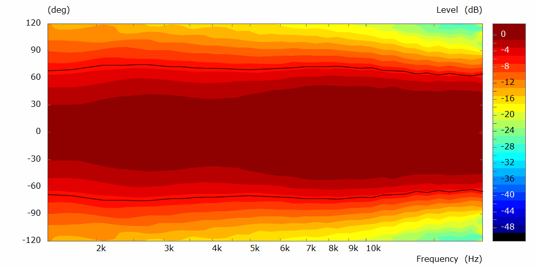

I will upload the measurements soon.
Here's a rendering versus a real picture comparison.

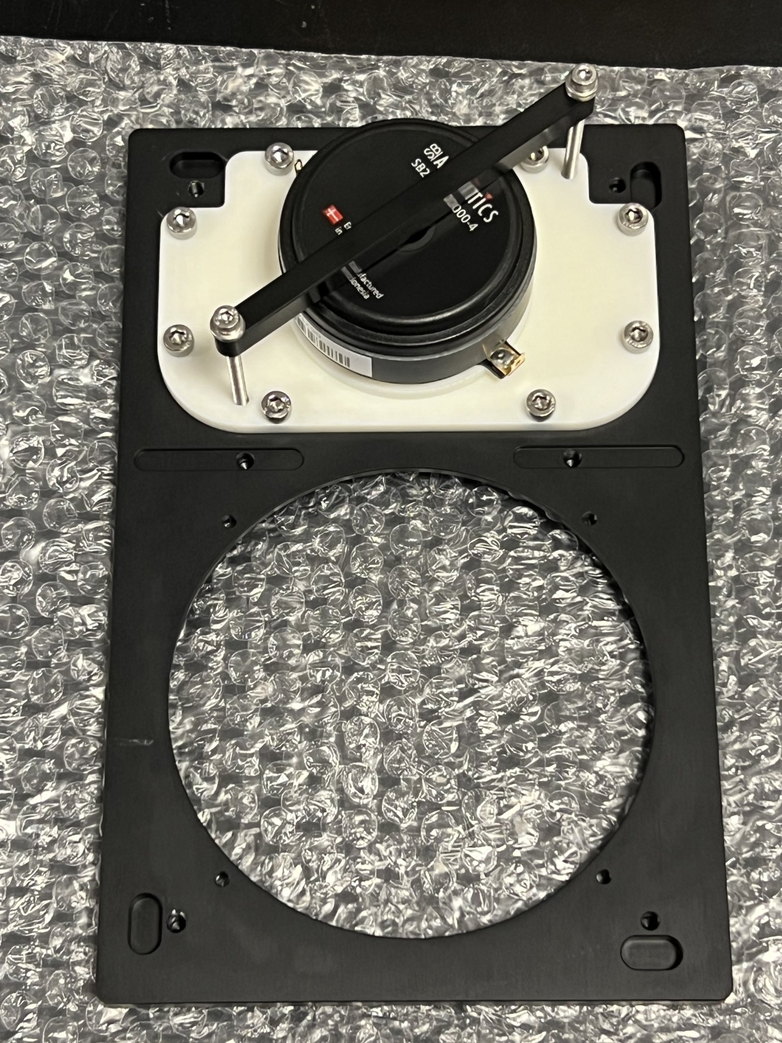

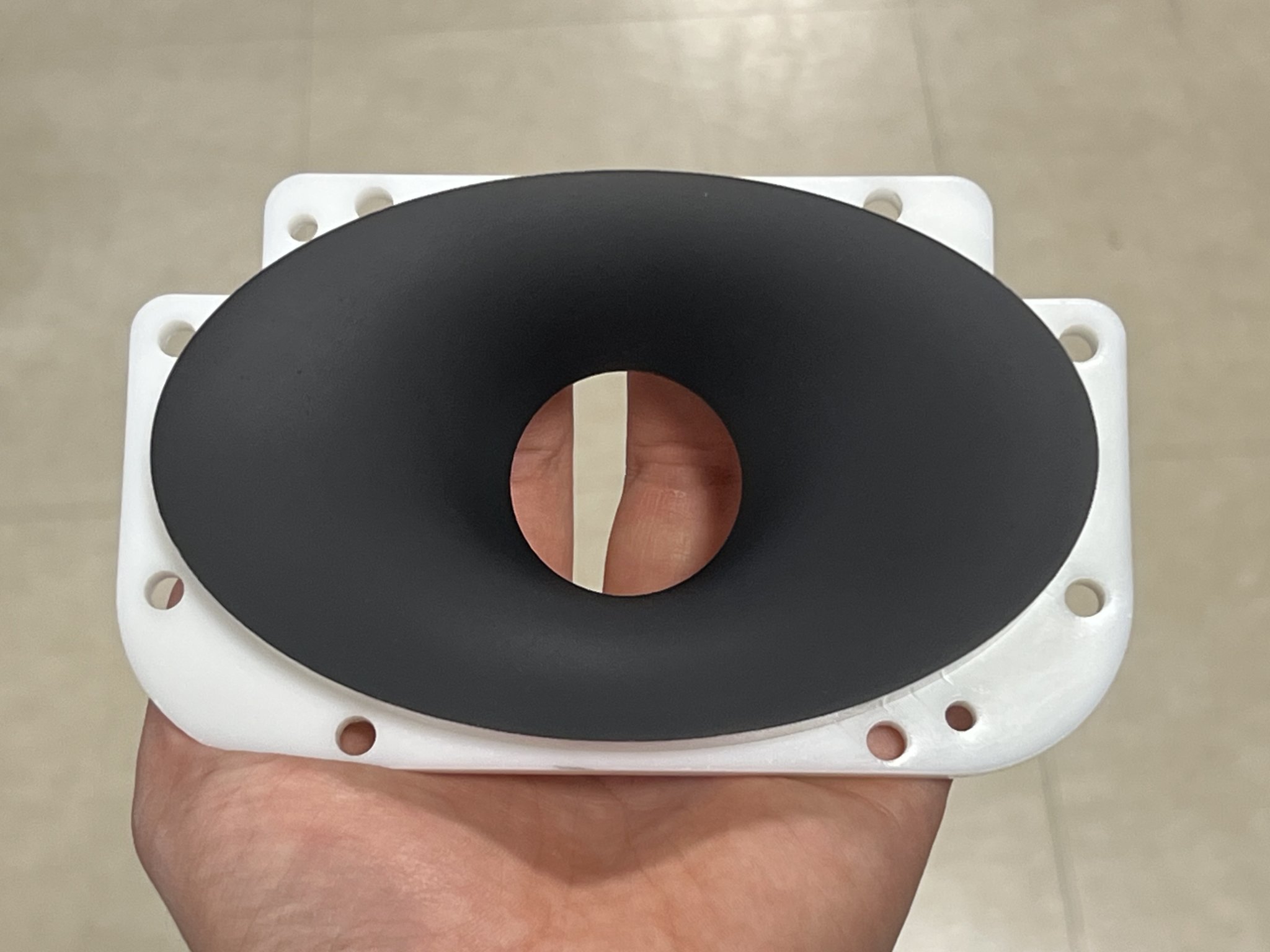

Yes, this is your waveguide.Awesome! Is that my waveguide? If so, did you use my routing template or make your own?
The routing template was not used because the baffle was made by a CNC specialist.
I changed the shape of the waveguide as follows so that the head of the screw is not exposed.

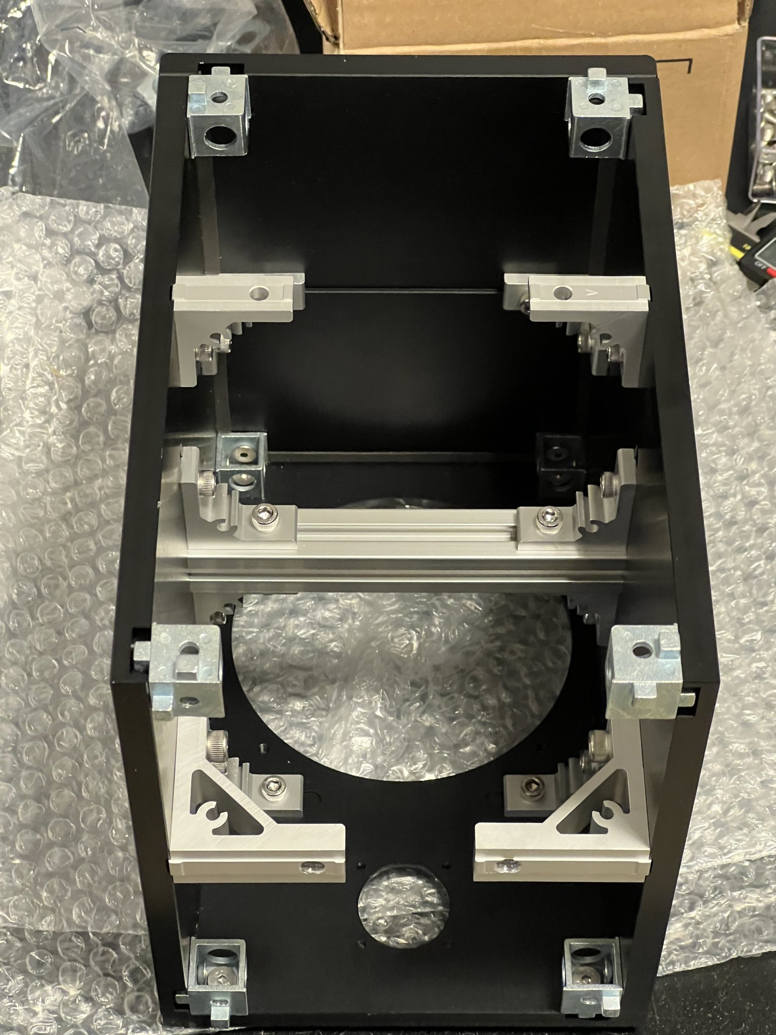

I used 1 aluminum profile as bracing.Did you go with bracing inside too, or just rely on the stiffness of ali?
It was used for the convenience of assembly.
I don't know if there's no resonance even without bracing.

I was just curious how you get the finish of the waveguide so well done, but than I saw got it with a SLA printer.
That makes aaaaallll the difference.
Unfortunately not cheap to get it done by one of those print shops. 🙁
Since you used a PR with the same SD as the woofer (as well as roughly the same xmax), I also assume that this speaker isn't designed to go very loud?
