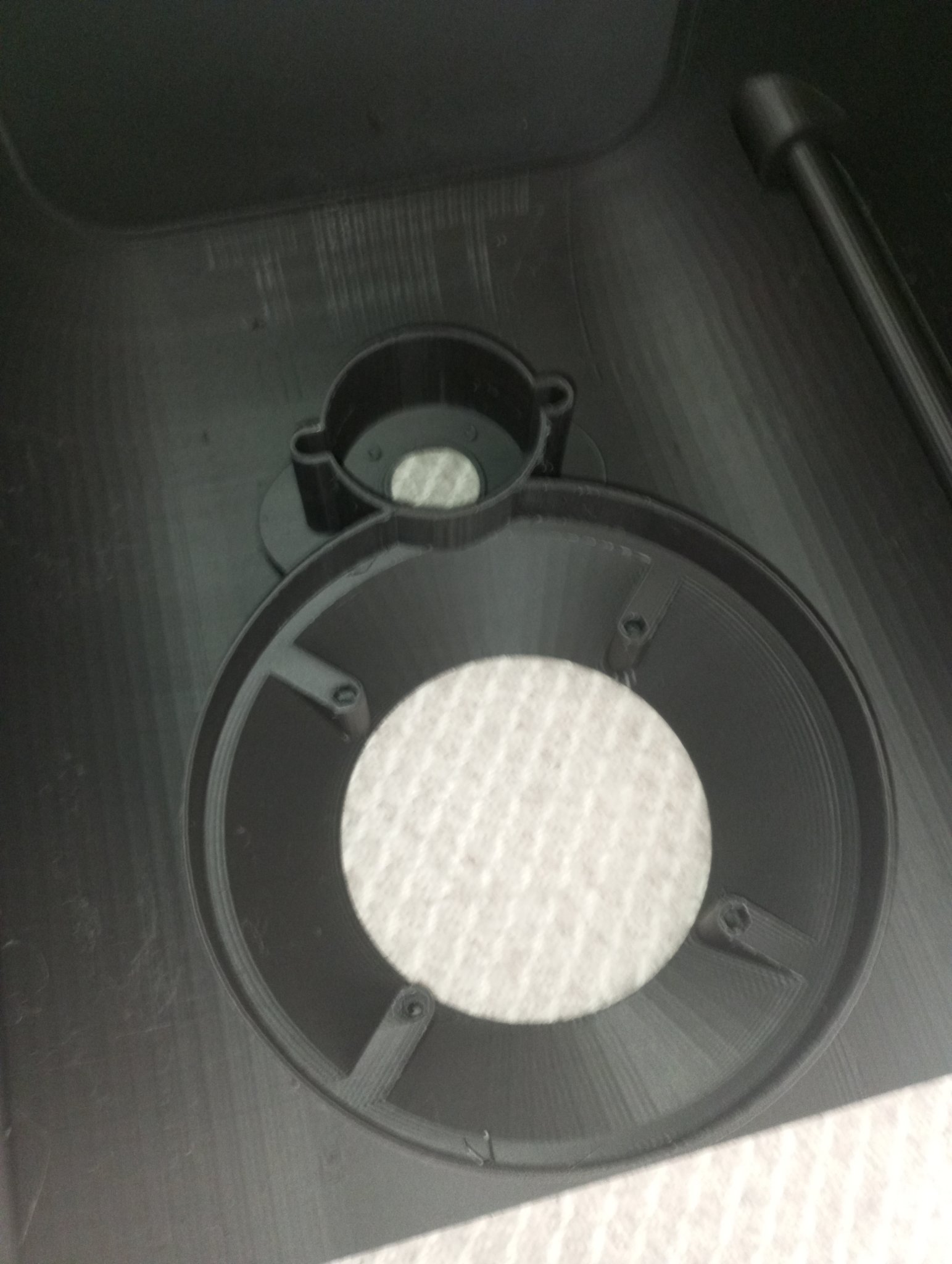

Wow that was fast! i think i placed the order exactly 48 hours ago and it's on its way to me now. They even included a couple of pictures! Looks a bit rough but nothing a bit of sanding and painting can't fix i suppose
If you want a nice finish gotta pay more or use resin take a high build primer spray it on sand spray more sand and paint should look good.

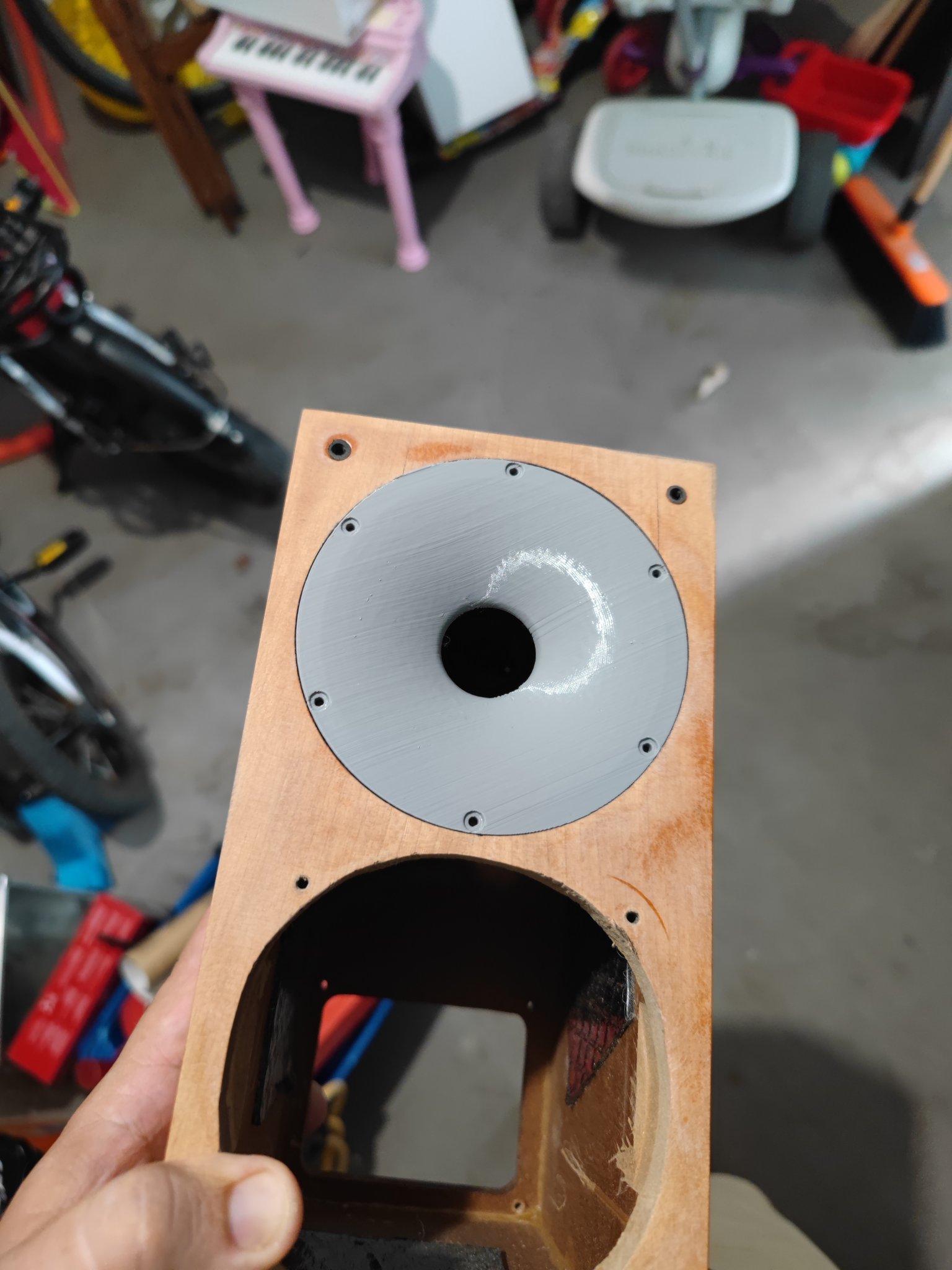

I personally printed mine at a different orientation - standing up on edge with supports. It made the finish much better, so much so that it won't require excessive effort to finish.Wow that was fast! i think i placed the order exactly 48 hours ago and it's on its way to me now. They even included a couple of pictures! Looks a bit rough but nothing a bit of sanding and painting can't fix i suppose
I've tried all the possible orientation and the standing up on edge with supports gave me the best results.
Interesting - would not have thought about that. Why is the surface better that way? Do you have a photo?
Resin is a bit overkill IMO for this situation, unless you don't plan on painting/finishing it. Even still, a properly printed FDM waveguide should be just as good for the situation.

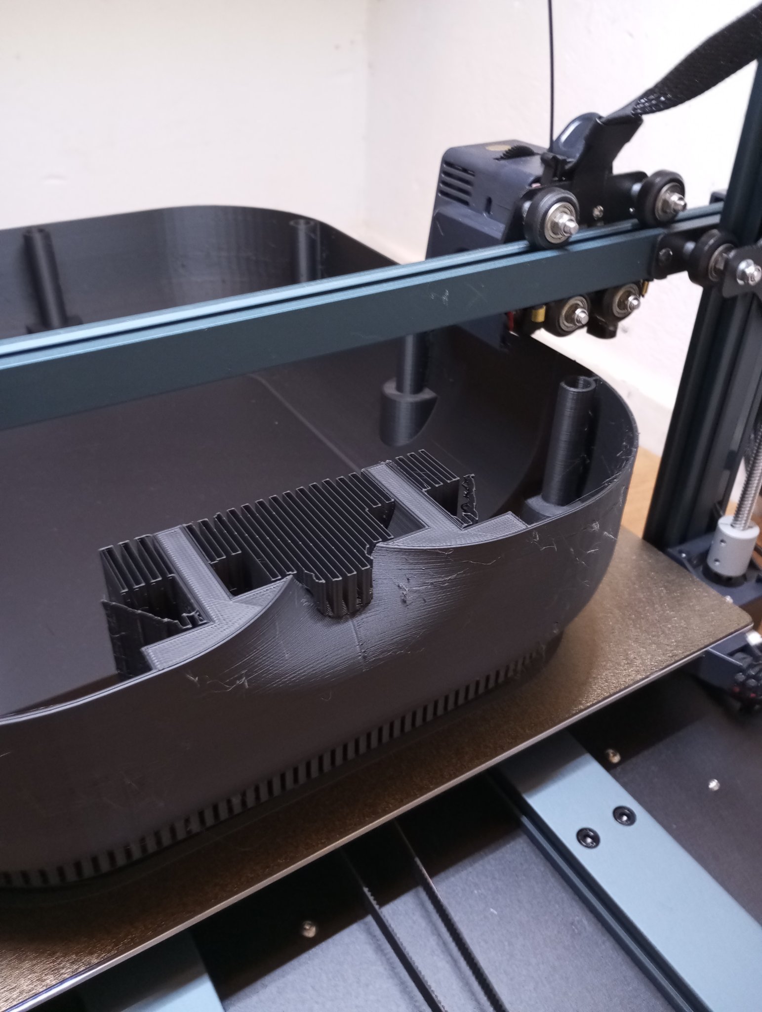

Well... I ended up ordering the biggest 3d printer I could find for a reasonable price with the intention of printing the whole speaker cabinet (with waveguide incorporated) in two parts and then filling them up with epoxy granite (sand mixed with epoxy) and then screwing them together. Easy to get carried away with crazy ideas while reading this forum and this thread in particular hehe.
This was also printed standing up and I can now vouch for printing the waveguide standing up, gives a far better result, will attach a picture of the waveguide in the printing process so you can get an idea.

And just for comparison's sake, here is a pic of the waveguide printed lying down (it has also already been sanded a bit)

Awesome concept! are you also printing an inner shell for the resin to reside in? Or is it a thick epoxy that you can just lather on?Well... I ended up ordering the biggest 3d printer I could find for a reasonable price with the intention of printing the whole speaker cabinet (with waveguide incorporated) in two parts and then filling them up with epoxy granite (sand mixed with epoxy) and then screwing them together. Easy to get carried away with crazy ideas while reading this forum and this thread in particular hehe.
I've thought about doing a filled-printed cabinet, but I'm not sure how the fill material will interface with the printed plastic, or if any sort of delamination would cause future resonances.
So far my fully 3d printed cabinets have held up with no changes to structure or coloration.
