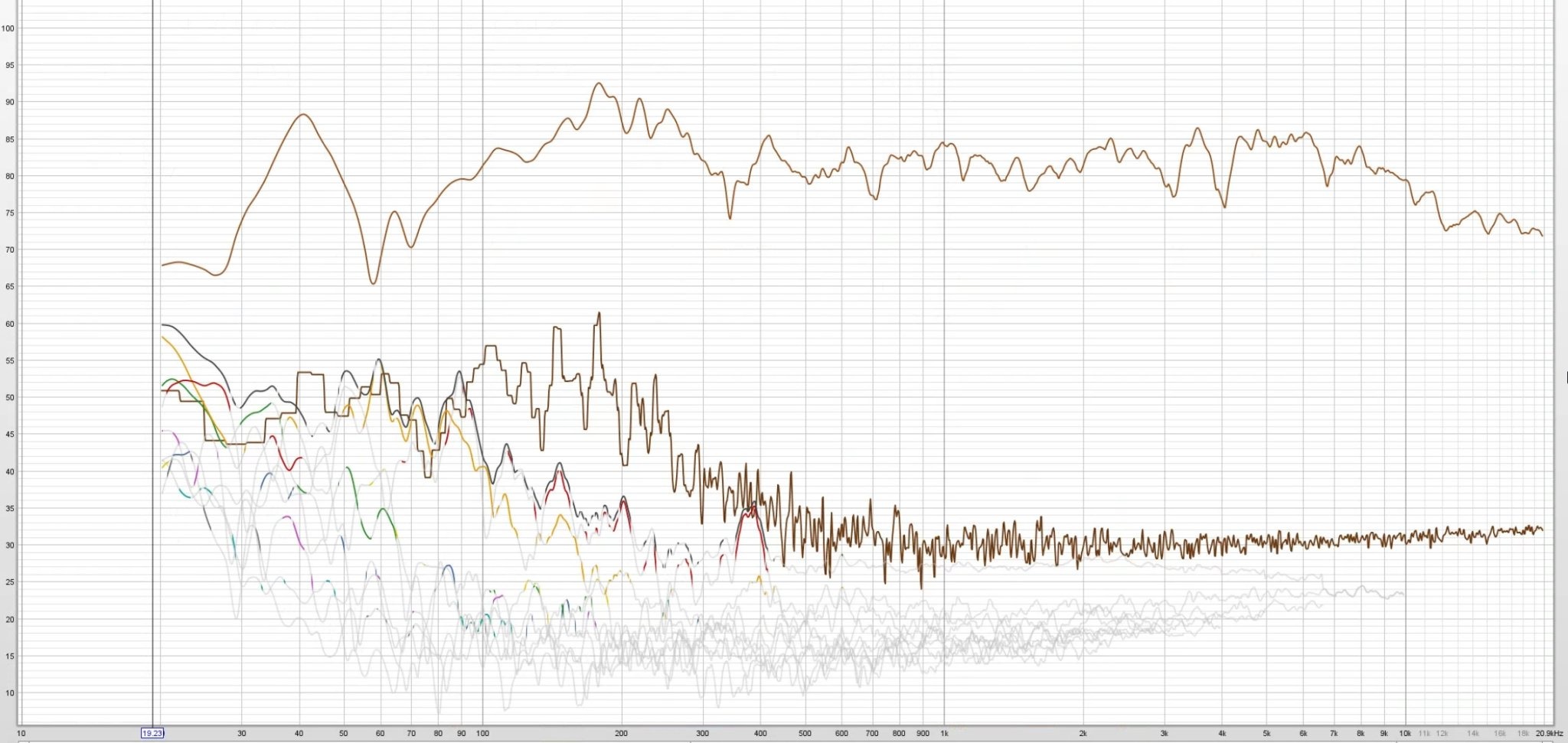

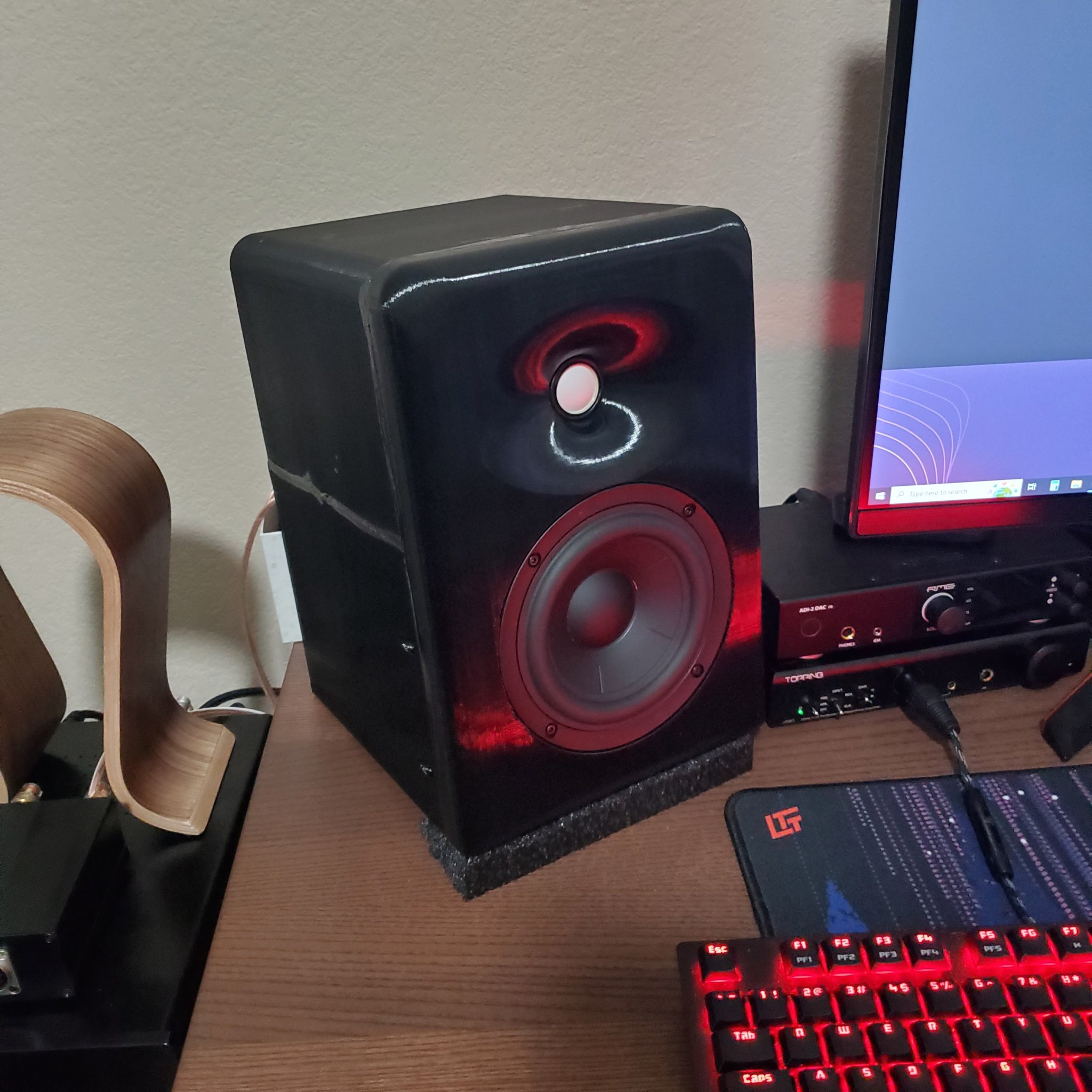

He's an over due update on my 3d printed enclosure using Augerpro's SB26ACD waveguide and the SB15CAC woofer. I made a quick and dirty crossover and took a few measurements at my desk to see how it measured:
It's a 10" x 10" x 12.5" box, with a 7" x 1.5" port in the back. It's not fully closed in the back because I'm still waiting on the binding post bracket to get in, so the bass measurement isn't accurate.
Over the next week or so I'll take some ground plane measurements in my garage and tweek the crossover.

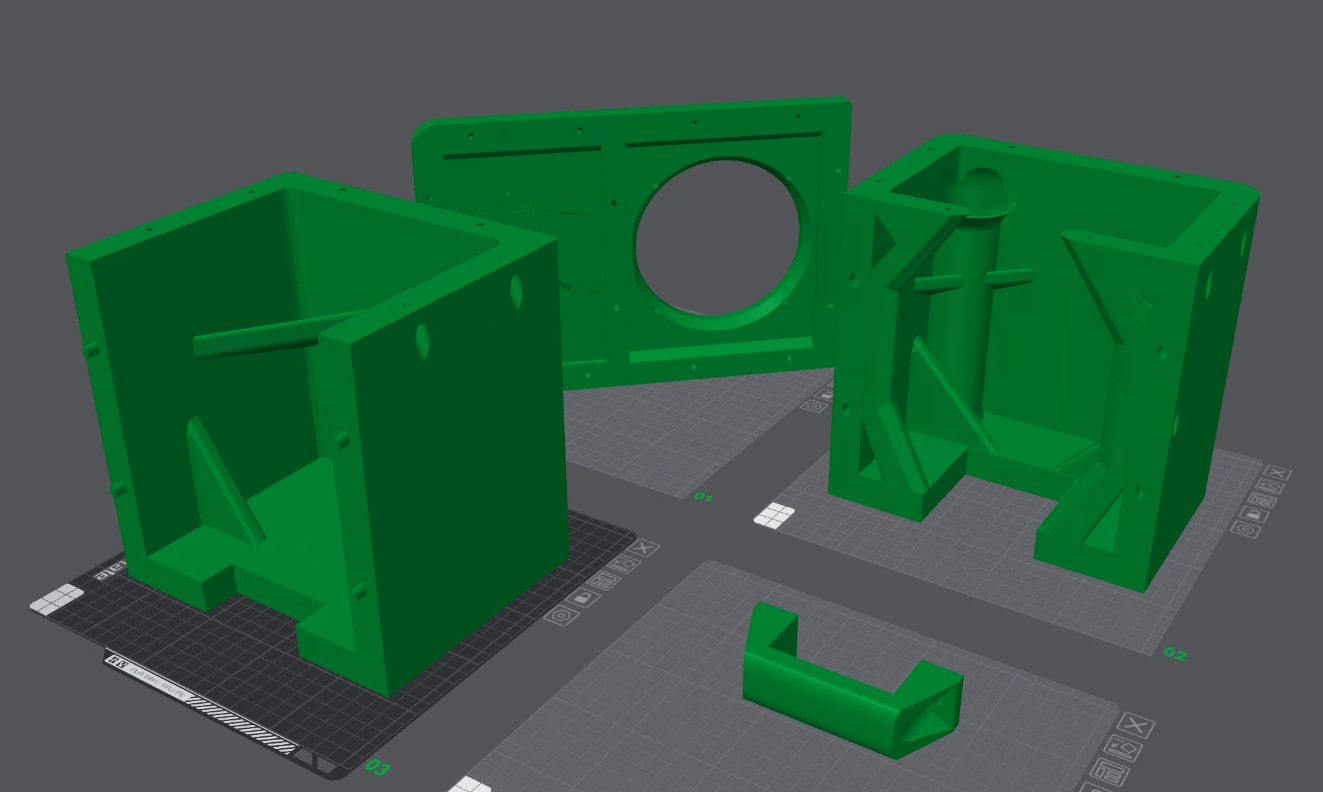

Yes, that would certainly be cheaper (and was my original plan, since I have used that method on other speaker designs), but I wanted to design a cabinet for those with 3d printers but limited access to power tools. Personally, it's been over 100f (38c) in my garage for the past month, so I decided to make the entire enclosure, with port and internal bracing, through 3d printing. Once I get a final version designed I will post a link to the files so other 3d printing enthusiast can try it out, but for now here is the current design I am working with:Kudos to that!! a passive DIY version of the KH120.
@chargedcapacitor very nice indeed! The complete enclosure is 3d printed? wouldn't be better from a structural POV to have 3d printed only the fascia of the baffle with the waveguide included?
I am no native english speaker, but I will try to explain... Imagine an MDF box and the baffle has a "portruded" circle where the woofer is mounted (maybe 2-3cm over the level of the baffle), and then you mount a 3d printed "fascia" with the waveguide included (you can even consider a closed compartment for the tweeter and avoid cabinet resonances escaping thru the tweeter). The fascia is 2-3cm in depth so its on the same level as the woofer. With a 3d fascia yo can make the roundovers you want and even make a smooth transition from waveguide to woofer, but with the cheapness and ease of an MDF cabinet.
The two big cabinet parts can be printed with no supports, but the front baffle will require them. I also included a bracket for the tweeter, since removing the included mount plate leaves it with no way to attach to the baffle. The first two cabinets I built have been bonded together with JB Weld, but in order to test out baffle shapes for the next few designs, I will fasten the front plate with M3 screws and heat-set nuts.

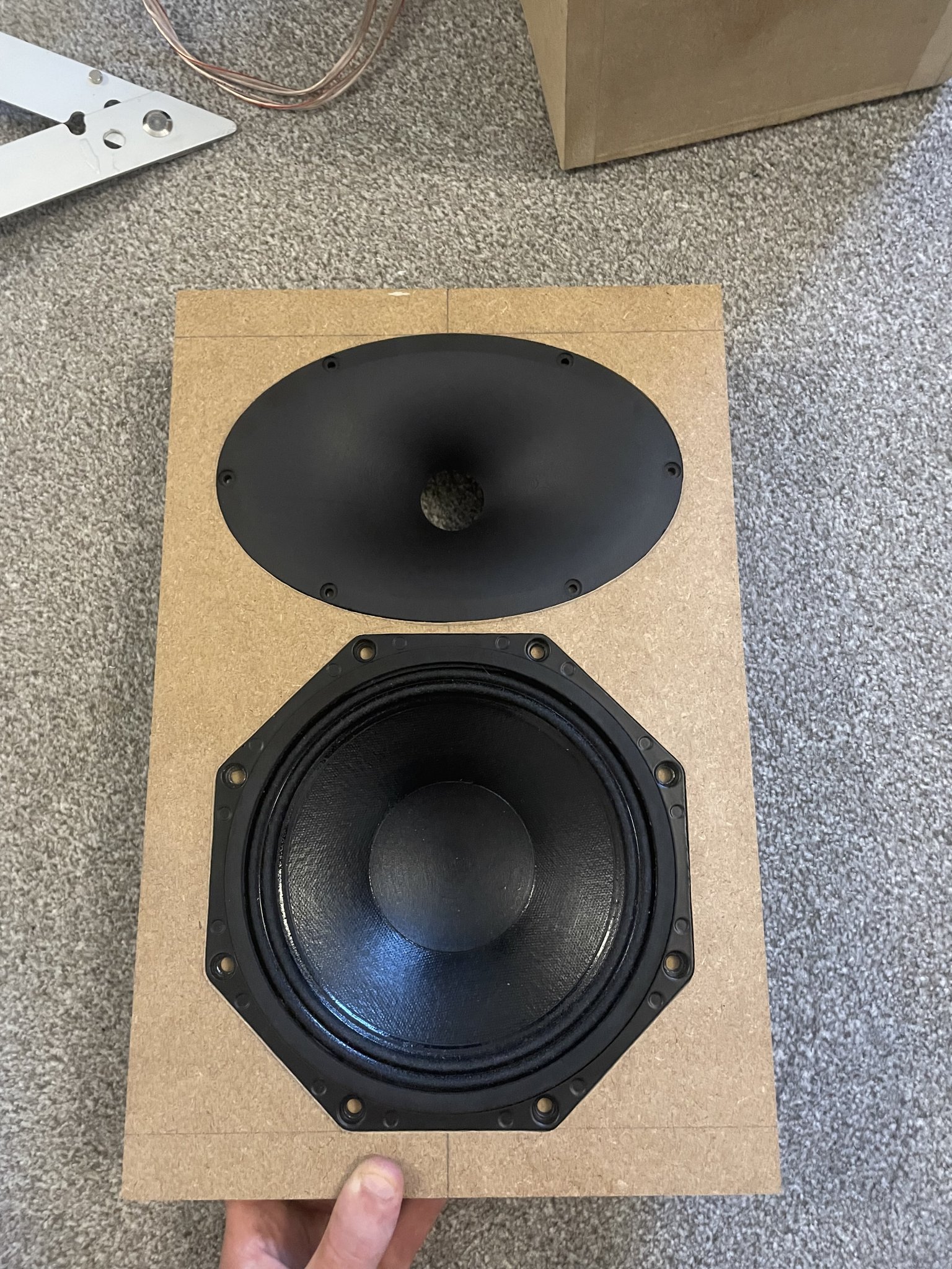

In my first picture it is visible that I positioned the waveguide and woofer CTC as close as possible for the sake of the vertical directivity. Since reading Augerpro's simulation of having better directivity with the CTC distance between 7 and 9 inches, I pushed the woofer and WG as far apart as possible in my current design.
Once I get settled on a design for this larger three-part enclosure, I plan to make a smaller, more rounded and attractive two-part enclosure (a la Sonus Faber Sonetto). Essentially, something that would fit better (and look better!) around a computer monitor.
@chargedcapacitor I'm using a ctc of 1.2x the crossover frequency wavelength. Your ctc would be different if you were using a different crossover frequency (2.4khz)

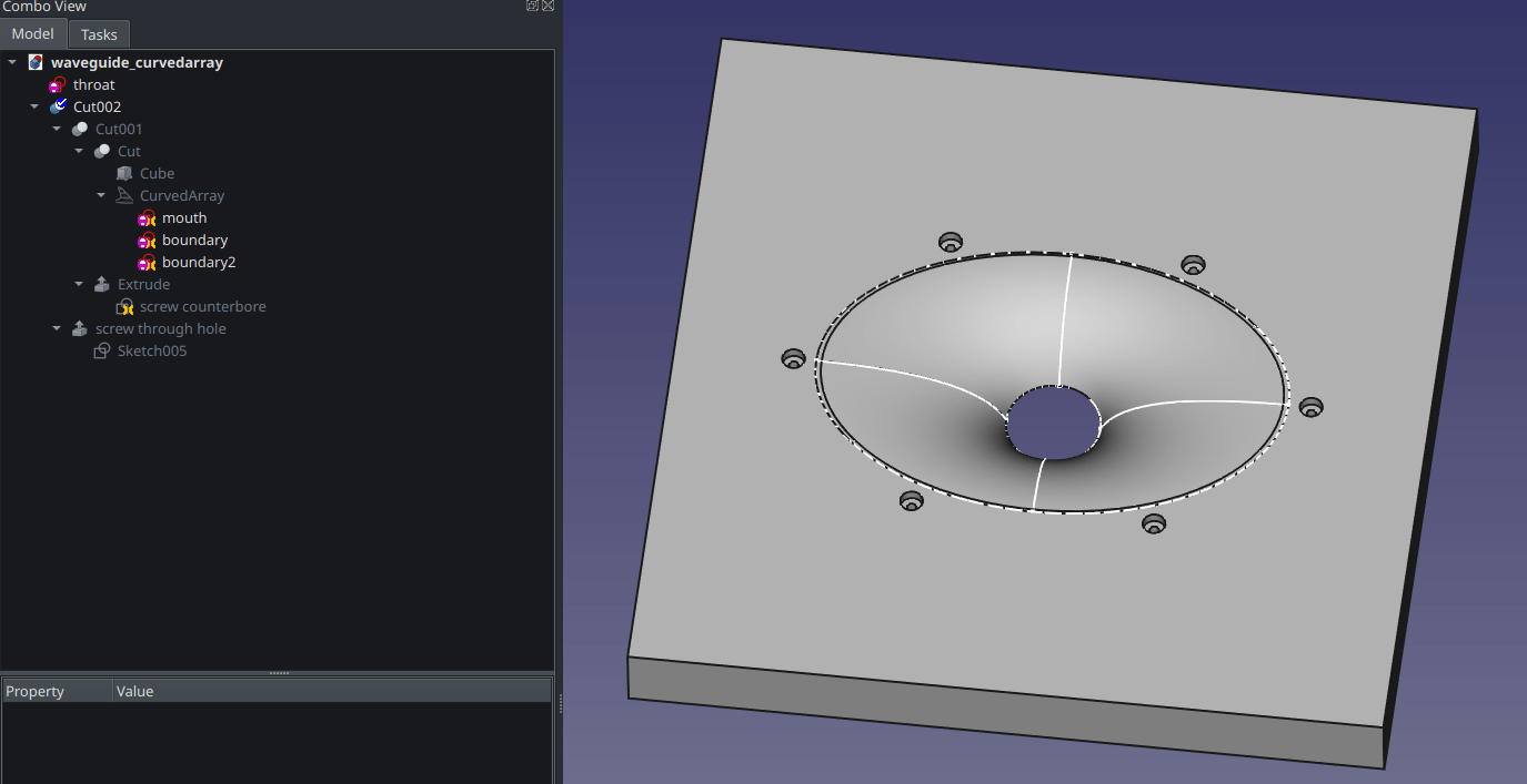

This is probably as good a place as any to share this file. It is a simple waveguide file for FreeCAD that allows easy modification of throat, mouth, depth and profile. Should be straight forward for anyone familiar with FreeCAD, simply modify throat, mouth, and 2 boundary sketches to define the shapes. Created for FreeCAD 0.21 with "curved shapes" add-on for the curved array.
Modify as you see fit for 3D printing or milling.

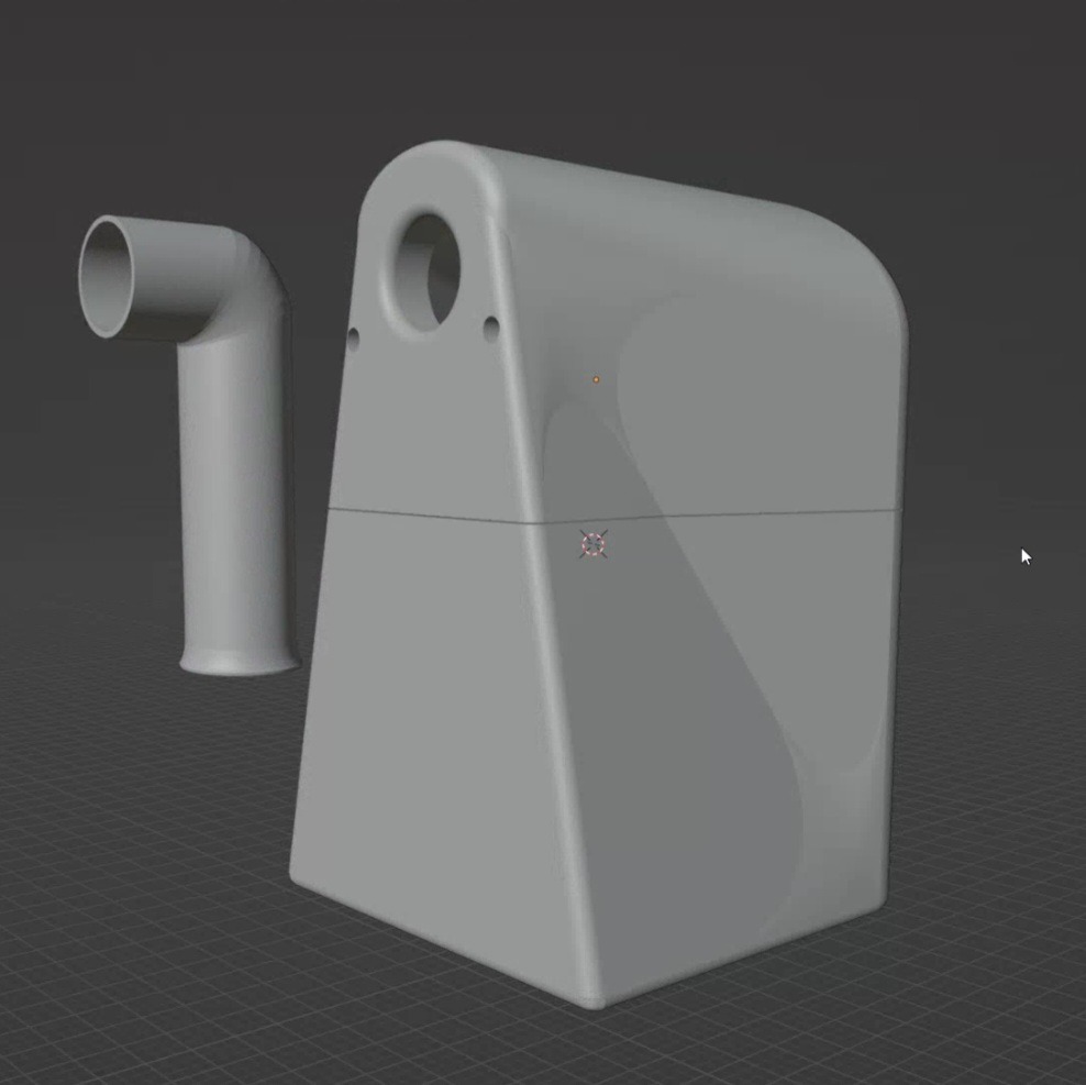

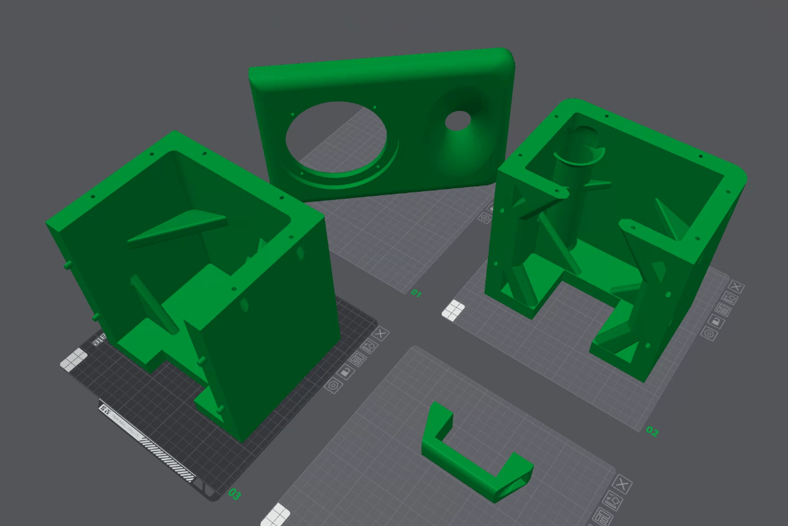

Here's a smaller two-part print design I've been testing:
My theory behind this crease/fold in the side was that it might give the cabinet extra rigidity, while also creating a more decohering panel resonance, should there be any (I don't know enough about cabinet resonance and it's importance to actual audibility to make a real claim!). And I think it looks nice 👍.
