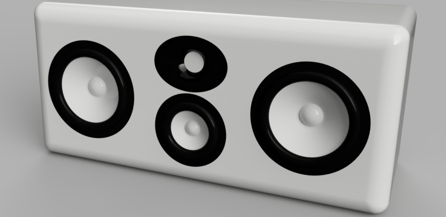

Also notice the width of the nulls in the Directivity window. The higher ctc actually creates much narrow nulls. True it is closer to on-axis, but smaller nonetheless. So the question becomes, for critical listening, how much do those nulls aimed over youf head and at your feet really matter? More than actual first reflection from the ceiling and floor that is aimed at your head?
Again I will leave the closer driver option open to people, but then you will get marginally better-than-M126 performance, instead of much better performance. That's the idea anyway.

Basically you get better on-axis and first reflections, at the expense of a narrower vertical sweet spot. I assumed March Audio and Buchardt were forced into this ctc distance given their circular waveguides, but the when you see their crossover points of 2.4-2.5khz, I think they are optimizing in the same way I am. It's been a hard perspective change for me, but listening to two prototypes the other day with the two different ctcs seemed to confirm the improved measurements are worth it for critical listening. If someone really needs the closer spacing for casual listening laying on the couch, I'm going to include an option to move the woofer up.
I should add the above is with an 8" ctc. I backed off to 7" simply out of fear I was going too far. Even though my listening tests didn't turn up any issue. So I do expect the final design may not be quite as good as the above plot, but I'll be more confident that the vertical sweet spot will not be issue for people in critical listening either.

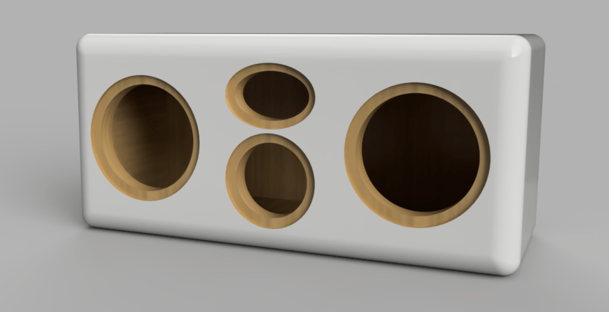

Not the final layout. I have to do some modeling in VCad to optimize the polars.
If the cabinet is going to be 9.5” tall, any plans to cram a pair of SB23CRC in there?

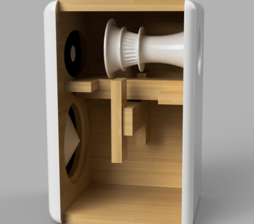

So, if close CTC distance is not desirable, then what's the point of the elliptical waveguides?
Circular WG looks better on it's own and also on the baffle when paired with mid(woofer) and we don't need to see the (IMO) ugly unused space between the drivers if we want larger CTC distance. The dispersion of a good circular WG is also more uniform than of an elliptical.
1) maximum flexibility for end users
2) some tweeters measure better on ellipticals, some on circular, so there may not be a choice
3) MTM still benefit from very close spacing
4) is uniform what we always want? Maybe some would like a bit more constrained vertical response that ellipticals provide
