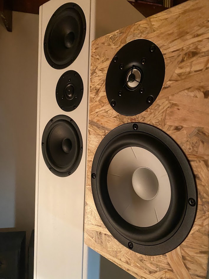

I'm far from box alignment expert, but have experience with these drivers in 14 liters. I'm currently (for one year now) listening these in this contruction and yes, they can't do low bass although they are tuned low. It is really nicely designed speaker, but it can't do miracles when asked to pump deep bass. And since SB17CAC (like all SB 5 and 7 inchers) is very compliant it is easily to drive it to mechanical limits. For me it was surprise how soft these hard cones sound, even at the edge of the limits. I don't know if this is because of high crossover frequency or low distortion of both drivers, but this is very prominent characteristic. I want to try both drivers in big three way and with your waveguide for tweet...I think that SB17cac will be great mid above 200-300 Hz... In direct comparison with Satori MW16P - Satori is colder sounding, more transparent with high resolution and crazy dynamics and two pieces per speaker can can go really loud with deep physical bass. Satori motor is from another league.
The Satori MW16P got an issue at approx 1khz due to the rubber surround. Troels dampened this by some glue-mixture on the transition surround/basket.
We made a MTM with the MW16P some time before Troels got this idea. We had to implement a fix by passive components to suppress this peak (cold sound).

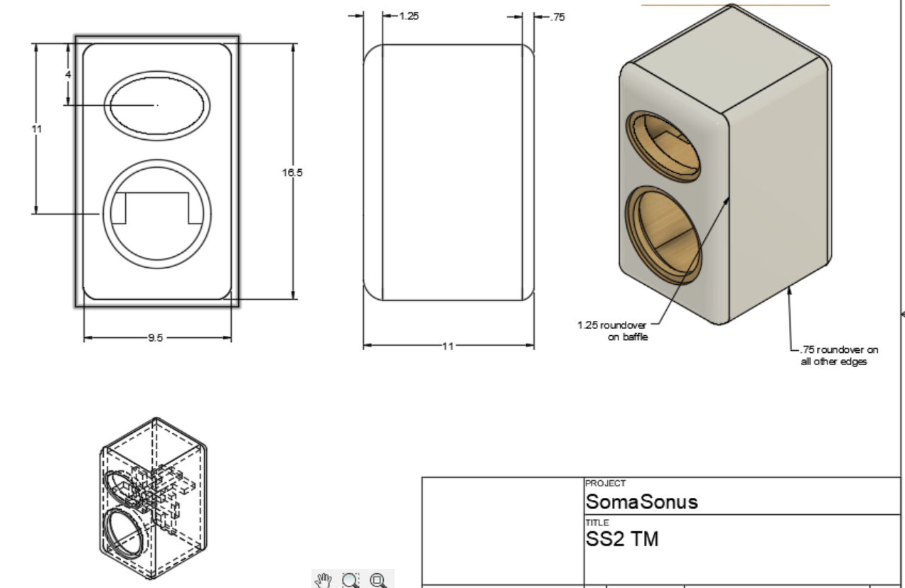

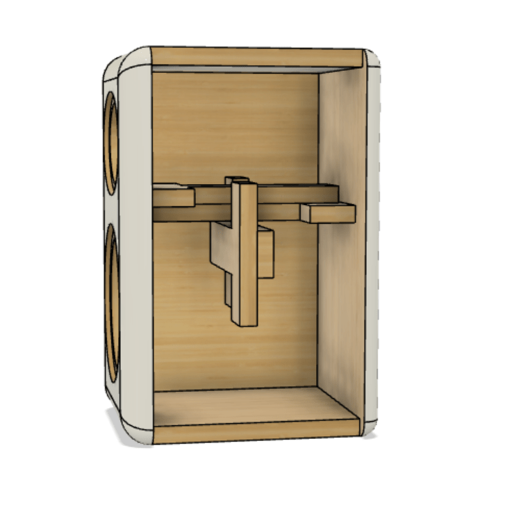

I've finalized the enclosure volume for the ported version. It's just slightly deeper than the sealed version I've been listening to. FINALLY delivering a final design after working on waveguides for 6 years! These will use the CLD braces from my testing. I've backed off on the ctc distance a bit. I could get pretty close to the same ceiling reflection, but with slightly improved vertical sweet spot. I'll start modeling the center channel now that I have the basic design elements decided. Thanks to @bikinpunk for measuring the eraly prototype and helping me validate the performance.

Erin> depends how you define improve. I'm defining it as smoothest ceiling and floor reflection, and overall smoothest DI. This comes at the expense of vertical sweet spot, but see the following sims that brought me to this point.
First is the current CTC distance, and crossed at 2.4khz. Note especially the lime line (ceiling reflection) in Power & DI window:
If I moved the drivers as close as possible, the result is this:
Lowering the crossover doesn't help either, moving to 1.8khz results in:
This is the ceiling bounce as defined by CEA2034, 40-60 degrees, you won't find this on a typical TM (at the average 50 degrees the response is basically flat - almost like a coincident driver!):
Basically you get better on-axis and first reflections, at the expense of a narrower vertical sweet spot. I assumed March Audio and Buchardt were forced into this ctc distance given their circular waveguides, but the when you see their crossover points of 2.4-2.5khz, I think they are optimizing in the same way I am. It's been a hard perspective change for me, but listening to two prototypes the other day with the two different ctcs seemed to confirm the improved measurements are worth it for critical listening. If someone really needs the closer spacing for casual listening laying on the couch, I'm going to include an option to move the woofer up.
