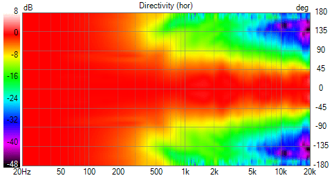

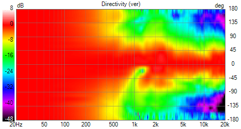

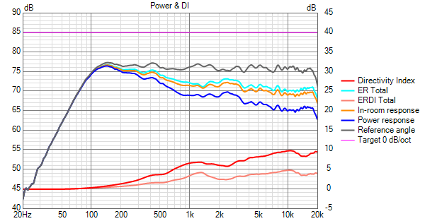

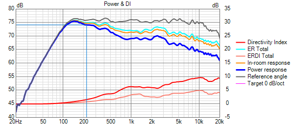

This is my current testing with VituixCad for my 2 way using Hypex FA122, B&C 8NDL51 and SB26ADC in 8" waveguide. Not perfect but getting there. Crossover 1.2khz LR 4th, the SB is one robust tweeter. I'm really enjoying listening in mono, its going to be strange going back to stereo once both are built.

It looks like you didn't compensate for the mass roll off of the driver in the waveguide so the onaxis and everything else is dropping off above 10K. Maybe this was intentional or not. A first order filter from 10K or above usually compensates this and flattens the response out. I would also try to avoid a power response peak between 2 and 3K.
Yes you ideally want a smooth progression down without any peaks, it maybe difficult because the directivity is dropping at that point, the on axis is relatively flat and it is quite a way from the crossover point. It may be worth trying a small on axis dip in that region to smooth out the power and trial it both ways to see what you like best. Generally if EQ damages the on axis but makes everything else better it is a good trade, if you are listening out into the room and not close in.
I tried the on-axis dip to flatten the power response, I couldn't really hear much of a difference, the total SPL difference (highest and lowest spl) is 2.3db, power response is around 2.7db variation or +-1.35 which is good enough for me!
You definitely should be able to hear a >2dB broadband dip in direct & fast comparison. Maybe try a more broadband music signal (electrical guitar is great for that) or just for checking if everything is ok pink noise. Also maybe go closer to the speaker and there should be a quiet environment of course.
