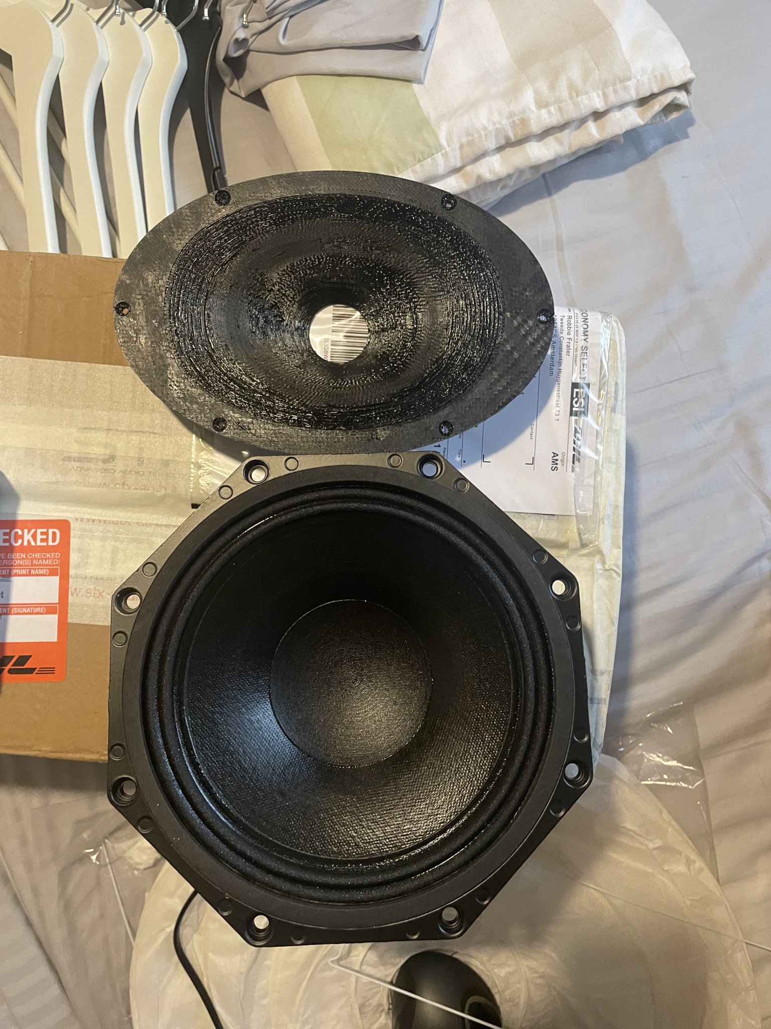

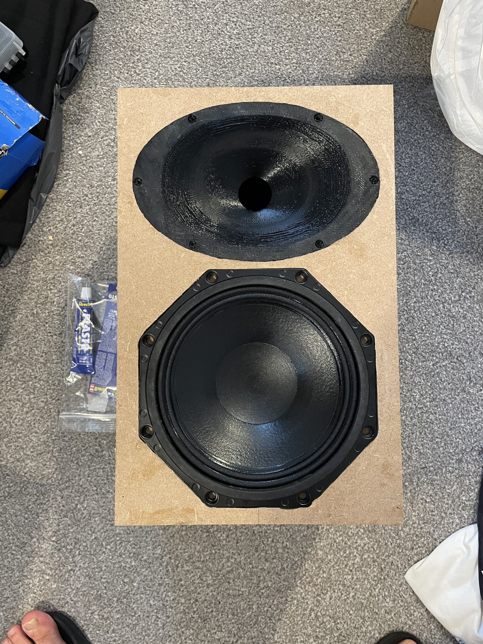

For me the price difference isn’t too much. The total cost for the DIY is around £600 per speaker compared to £490 per Genelec. Here is how the prototype waveguide looks and the woofer, I plan on building a test box soon. If I am happy with the performance I’ll either use a better printed waveguide, sand and try to make use of the current waveguide or get the front baffle CNC from MDF with the waveguide integrated.@monty6400

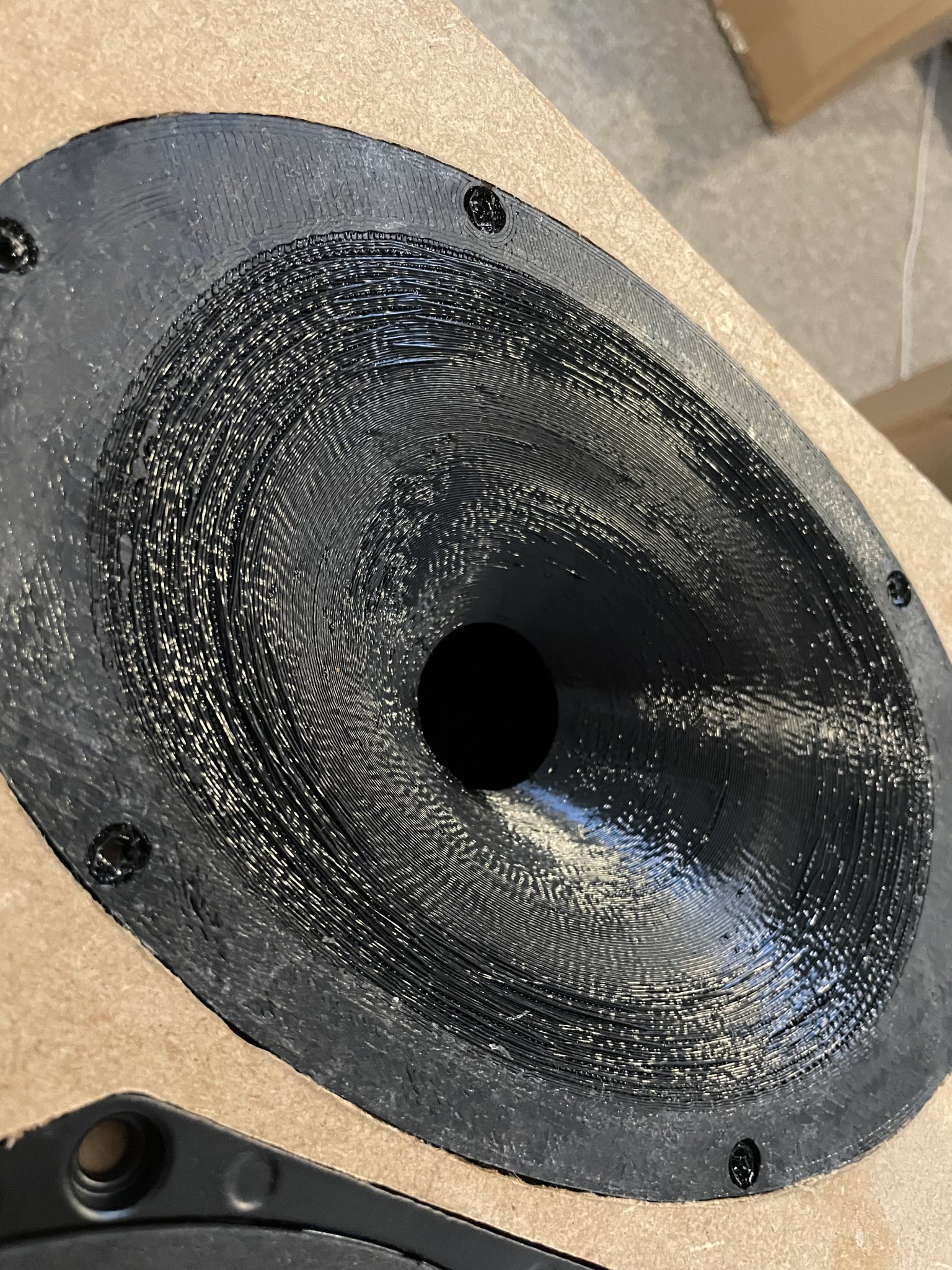

Does anyone have any tips for using Revell Plasto for smoothing out my waveguide. How to apply, how much to apply, all over? And what sandpaper to use? Thanks guys!
This was just a cheap test print from an online website, I was just wondering if there is anything I can do using the Revell to smooth it out a little!
It does look like they printed it with the mouth down on the bed which is why the inner contour is so lumpy. There is going to be a lot of work to sand and fill that out.
If you want to continue with what you have start with coarser grit like 80 or 120 grit to remove the material more quickly to get to the point you want add some filler, then fill sand, rinse repeat until the surface is getting smoother progressively working through the grits. Stop when you have had enough or the surface is smooth enough for you.
If you have or got some scrapers the process would go quicker
Thanks for this, I’ve sanded a little and added some revel plasto and will sand again tomorrow using fine grit, this is only a prototype so not too concerned atm! What grit would you recommend for a fine finish?

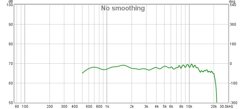

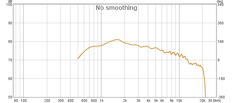

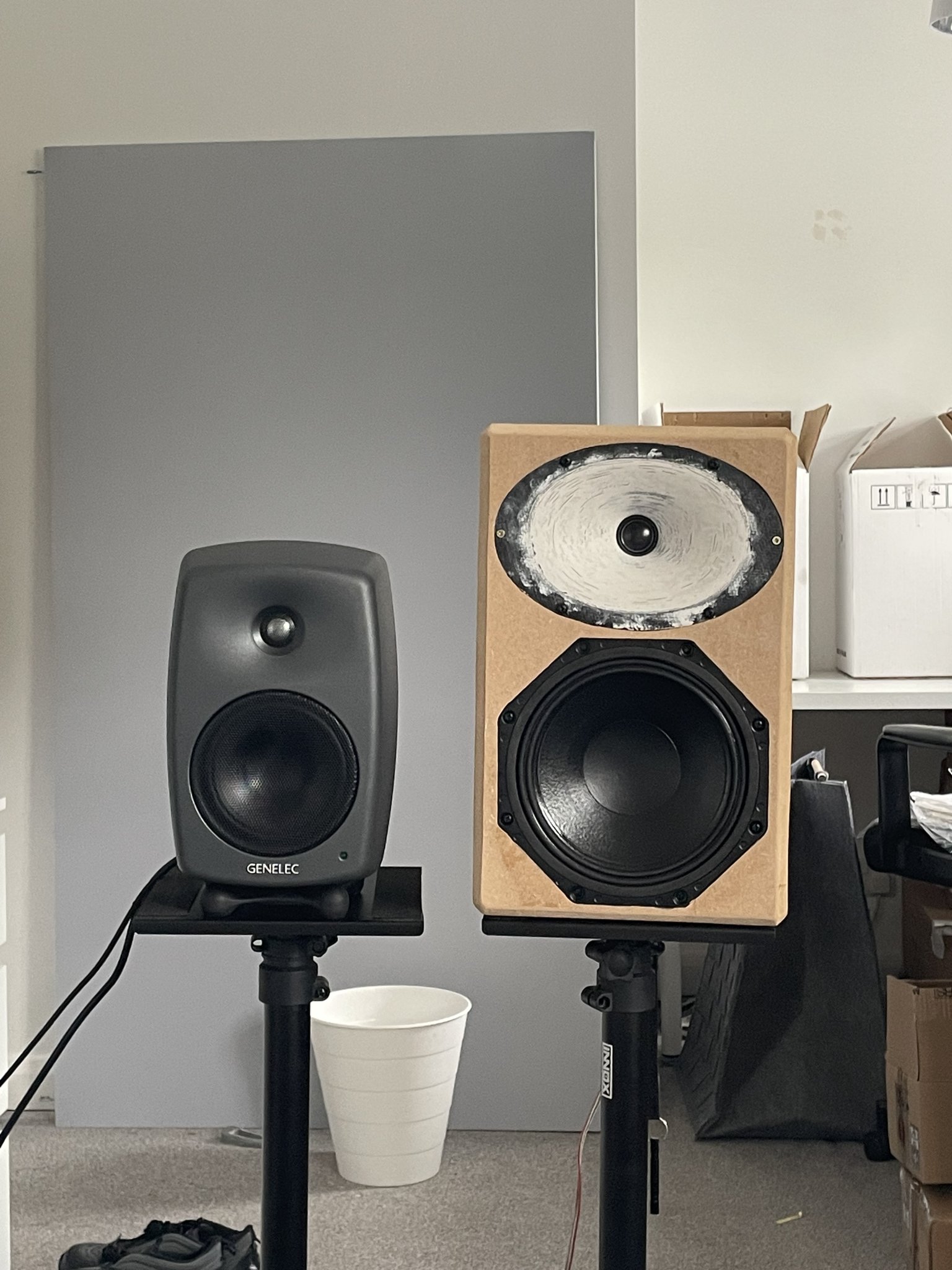

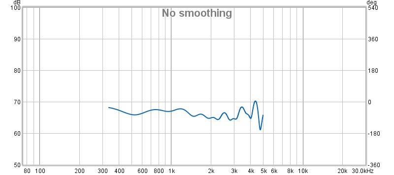

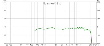

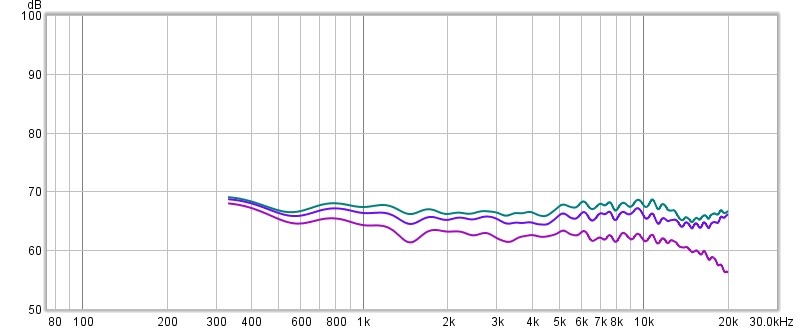

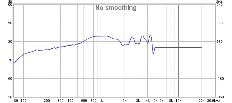

Prototype box completed and some very rough REW EQ and time alignment. Measurements performed inside. Unfortunately this meant a 2.8ms gate on the measurments due to reflections, I plan on taking this outside and using VituixCad when the weather permits. Looking promising so far though. Did some mono-listening with a Genelec 8030c side by side, both high passed at 120hz. They sound more similar than different, although so far I would say I can here some resonance from the DIY box in the 400hz ish region. Will do proper distortion measurements when outside. (Far = farfield near=near field for the picture labels).
Don't write off those Peerless woofers because they are cheap.with a cheap peerless woofer
There are quite some extremely well known and respected brands out there that basically use exactly those woofers, or a derivative from it. (even shown in this topic in a nice grey finished box)

I do sanding and the use spray filler, 2-3x. This fills pretty good and you are free with the next layers of colour.Does anyone have any tips for using Revell Plasto for smoothing out my waveguide. How to apply, how much to apply, all over? And what sandpaper to use? Thanks guys!
With some fine tuning of my print configuration I get way nicer surfaces now. Only needs a few minutes sanding (but starting rough, 60-80. Not to much pressure. 120 as last step is enough for the spray filler)
You probably already know this, so apologies for telling you how to suck eggs - Those wiggles between 6-20k are possibly just your mic/boom setup so no need to try and correct those.Prototype box completed and some very rough REW EQ and time alignment. Measurements performed inside. Unfortunately this meant a 2.8ms gate on the measurments due to reflections, I plan on taking this outside and using VituixCad when the weather permits. Looking promising so far though. Did some mono-listening with a Genelec 8030c side by side, both high passed at 120hz. They sound more similar than different, although so far I would say I can here some resonance from the DIY box in the 400hz ish region. Will do proper distortion measurements when outside. (Far = farfield near=near field for the picture labels).
