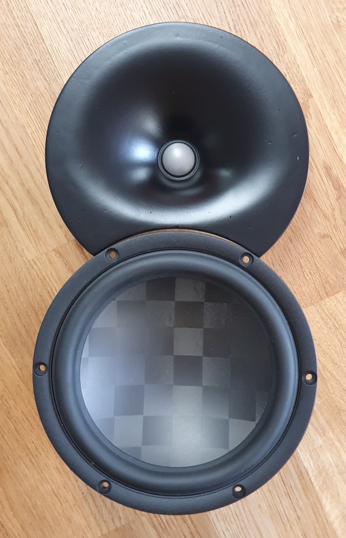

What do the waveguide Pro's here think about this design?
I want a close distance between the drivers but don't compromise the waveguide to much.
(This is a 3D printed and coloured prototype - the end version will be routed from wood)
You could put the waveguide just in from of the woofer, so the edge of the waveguide covers the mounting flange of the woofer, and meets at the surround.I want a close distance between the drivers but don't compromise the waveguide to much.
I have bad experiences with hard edges on the baffle like what you get when putting a flange or waveguide simply over some other driver. Therefore I normally just cut the frontplate of the drivers to get them closer.
The flange of the woofer also isn't straight - would mechanical not be easy to get closer. The contour now goes 1mm to the flange ... will do some measurements and find out if that's good enough.
