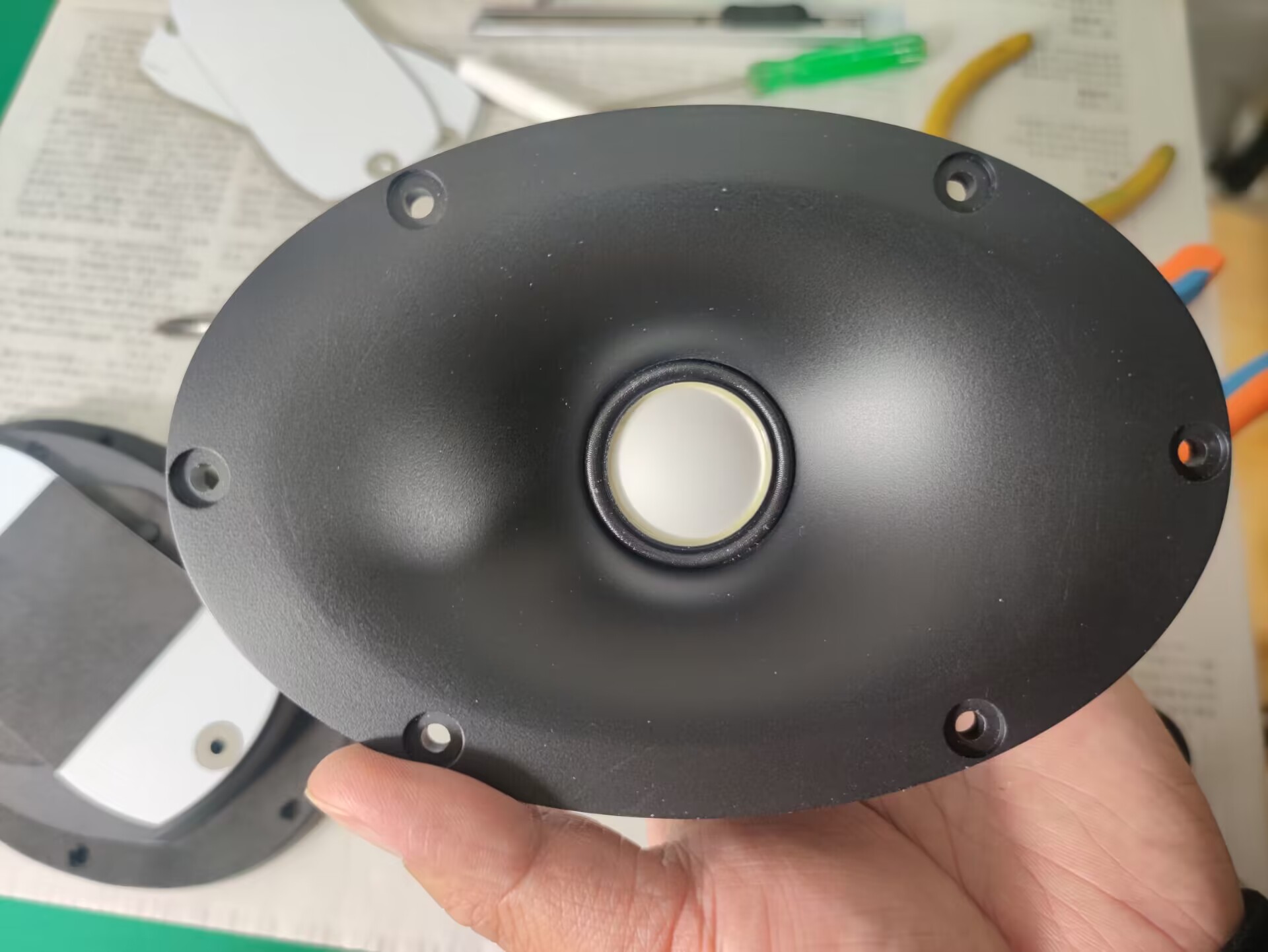

Yes, SB26CDC. Waveguides are not 3D printed, they are CNC processed. Because I found 3D printing too expensive... CNC can be at least half as cheap. However, CNC cannot process the central phase cover

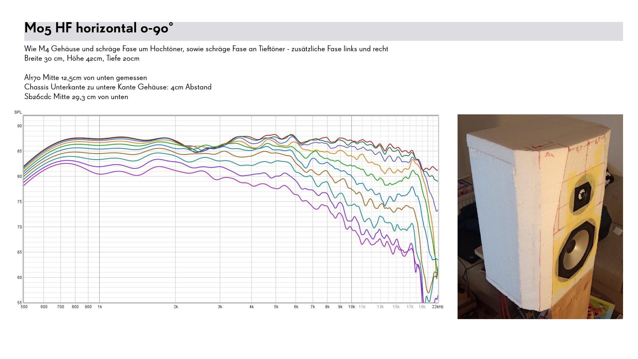

Hello augerpro, hello all,
I would like to thank you for your work and effort and for openly sharing your results with us here.

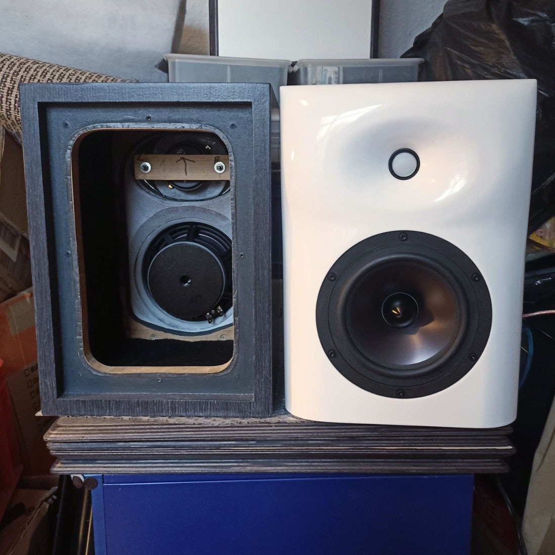

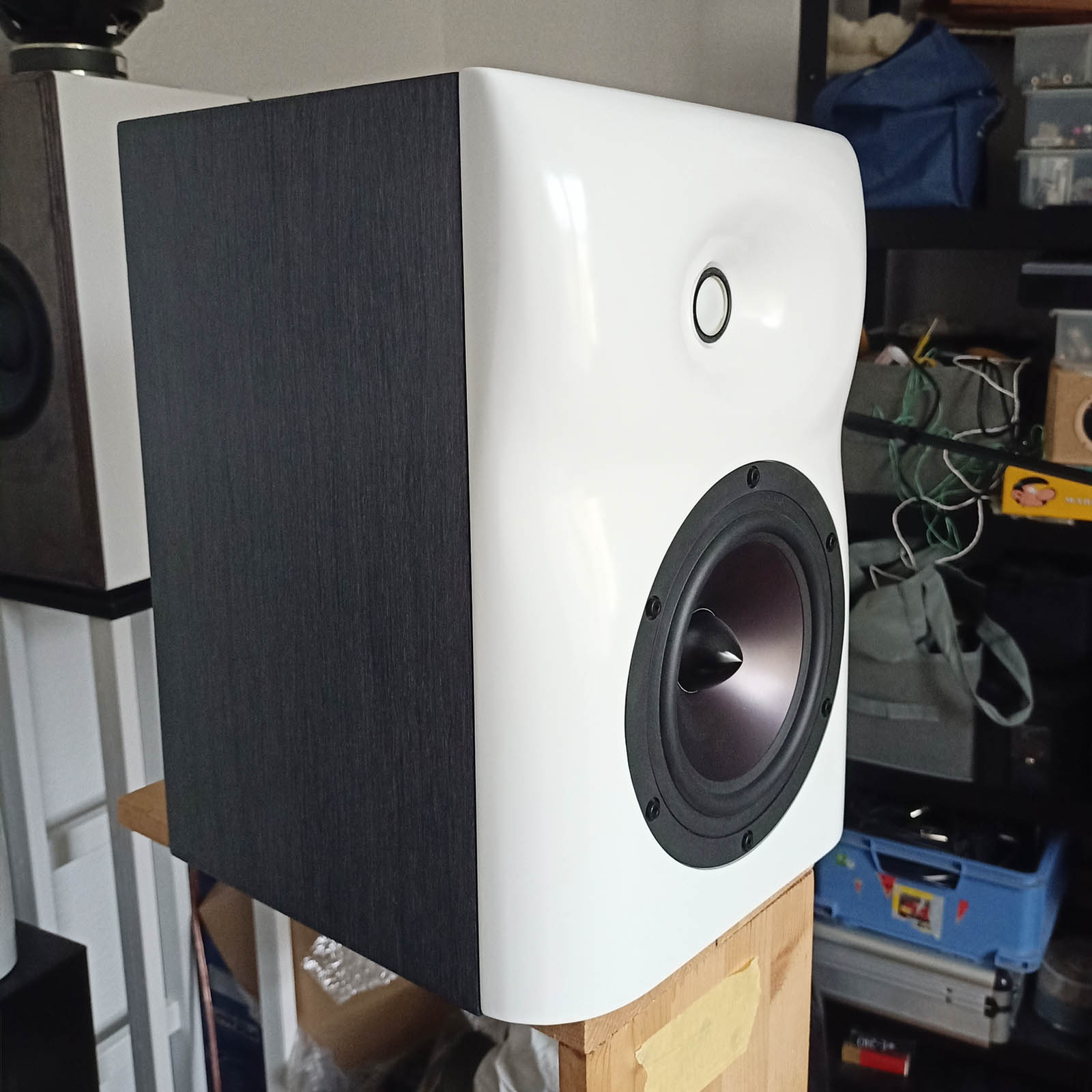

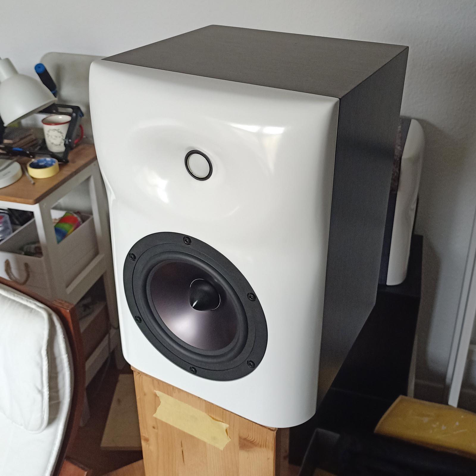

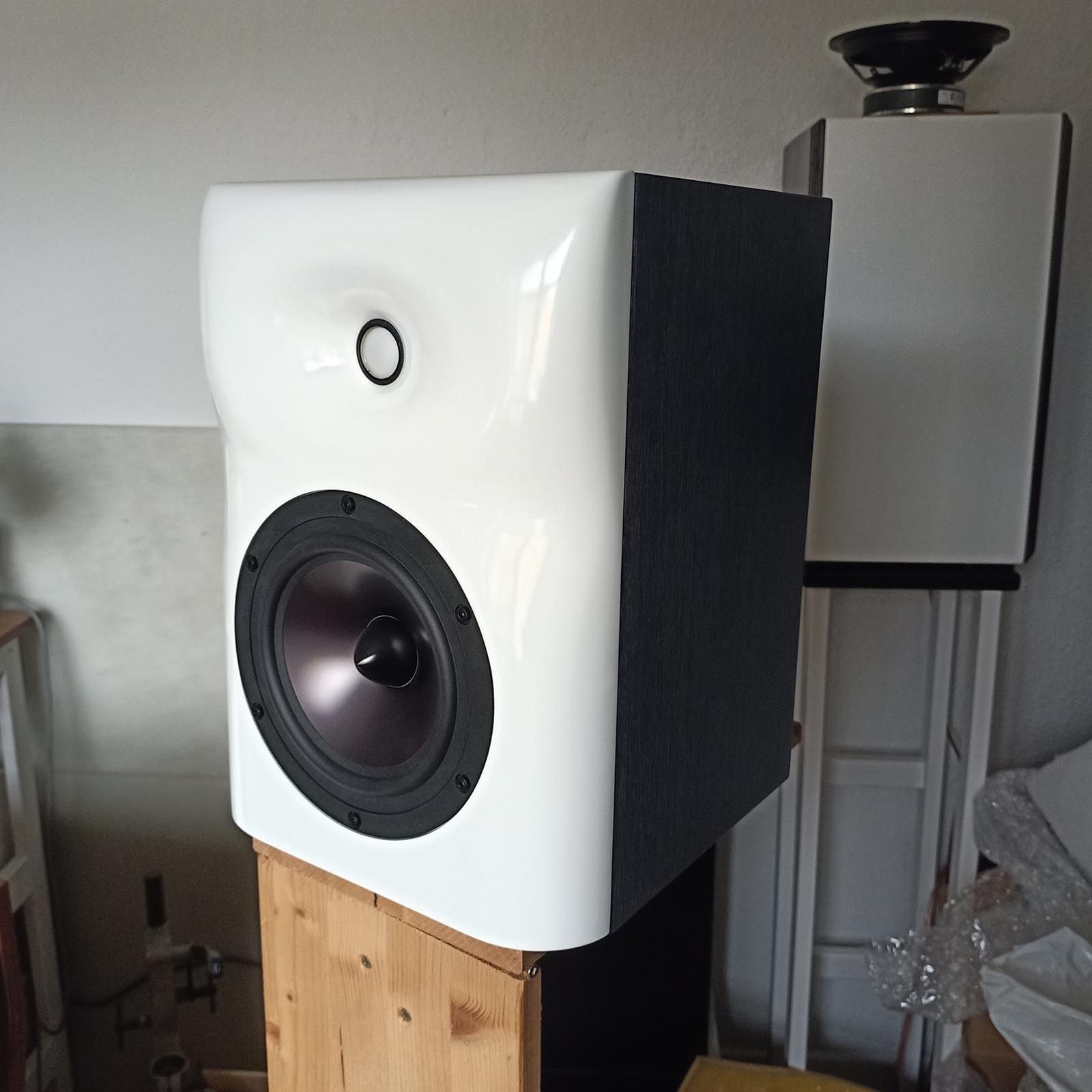

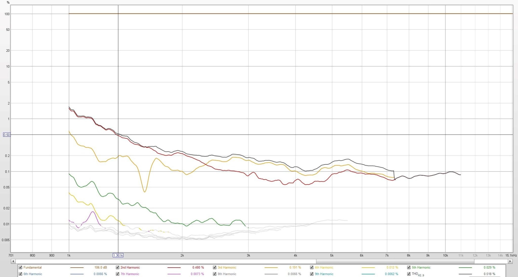

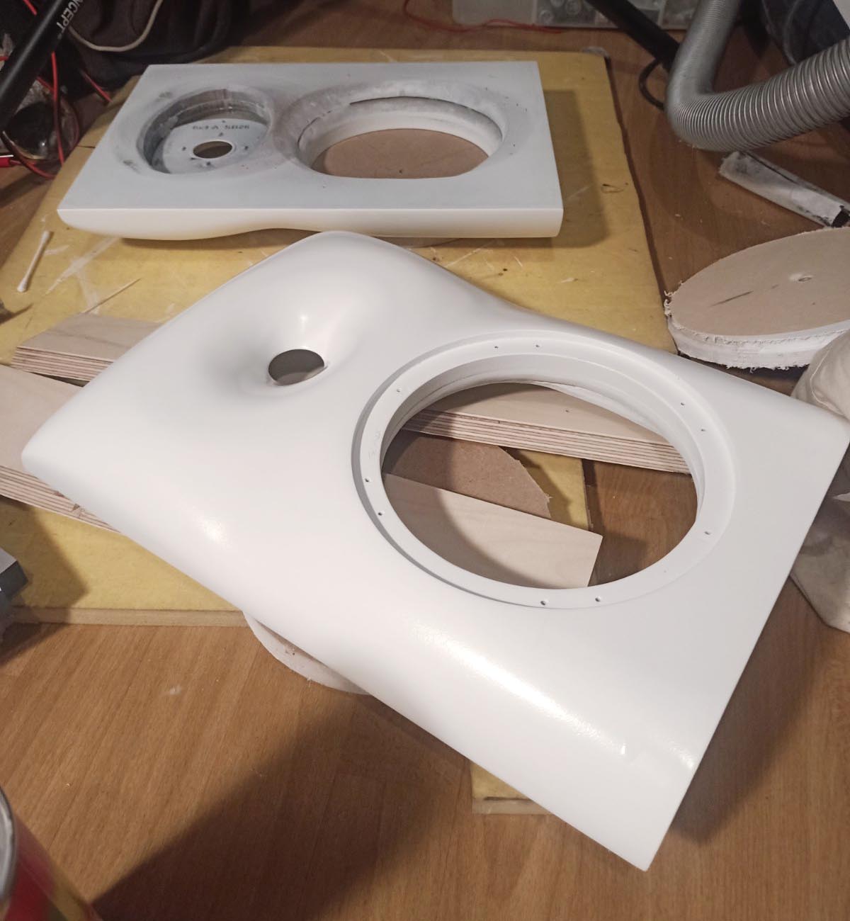

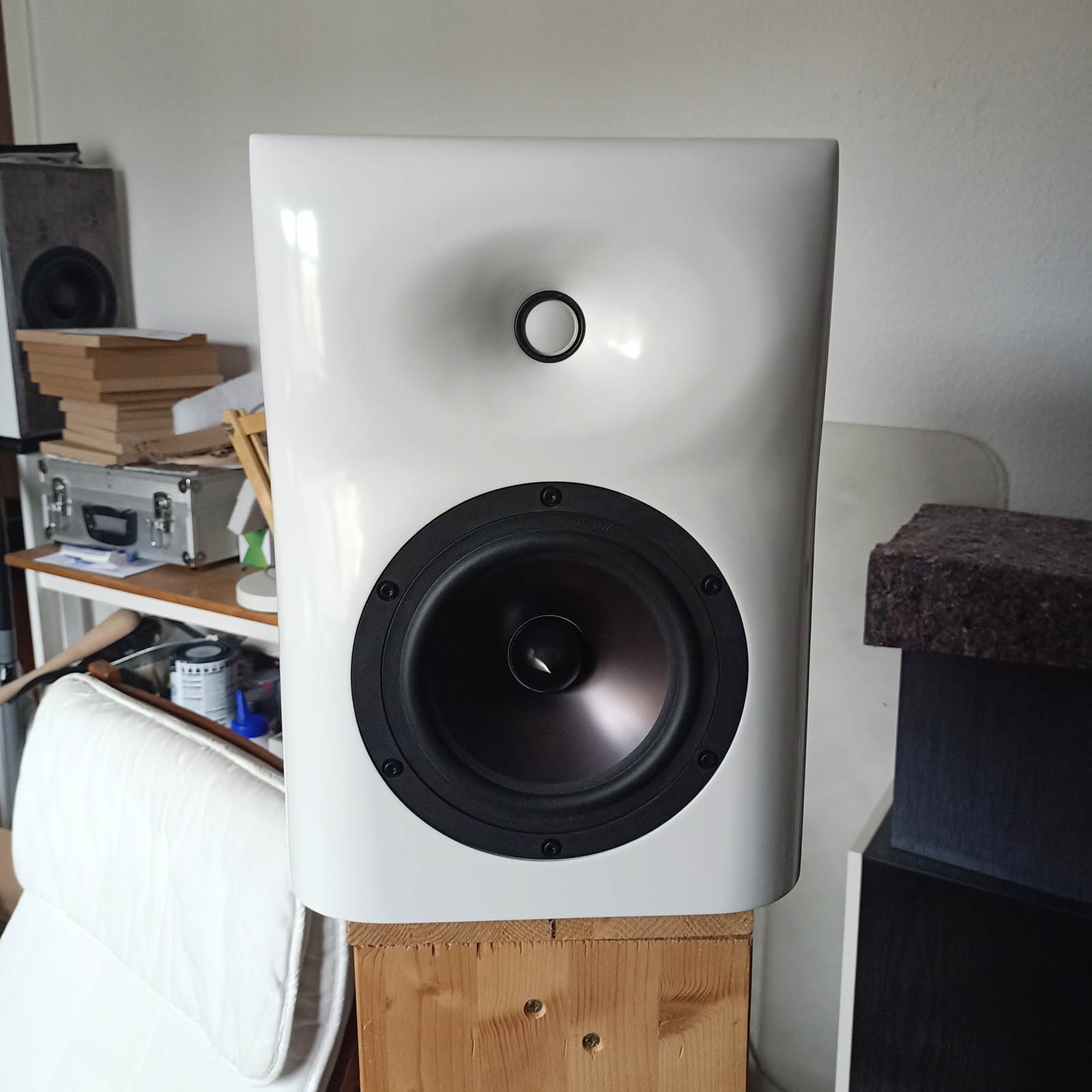

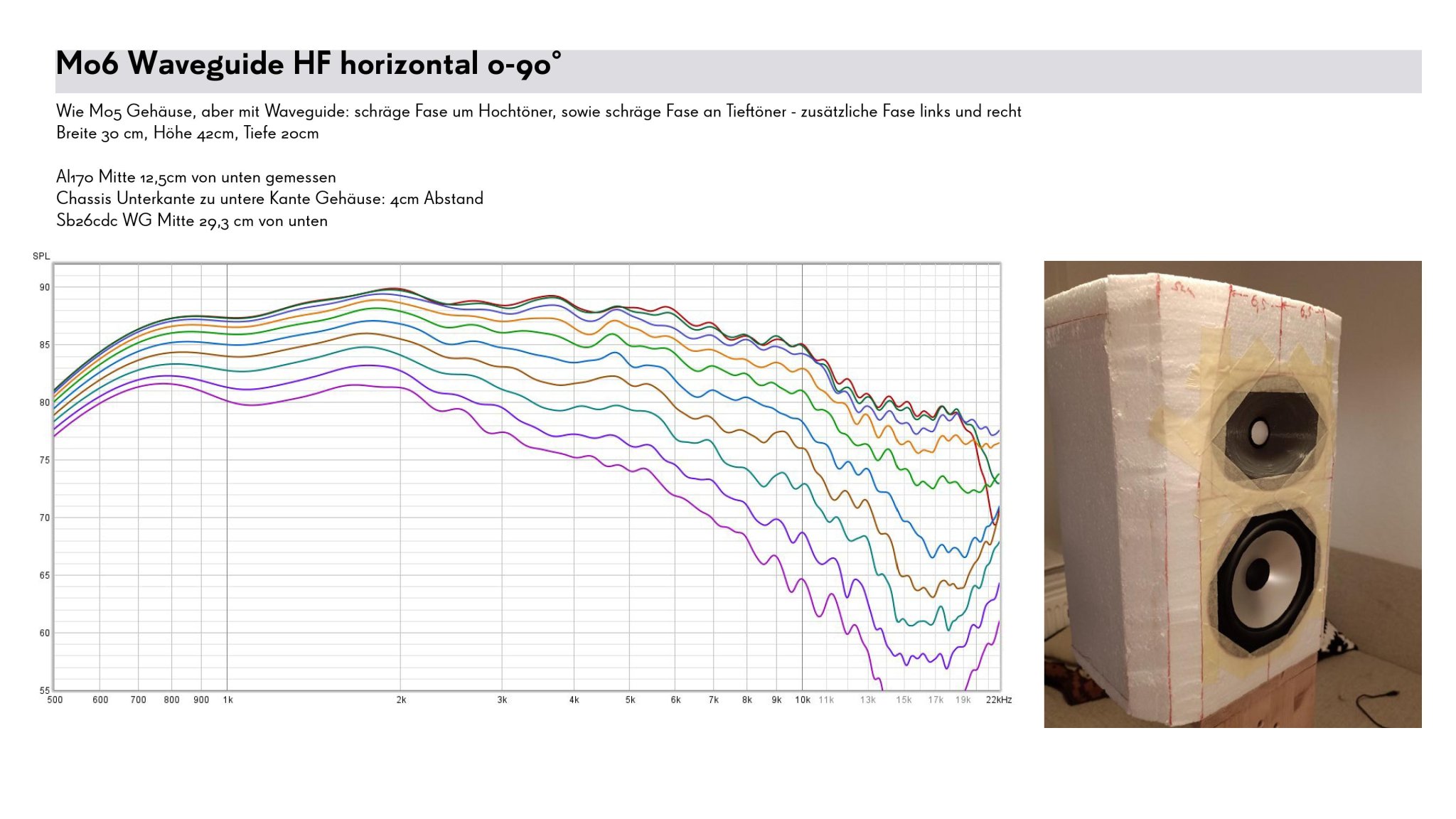

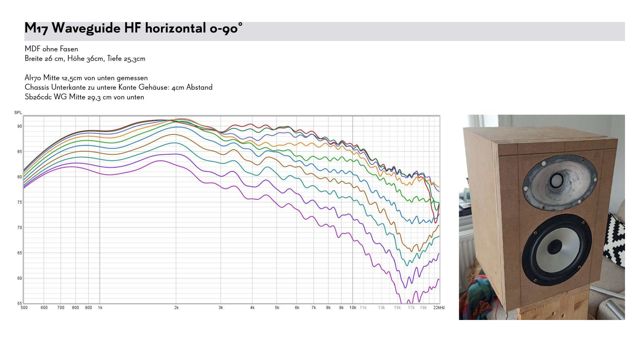

I built a closed two way speaker using his 6" waveguide for the SB26CDC tweeter together with the Dayton Audio RS180 Woofer. (In Listening room supported with DBA) The waveguide was printed in ABS and glued with expoxy into the baffle and then painted.

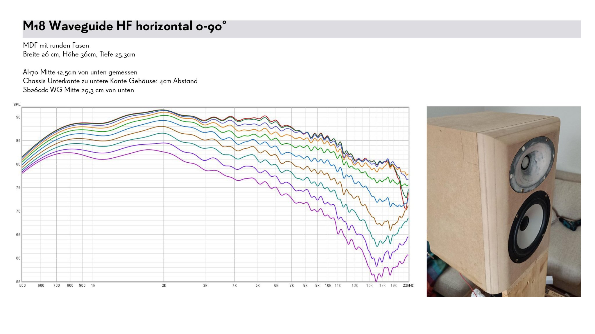

Attached are some pictures and measurements of prototypes.
- SB26CDC without waveguide/ SB26CDC with waveguide (Baffle 30cm x 42cm)
- SB26CDC with waveguide in rectangular baffle / SB26CDC with waveguide in rounded baffle. (Baffle 26cm x 36cm)
Measuring distance 1 meter Horizontal 0-90° degrees (gated)
(Measuring microphone not level calibrated during measurements).
Thanks again and keep up the great work.
Christoph from Germany

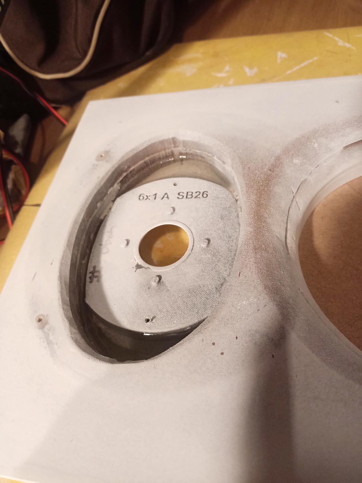

Ordered a pair of 5" WG for the SB26 a few days back and they arrived today.
The material I chose was MJF. The make and color looks good. I chose smooth finish, but still it's a little grainer than what I had expected. An image attached for reference - this is good enough to go, or need smoother for optimum performance?

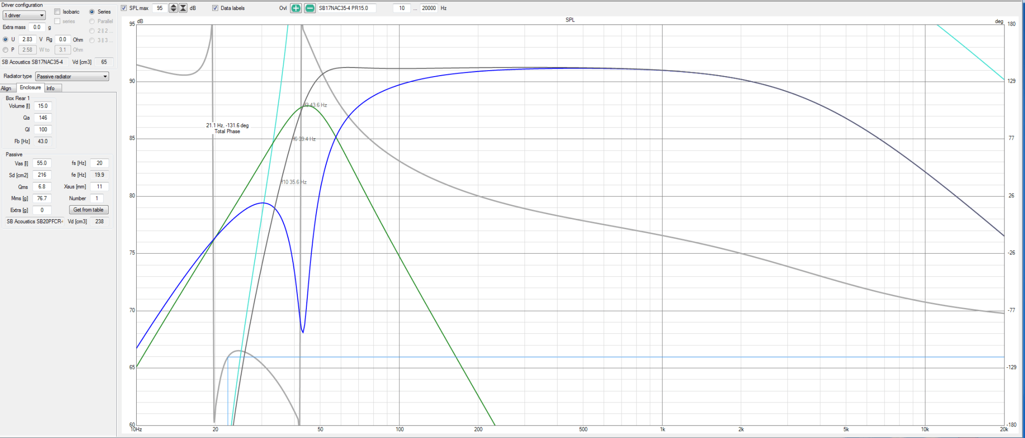

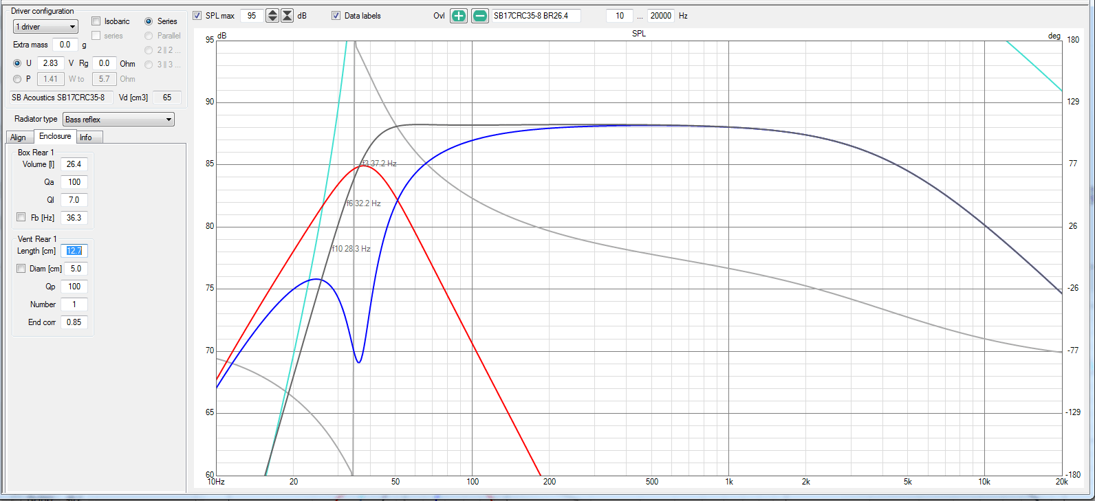

I am looking to build a speaker with the SB26CDC and your 6" waveguide along with either the SB17CAC 4 or 8 ohm.
To me it seems a trade off between larger box size with greater extension on the 8 ohm version vs. smaller box size, higher F3 and higher sensitivity for the 4 ohm version.
Yeah I guess if the deepest bass is a priority from a TM, and you won't use any subs, the 8 ohm might make the most sense. I'm going sealed, and accept that a TM is only going to have so much bass. And the music I listen to doesn't seem to need the deepest bass. I do have two subs I'm building too. Subjectively, these SBs sound like they dig very deep compared to most others I've compared them to.

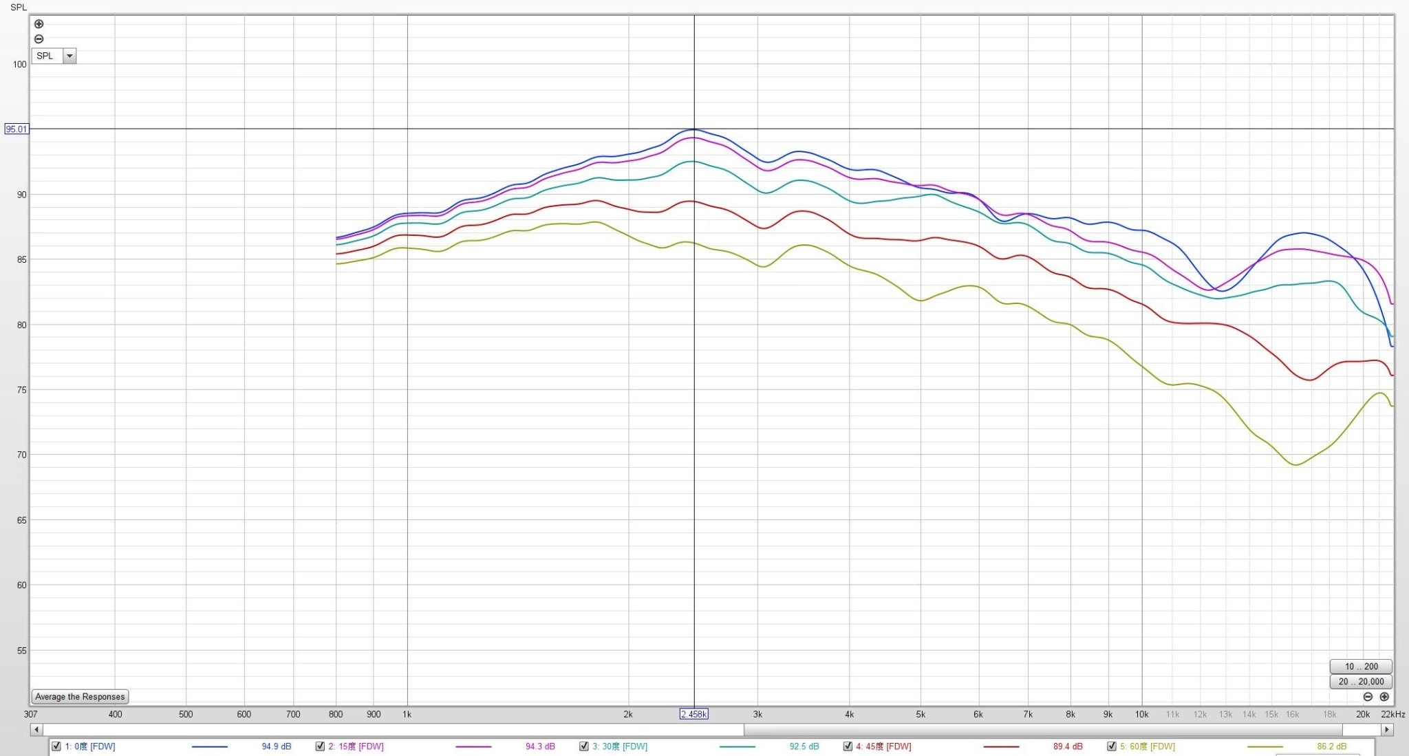

The depression getting better moving off axis is likely due to a phase shift between the tip and surround of the dome on axis. The solution is often to cover the tweeter surround half way.I tested the horizontal off-axis response. There is a depression at 13kHz on the axial frequency response curve. The rest feels good. Thanks to the author for his enthusiastic sharing!
View attachment 1162230View attachment 1162231

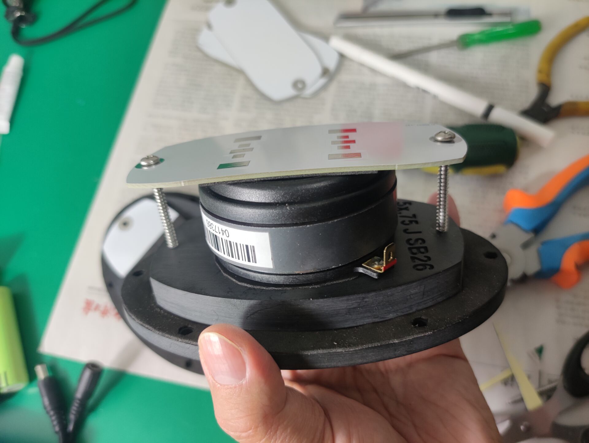

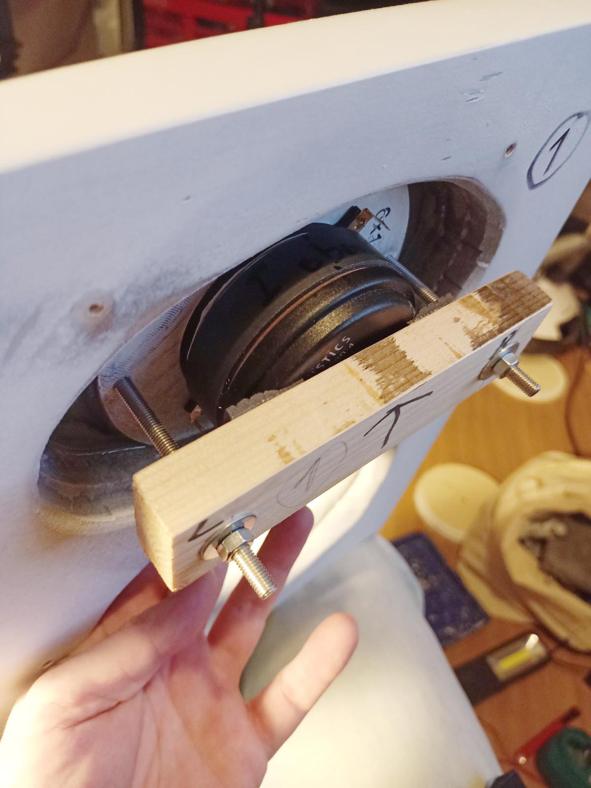

There shouldn't be a 5db dip at 13khz, so something else is wrong. Is the waveguide flush-mounted well? Did I see a gasket? Pull that off and remeasure.
The area from 5-7khz looks a little odd too. How is this mounted zergxia? Tape the edge of the waveguide and remeasure. If it is better, you're not flush or there is a gap between waveguide and baffle.
