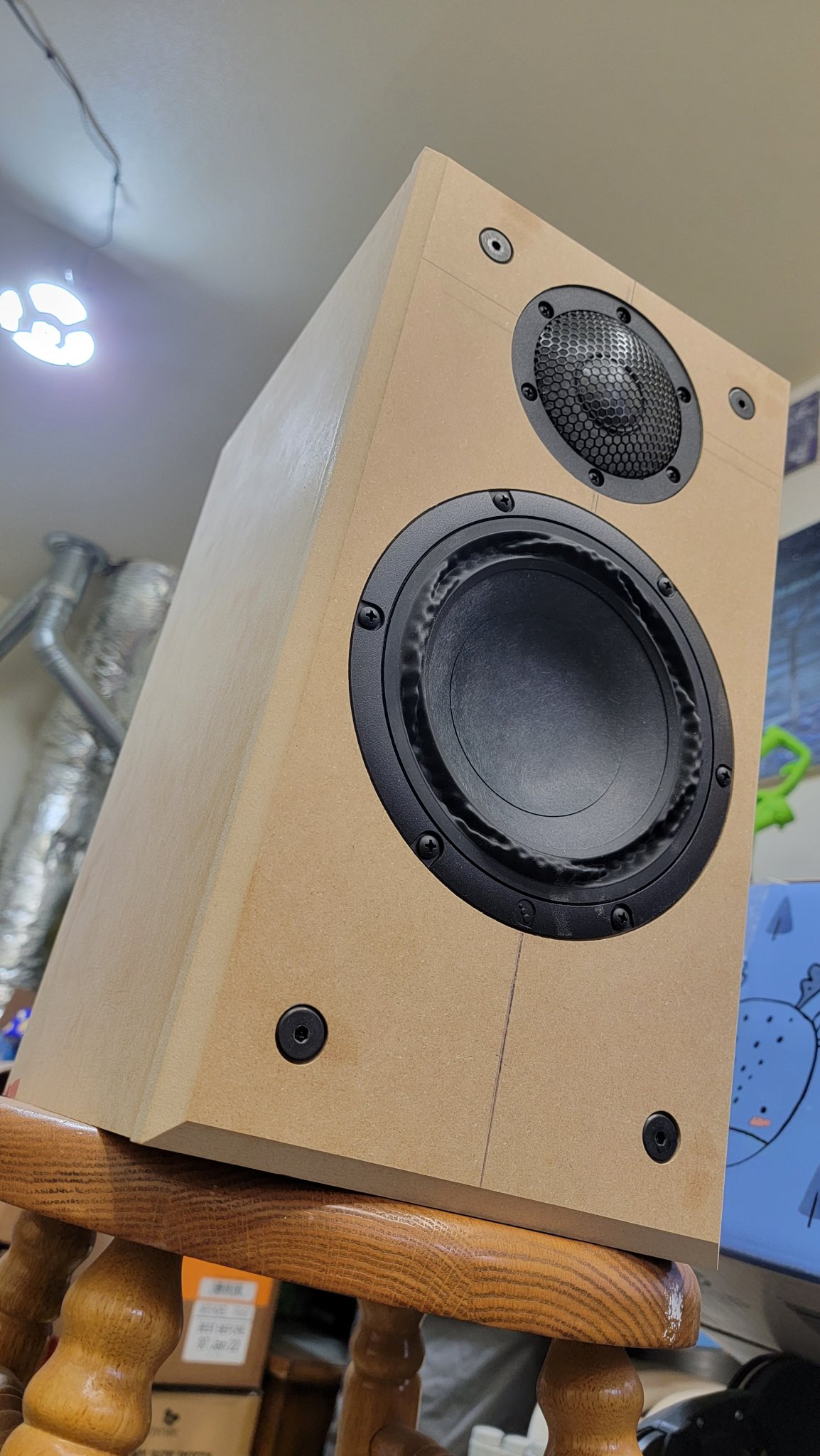

I'm building an active 2 way with a Purifi Ptt6.5X04 NFA01 and was going to use a stock T34b but came across the waveguides and got interested in constant directivity. I have several tweeters at my disposal..what would your choice be.. Bliesma T34b, Satori TW29R-B ring dome, SB21RDC ring dome..or I could buy an SB26ADC or something. I can fit a 6.5" waveguide max.
Probably like the D3004/6600. They are all the same: http://www.troelsgravesen.dk/ScanSpeak-waveguides.htmWhat does it look like when you take the faceplate off?
Controlled directivity* , and if you have T34B's, the circular 6.5 is looking REAL f'n nice.I'm building an active 2 way with a Purifi Ptt6.5X04 NFA01 and was going to use a stock T34b but came across the waveguides and got interested in constant directivity. I have several tweeters at my disposal..what would your choice be.. Bliesma T34b, Satori TW29R-B ring dome, SB21RDC ring dome..or I could buy an SB26ADC or something. I can fit a 6.5" waveguide max.
I would do circular but due to my removable baffles, the bolts I'm using occupy the same space that the woofer and waveguide would. That makes 6.5" elliptical required. I want to do the t34b honestly, but am slightly concerned about having beryllium exposed or how I would attach the grill to a waveguide, especially an elliptical one.

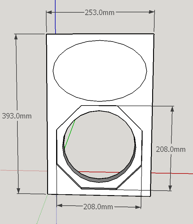

Has anyone made any of these waveguides into a CNC baffle? I want to use the 8" Waveguide for the SB26ADC with a Faital Pro 8PR200 woofer as seen in the picture below. I can 3D print the waveguide using an online service such as imaterialise, but it's looking around £80 per waveguide. How would I go about integrating the waveguide into a baffle to create a CNC file for the front baffle? I see the waveguide is 1.59" deep so I assume this would require a 1.59" thick baffle for CNC services? Thanks guys.
