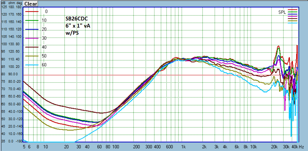

Erin just sent me the Klippel data of the prototype box using the MW16TX and T25B I posted above (and also SB17CAC and SB26CDC version). ABEC modeling paid off I think. Below are the plots of the individual drivers, followed by some reference speakers from Erin's website. I think the final speakers will measure as good as anything below. Crossover integration should be easier than anything I've done prior due to the waveguide, so minimal worries there.

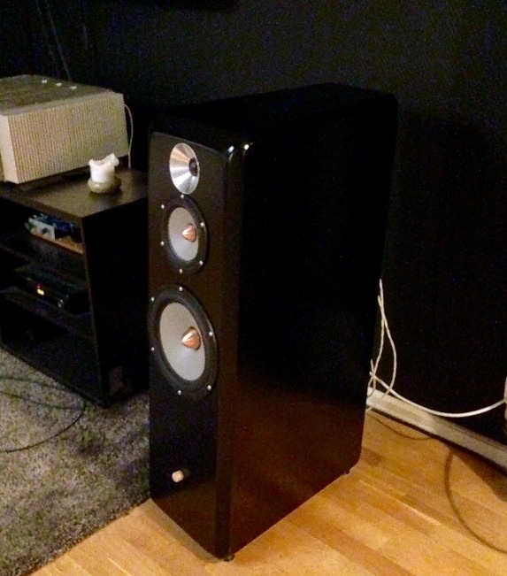

Good evening, here is what I made for my Scan Speak 6600. Did it 10 years ago, had no calculation/simulation or something to know how to do it.
I did it to get the all the elements in a vertical line. It work good, but never measure it.

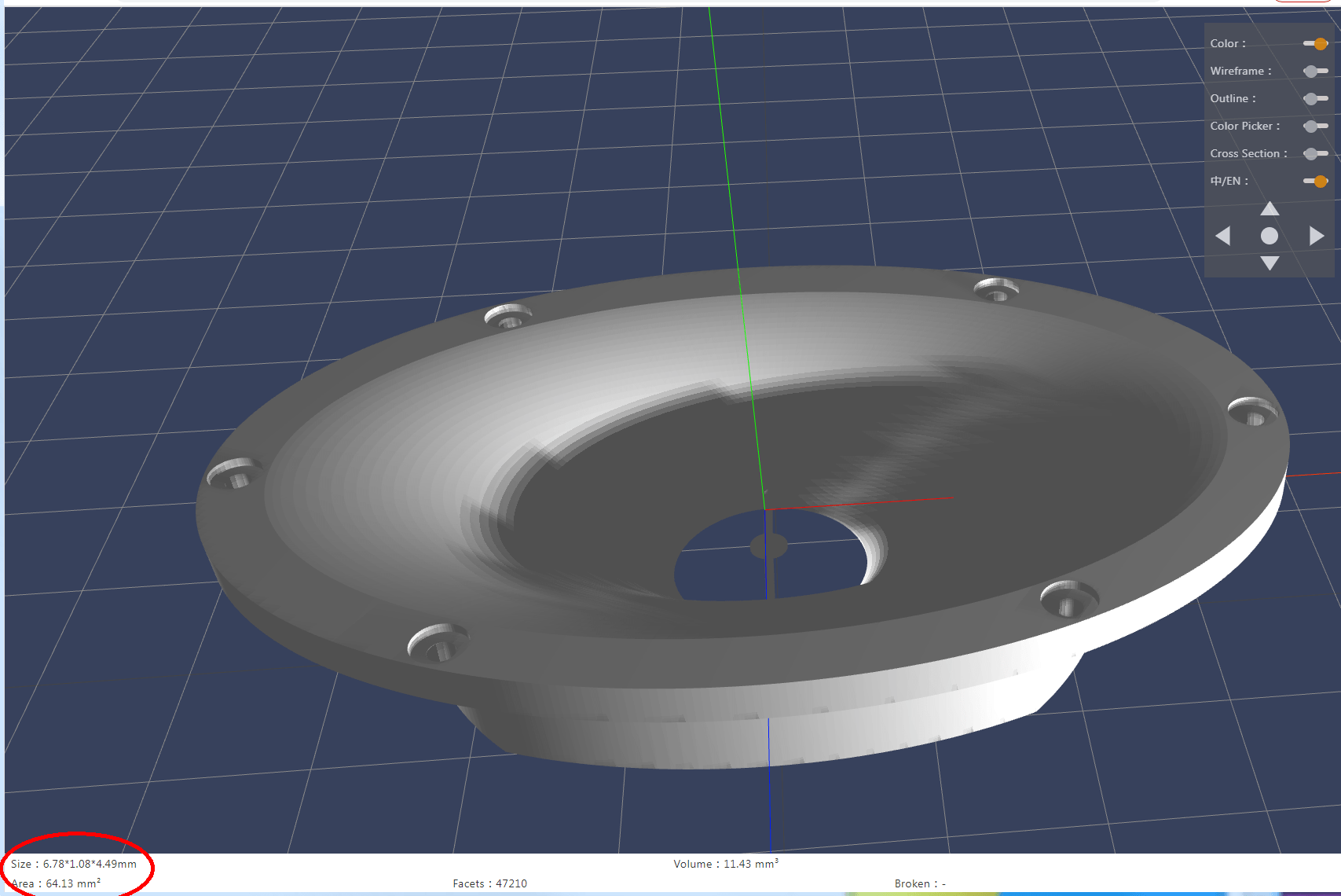

At my place have services mostly doing PLA - any major drawbacks for that in this application?
PLA being Fused filament has that ridged look to the print without further finishing. Whether that matters is in the eye of the beholder. Sand paper, filler and spray paint can fix that problem with some elbow grease. It also solves PLA's other drawback that it does not like UV and will degrade more quickly if exposed to sunlight.

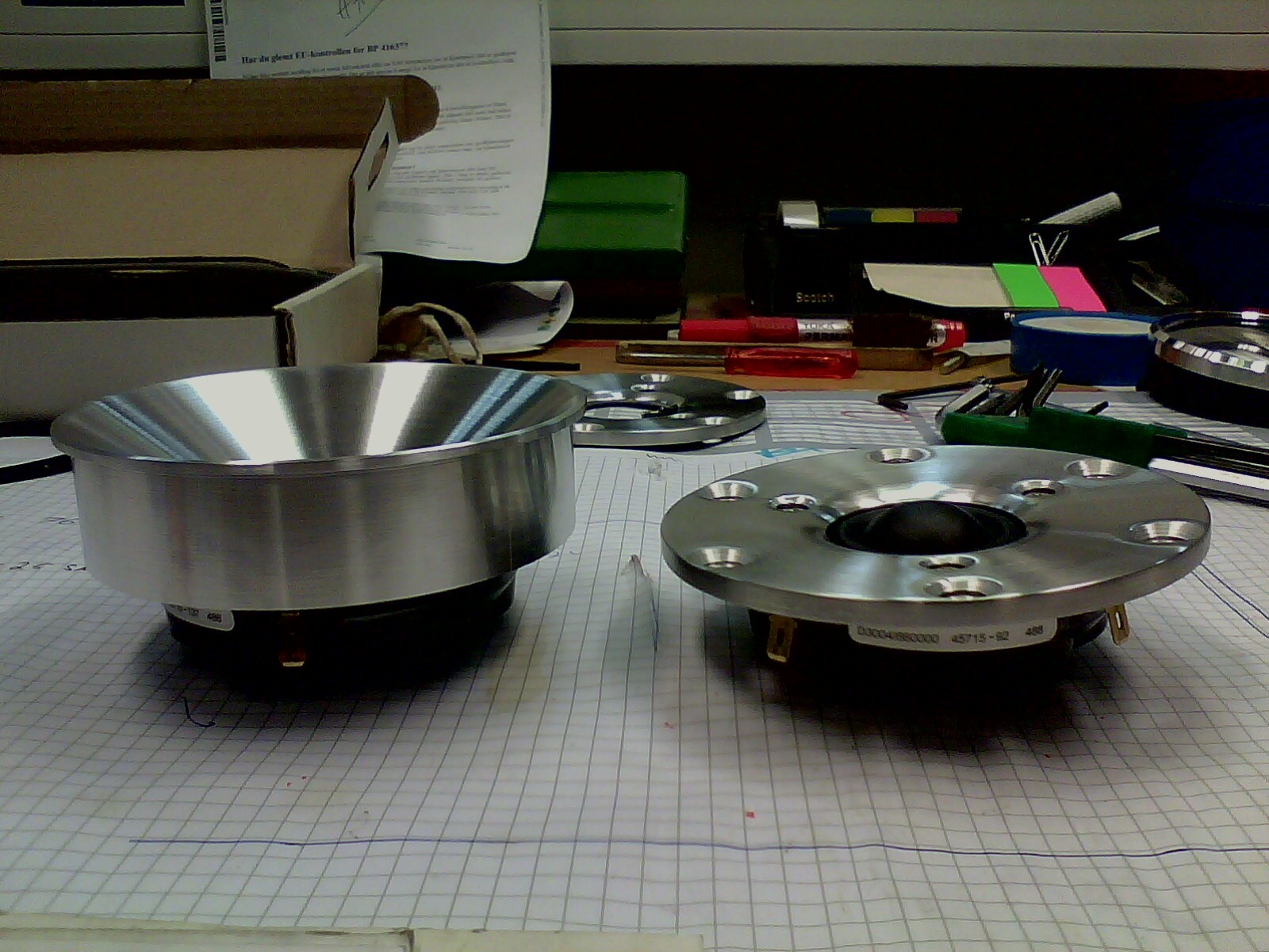

Here are the newest designs for this recent batch of tweeters I've been working on. I haven't done any deep comparisons yet, so I have no commentary other than going to a bigger phase shield on the Satori really straightened out the 0 and 10 degree responses. After I cut the phase shield off, I tried it on the Scanspeak 6640 by using putty to attach it, and there was a similar benefit. I'll need to print a waveguide with the bigger phase shield to verify performance.
