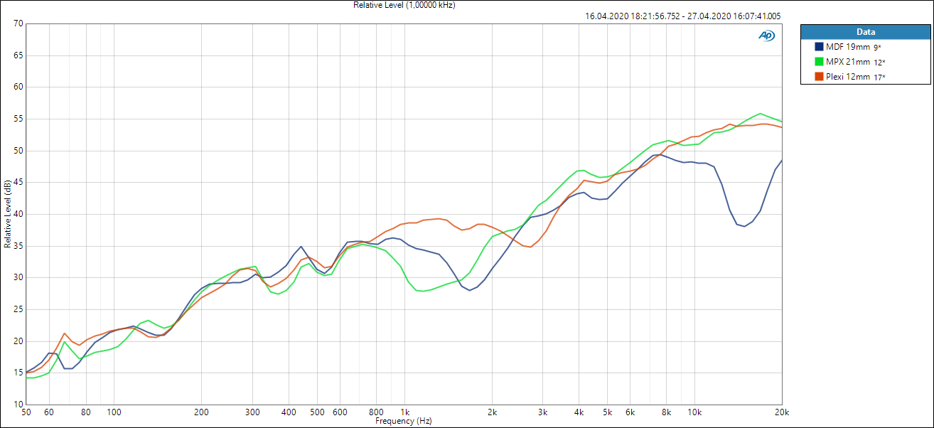

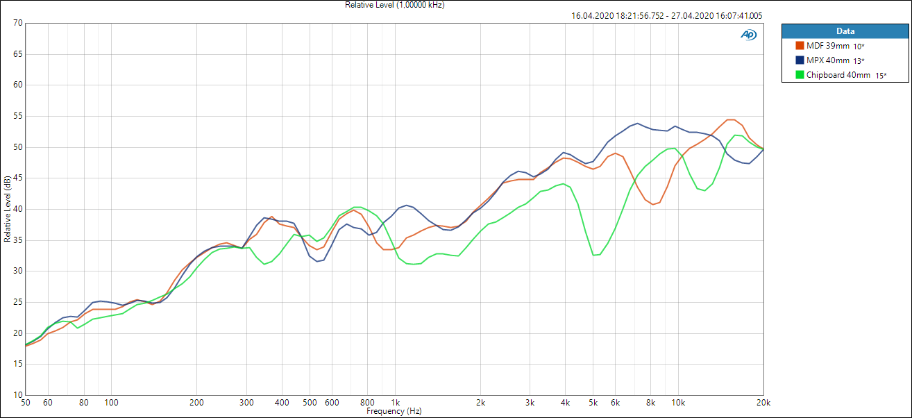

density number is not usefull without the damping one (internal losses) ; stifness also can be reached without always increasing density. It is a layout trade off. One has to look a little more around Young modulus that works or proceed by try & error indeed with tests.
I think I postet this already somewhere ... material comparisons of sound dampening over frequency.
You need the stiffness of the material and the weight to roughly determine the behaviour. With the Chipboard there is going on some additional stuff, that's pretty rare. 40mm wood is compareable, small differences come from different stiffness (MPX vs MDF).
12mm Acryl glass has about the same weight as 20mm wood - but is less stiff -> coincidence frequency is higher. 2 Layers of 10 and 12mm Plexi would be a pretty good sandwich.
