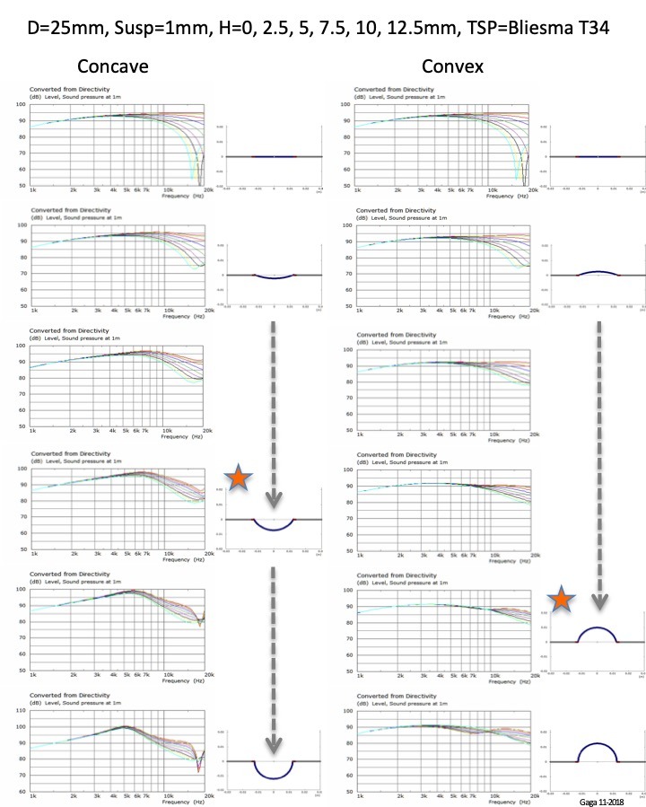

Just one example of a simulation series I did on the impact of dome shape and height on the directivity on concave and convex tweeter domes:
The image is showing both, concave and convex tweeter domes, starting form a flat membrane and then going in steps of 2.5, 5, 7.5, 10 and 12.5 mm high and deep, respectively.
Background at that time (2108) was to understand the very nice directivity of the Biesma Tweeter even in the high frequency range. Bliesma just hit the sweet spot with it's dome height (right side of th eimage, marked by a star). Pleaase note the nice (wide) directivity of concave domes in the high freuency range (accuton and the like), left side of the image.
Said that, tweeter dome geometry and directivity has to be considered when combining with a waveguide, i.e. with respect to the throat geometry when designing a waveguide.
I'll come back with simulations on that, if I'm successful finding them on my computer and if still there....

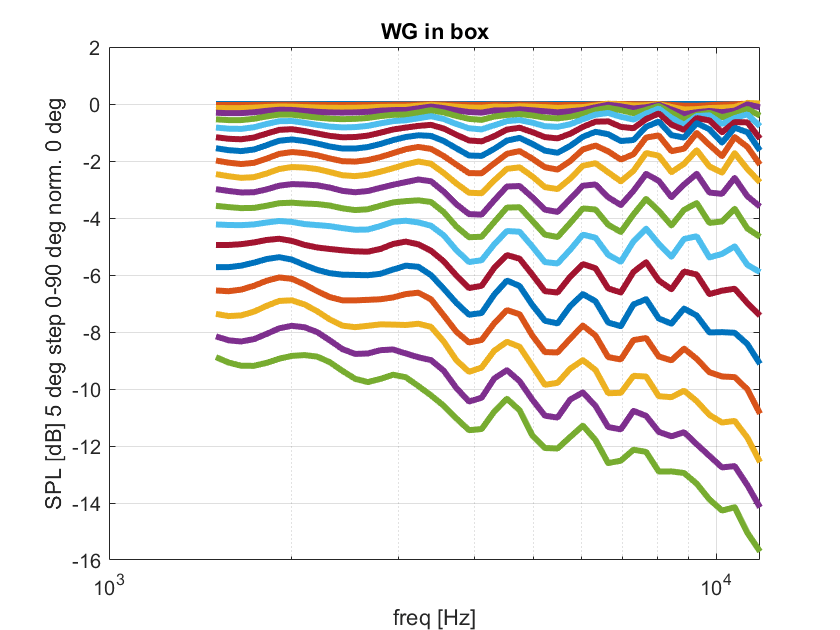

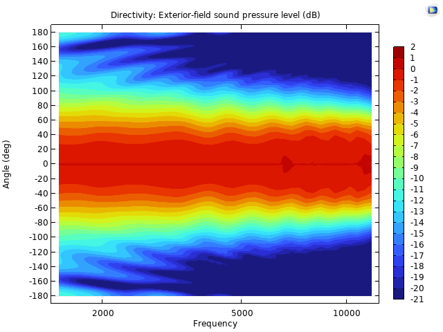

this is my best WG design so far. its optimised to work in a particular box. Here simulated in full 3D in comsol with the woofer included on the baffle (woofer cone cavity causes ripples). it’s an acoustics only simulation so effects from the mechanical domain are not included.
